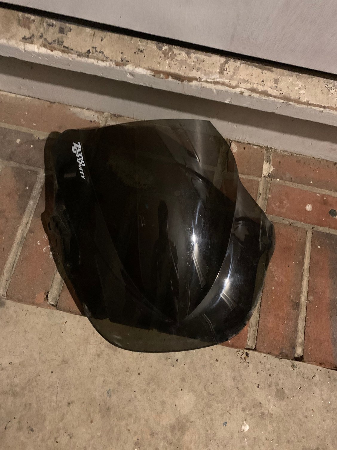

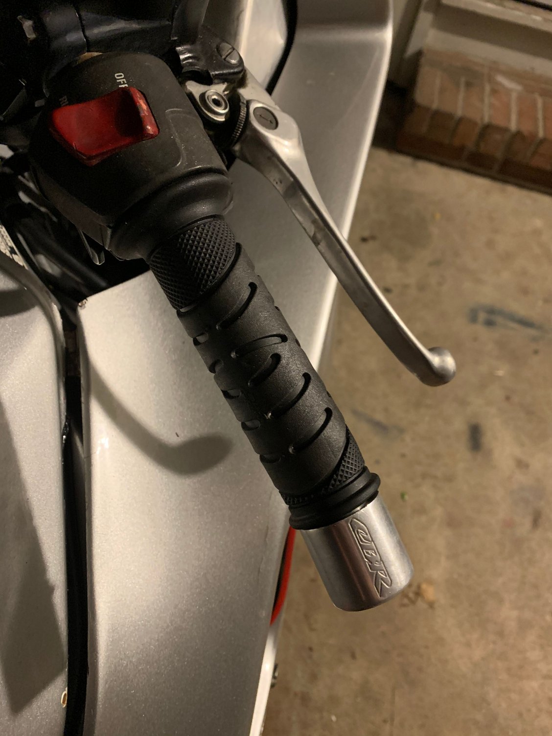

After tearing her down and looking her over, there’s lots to be done! Needs a new tensioner, there’s chatter in the high revs. Switching to a manual one. Ordered new clutch cable and cable adjuster. Replaced the worn out discolored grips. Replaced the broken windscreen. The PO had it lowered about 6 inches front and back, and had the suspension set to full stiff everywhere. It was terrible. Raised her back up and got the suspension setup oh so nicely. Could use some new pads and rotors. I flushed the brake system as well. There’s no fuel pump on it. Just gravity fed ATM. Causes a slight sputter only when you barely roll the throttle. Other than that it doesn’t really affect it that much. Still going to replace it.
