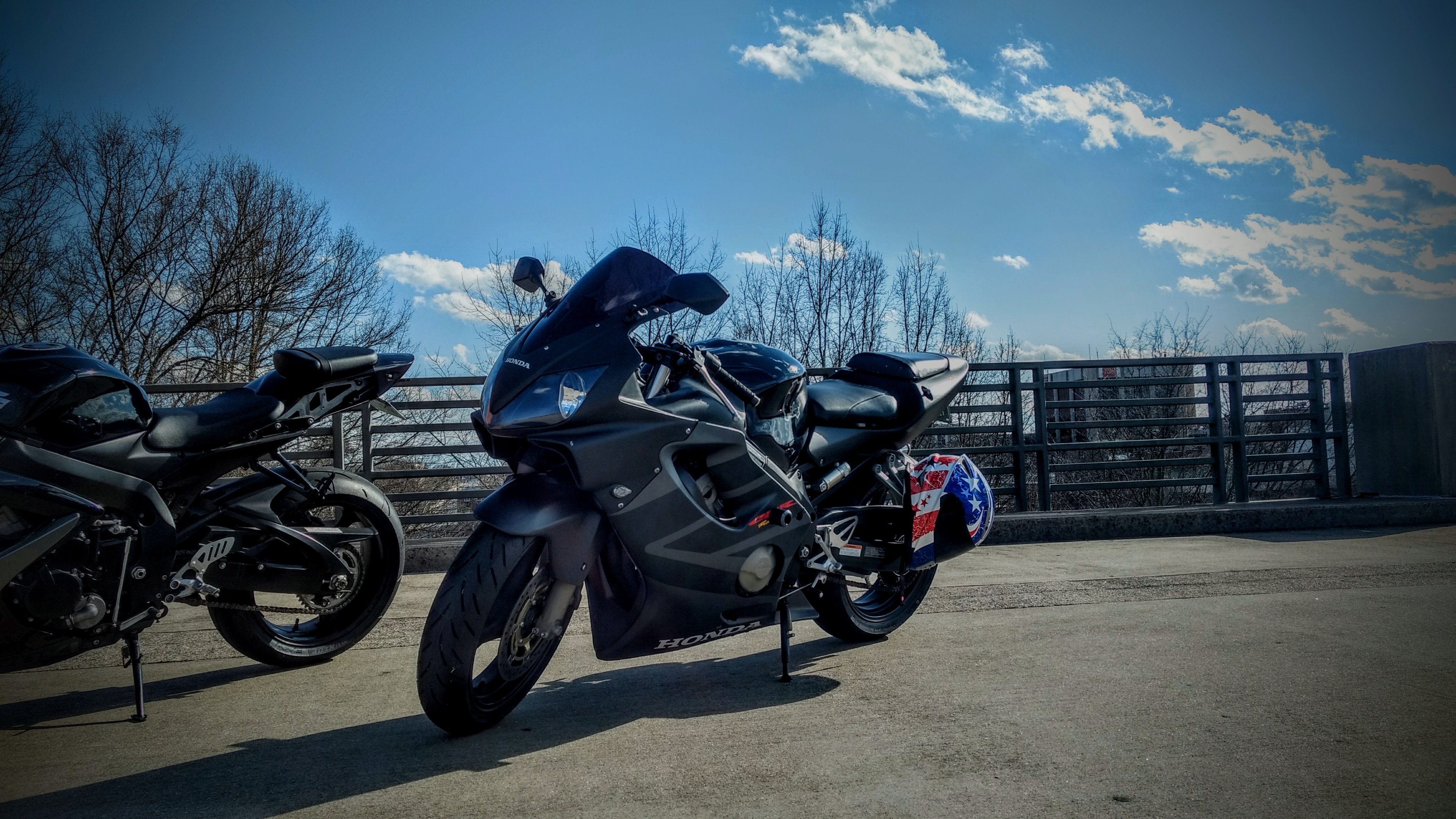

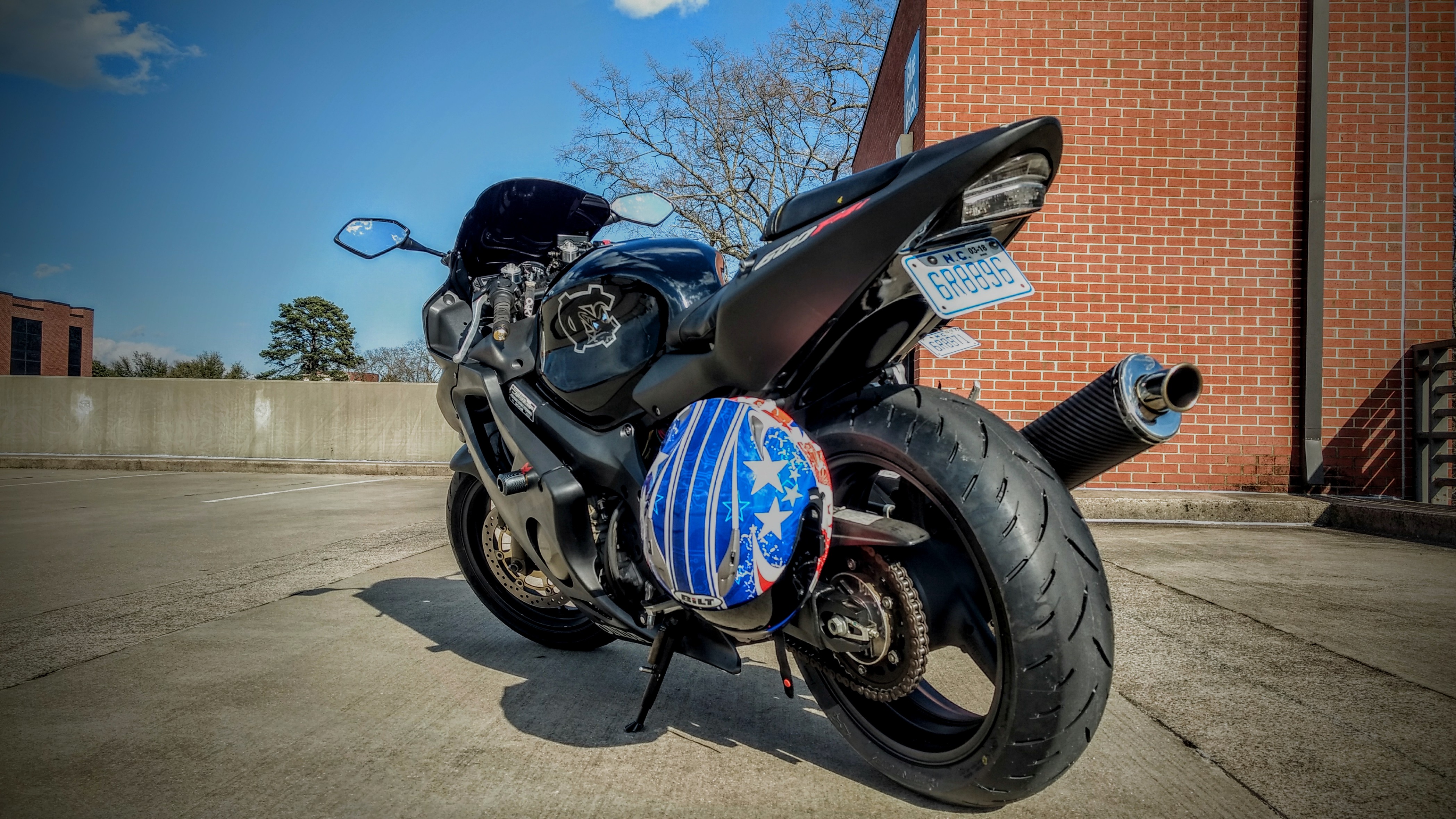

I have lowered it one inch to fit me a little better, added an adjustable kickstand, black mirrors, and black windscreen. And I also just had some Dunlop tires put on.
Attached Thumbnails New bike owner W/PROBLEM-img_20170318_170415255_hdr-2.jpg   New bike owner W/PROBLEM-img_20170318_170049646_hdr-2.jpg
