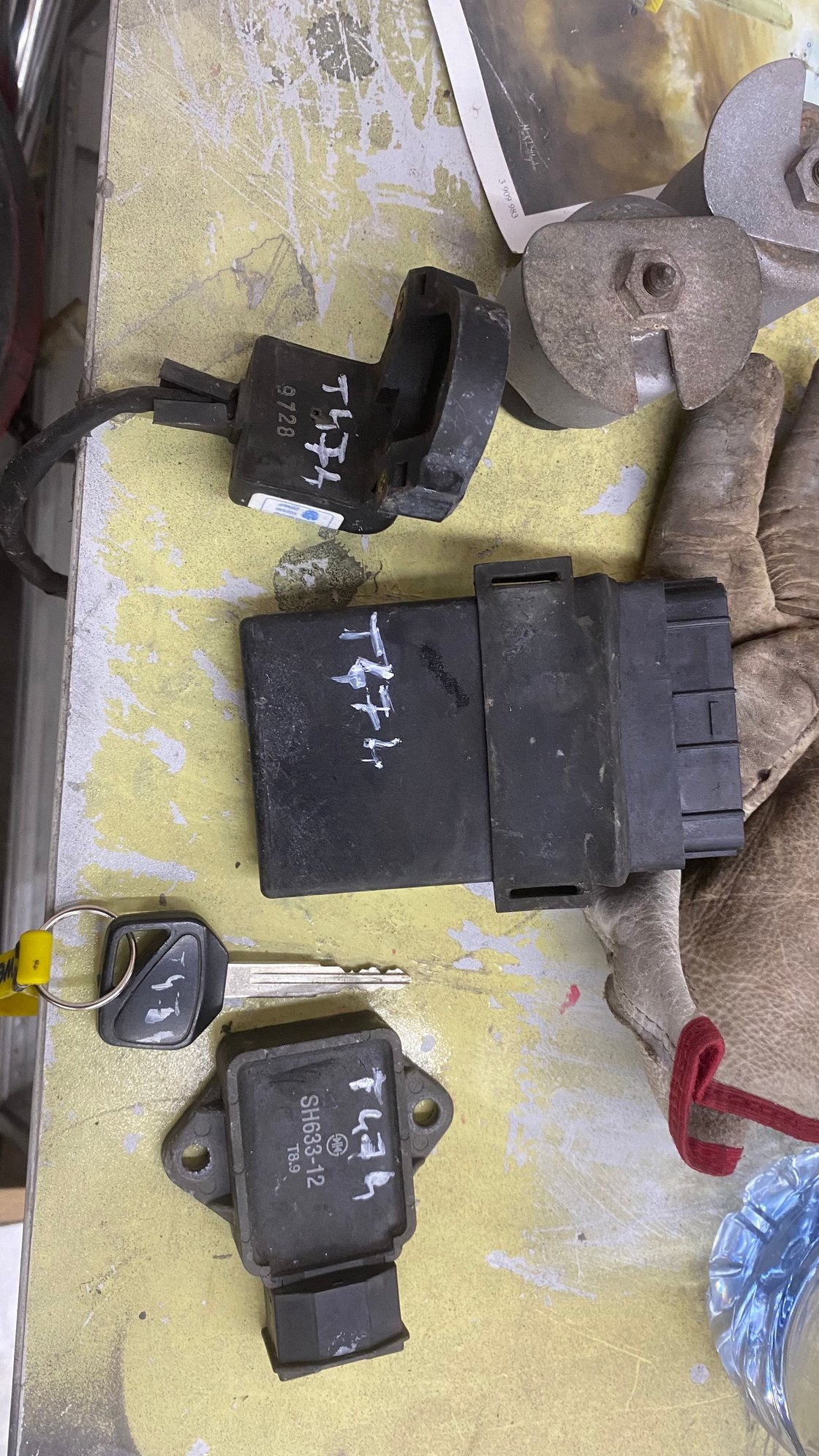

It all looks doable esp with salvage parts, the main problem is the HISS key / ECU matching as a matched set could cost c. £500 as per this link:
https://www.ebay.co.uk/itm/185652850...Bk9SR7Tr8LCcYQ
I will have a look around to see if they can be re-programmed.
R/R is the Rectifier / Regulator (takes the AC voltage from the stator and converts it to DC to power the bike charge the battery etc) the two smaller black boxes with two mounting holes in your second pic.

Oh ok that would be a great help Iv looked at these bits they all got the same number as the key I think someone has tried to fix it.
