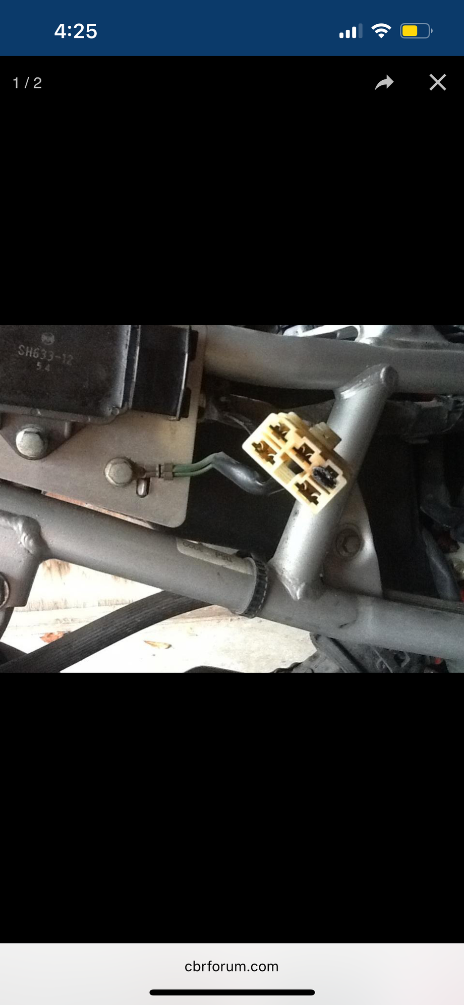

i was riding the bike when it completely lost full power like it was lifeless. i pulled into the gas station turned the key on and off i put it to the on position into neautral also and when i turned the key my n light didn’t come on nor did my side stand lights. i’ve checked my common fuses located up by the throttle. i’ve replaced the regulator the 5 prong on the rear right side and i still didn’t get anything as i thought it was bc of that as one of the prongs were burnt up but i replaced it and the box and it didn’t do anything. my battery got juice still i’ve hooked it up to a tester and i’ve tested it with a wire and battery taster just no power to lights horn signals starter. please help! i’ve tried everything i know. i’ve added a picture of what i mean by plug being burnt if that helps! thank you for any help you guys can give or tips to do next

Stop throwing parts at the problem and think...
if the lights don't work with the engine off and a good battery - the problem is not the power generation system - the problem is between the battery and the lights.
Start there - you most likely have a bad fuse (you did check the main fuse on the starter relay yes?), or your battery is not as good as you think it is, or you installed it backwards...
