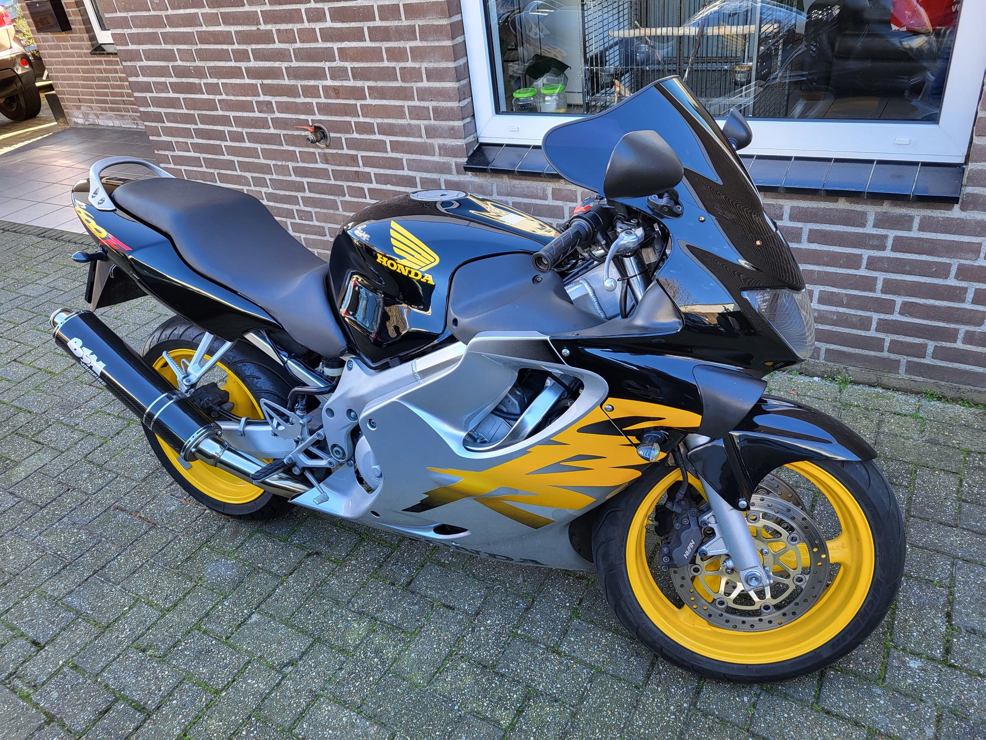

Hi guys. I just wanted to introduce myself quickly; my name is Florian , 31 years old and I live near Amsterdam. I own a 99' CBR 600F4 and it is an absolute blast to ride. I got it in February after finally acquiring my license back in November (I've been wanting to do this for ages).

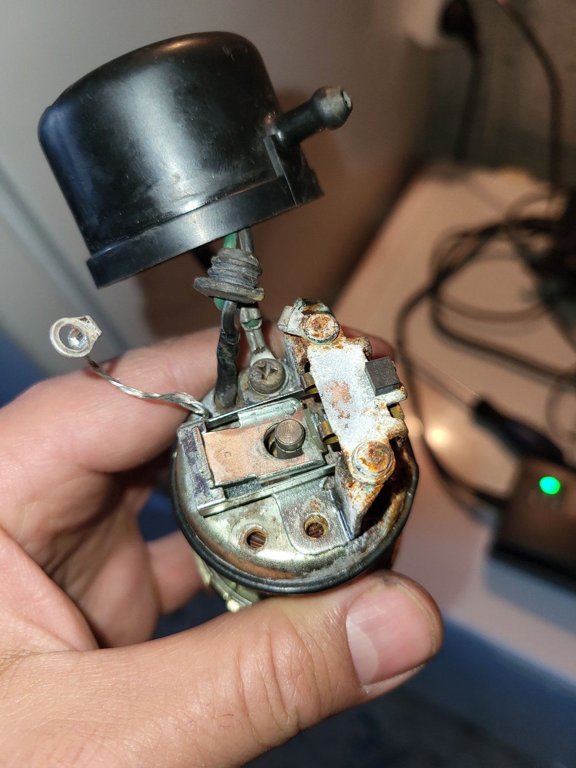

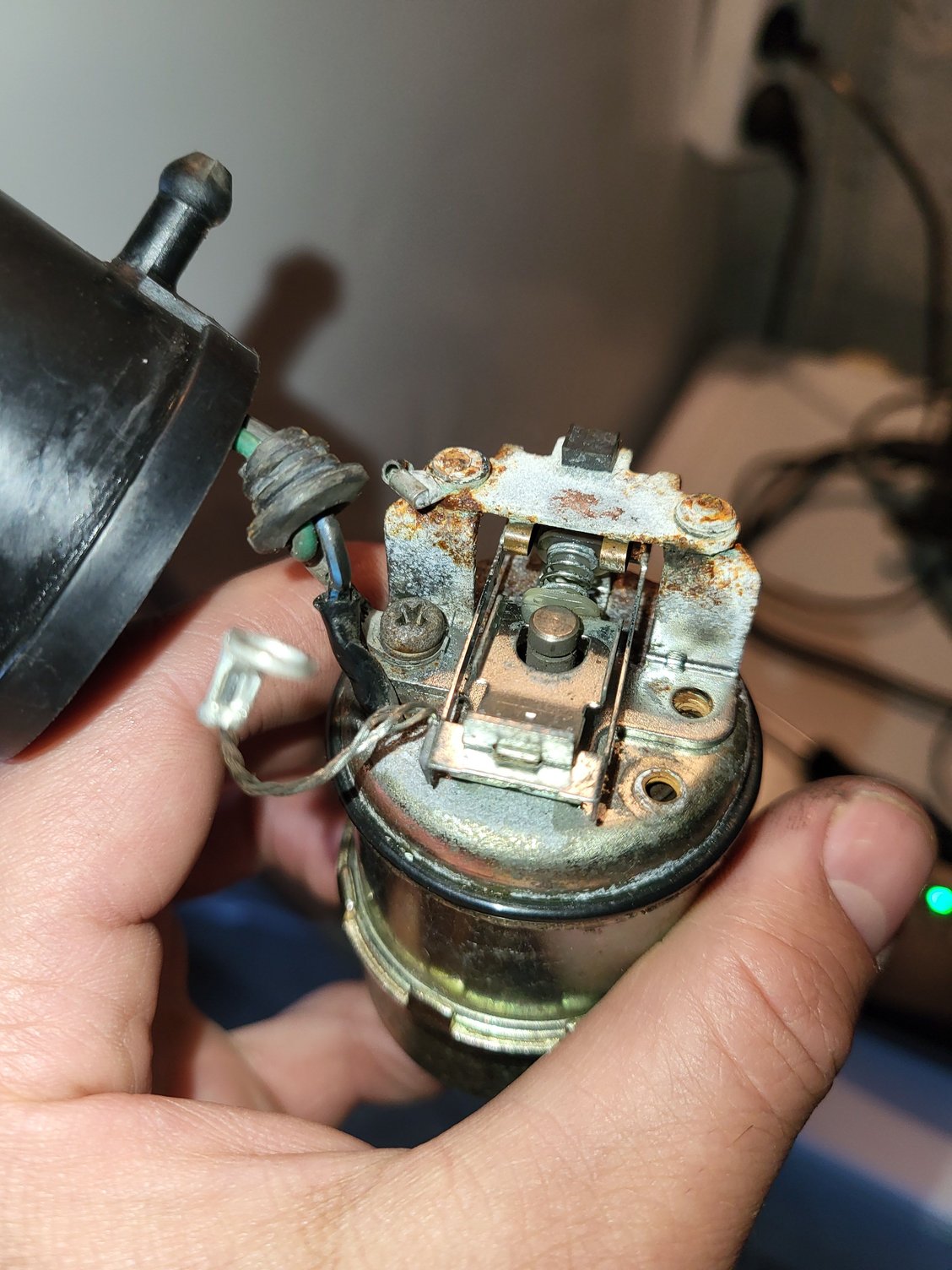

I checked the fuel lines and the fuel pump and noticed that the pump wouldnt prime correctly, it did something but it just sounded like it farted. I took of the protection cap and found the control switch completely eroded. I got a new control switch from the shop I called earlier, these guys where extremely helpful, showed me how to install the new thing and all.

Here are some pics of my bike and the corroded fuelpump controller!

very nice bike! Don't see many good F4 in U.S. because most of them have been destroyed stunting!
Good job on repairing pump! May want to investigate replacing mechanical controller with solid-state electronic one next. Hopefully before this one fails. Much more reliable than original mechanical type.

Thanks for the tip! At first I wanted to replace the entire pump but the bike shop mentioned they had one of these mechanical switches, I got it for 30 euros so that saved me a of money.
