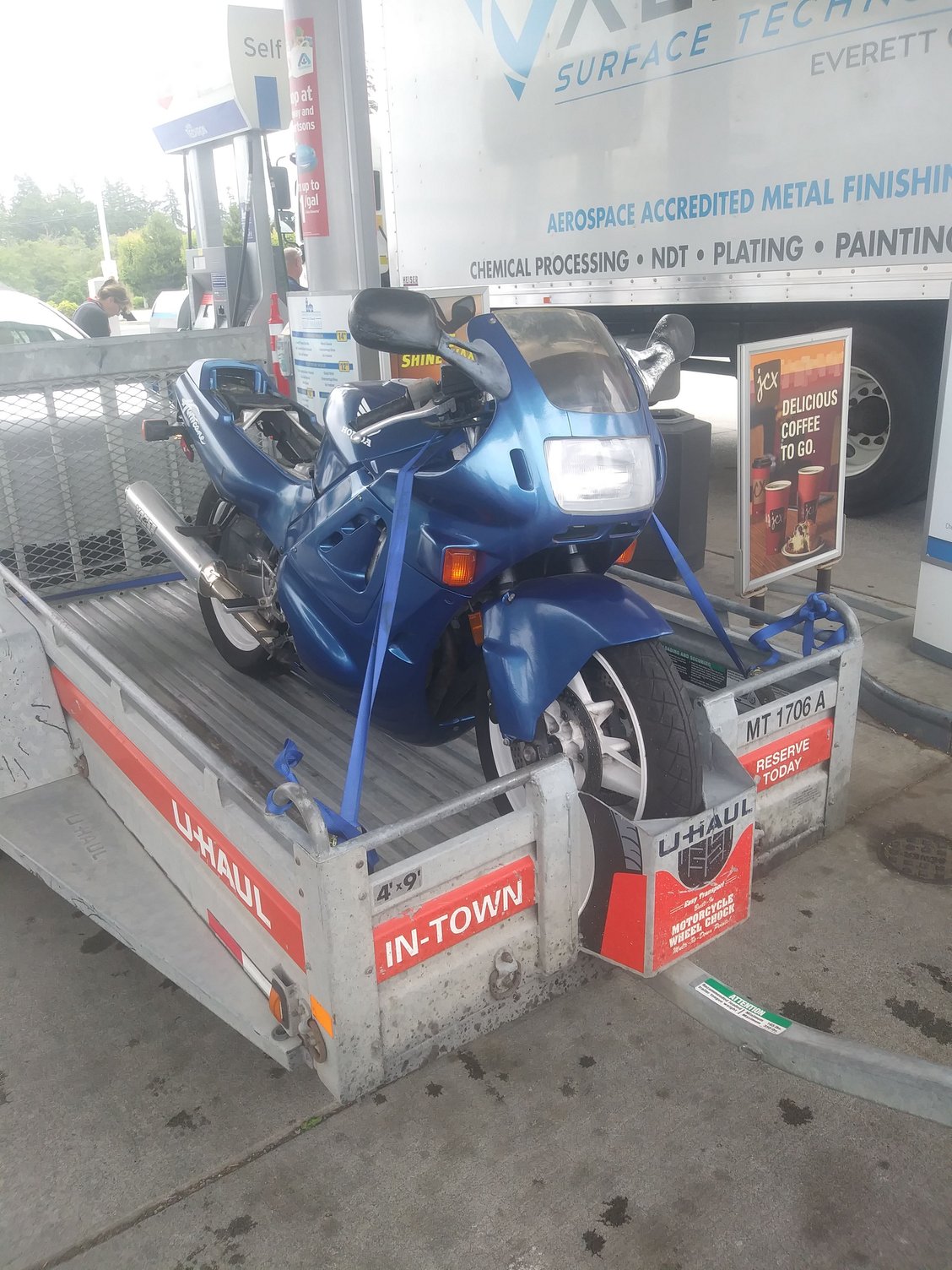

A couple pictures:

So it turns out when fuel sits in the carbs for 15 years, they dont work very well!
Over the weekend I installed a new battery, fuel pump, fuel cut relay, washed out the tank, new fuel filter, coolant flush, oil and filter service. And of course, pulled the carbs out and cleaned the hell out of them. Annoyingly, I had to do this a few times before they were clear enough to run good. But alas, it runs!!!
I am still a bit away from being able to ride the bike, it needs new brake pads in the front, and new pads and rotor in the rear. All the calipers need pulled off and make sure theyre not seized and make sure the slides are working properly. The rear brake was stuck on a bit making the bike difficult to move around.
The gear shifter was pretty sticky. at first it would not shift out of neutral at all. After some heavy cleaning and lubing of the exposed linkages, it moves into first okay, but doesnt spring back well, and doesnt want to go up to second (or higher). I am praying it just needs some use and keep working the lube in!
Other than that there isnt much i need to do before i can start enjoying this thing!
