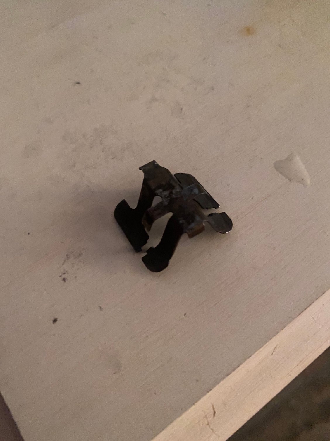

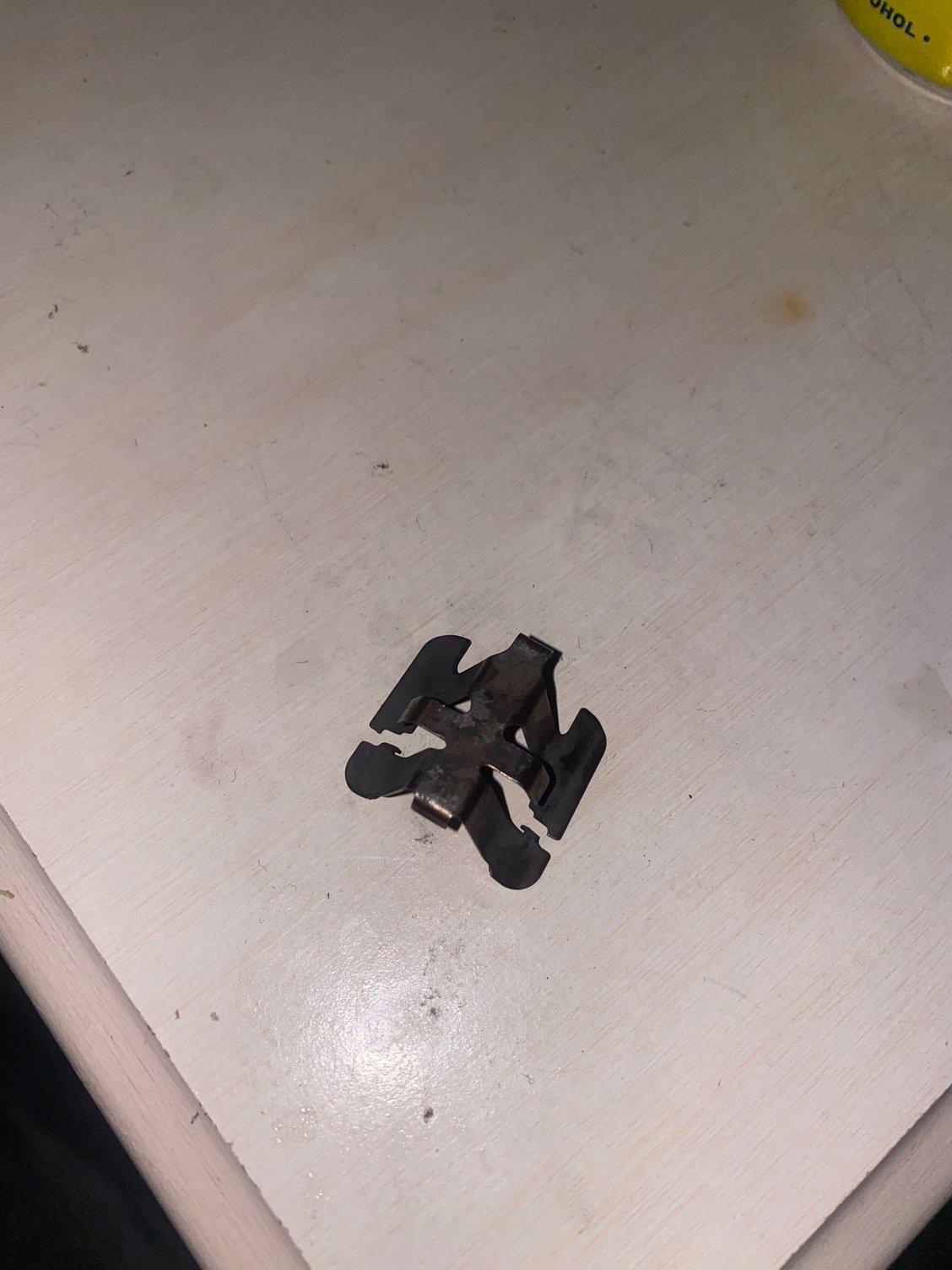

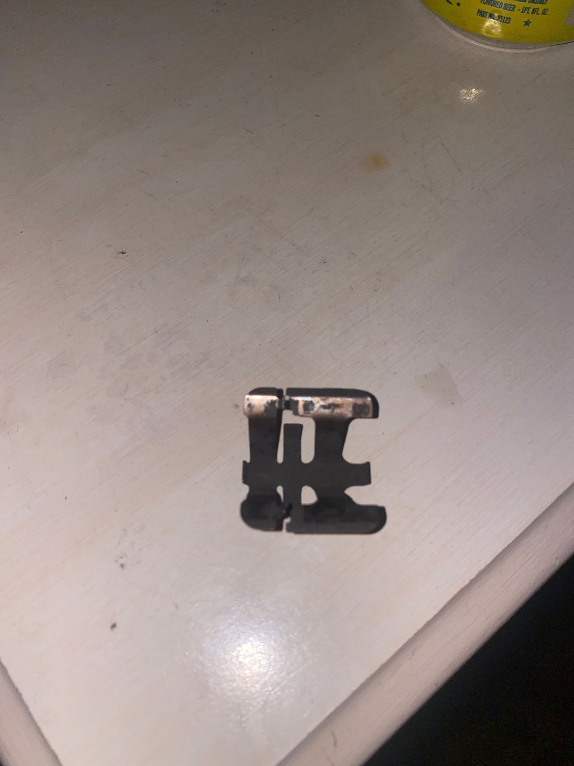

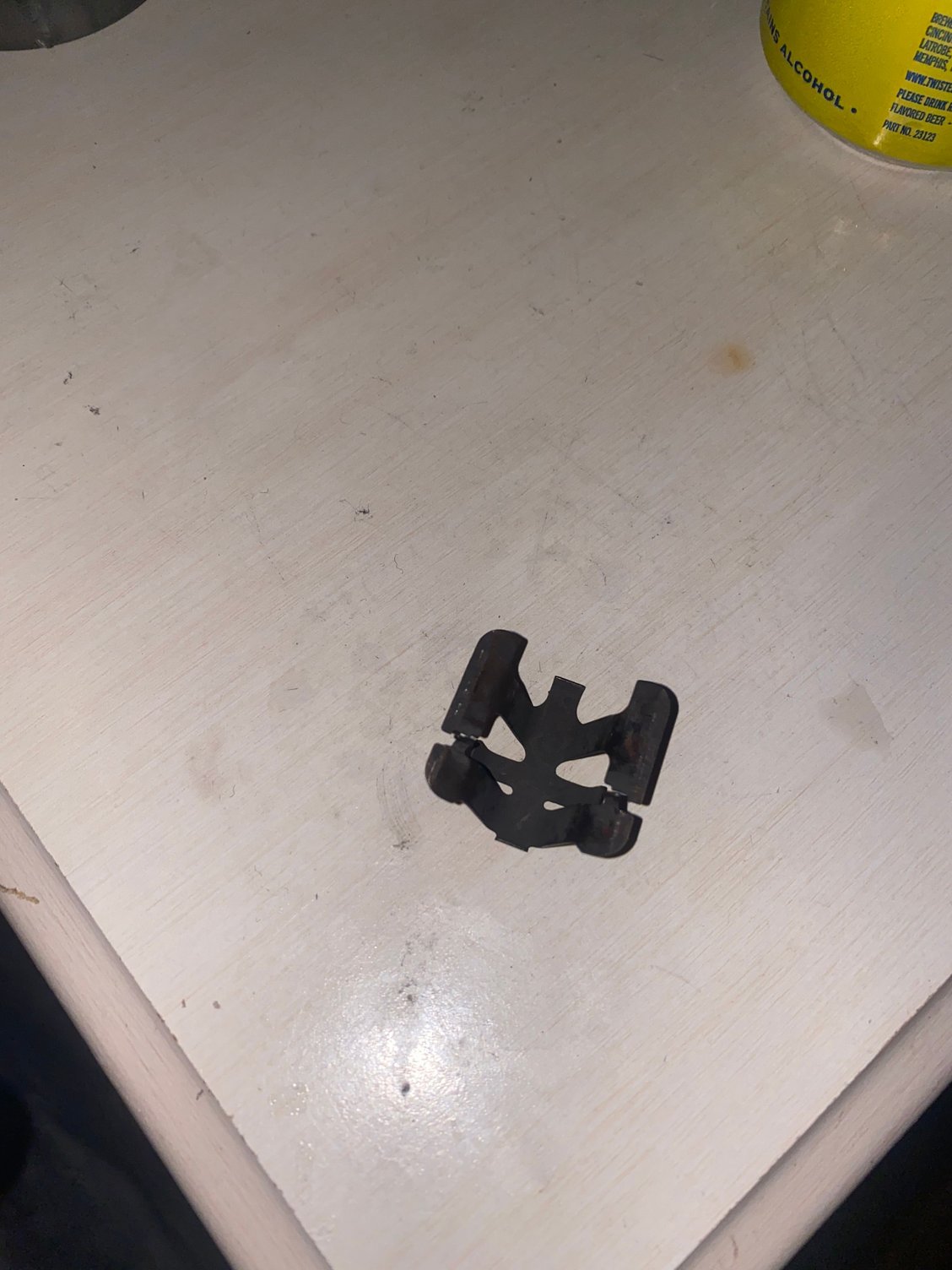

2002 F4i where does this piece go it fell out rear brake caliper
Old Jun 24, 2022 | 11:23 PM
Bluntsi's Avatar
Joined: Jun 2022
Default 2002 F4i where does this piece go it fell out rear brake caliper
Old Jun 24, 2022 | 11:49 PM
Hi and welcome to the forum. It goes into the upper body of the Brake Caliper and puts pressure/tension on the brake pads.
Old Jun 25, 2022 | 12:16 AM
Bluntsi's Avatar
Joined: Jun 2022
Hi! Thanks for the quick reply I figured it went somewhere in there but I don’t see a spot for it or know how it sits I can’t find a picture or video either does it like sit on the pads or is there a spot in the caliber? I installed the pads without it but worried it won’t work as well thanks!

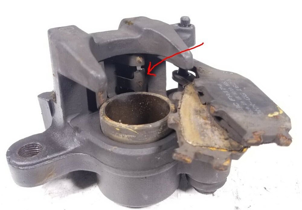

hi. found these pics from google. it sits like this
hope it helps
Old Jun 25, 2022 | 10:55 PM
Bluntsi's Avatar
Joined: Jun 2022
hope it helps
Man you are a life safer thanks!!
