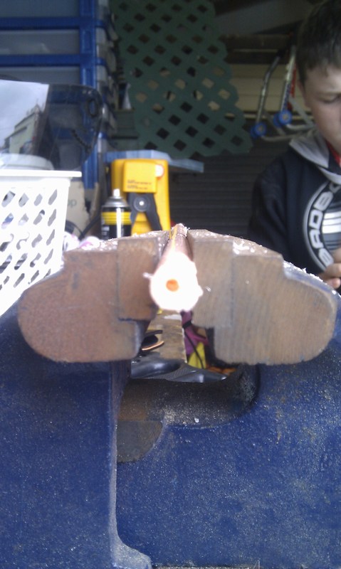

I had an idea the other day on how to repair a couple of broken fairing mounts I had on my left side cowl. I was in the local Bunnings store ( Home Depot ) and saw a pack of plastic coat hangers at the cashiers booth. The coat hangers are about 8mm in thickness and I thought it would be wide enough to take the brass female fittings the screws go into. Anyway I cut off a section of coathanger, used a 6mm drill to hollow out one end to take the brass fitting. It worked like a charm. The hardest thing was figuring out the correct positioning of the new mount and the length.
The old mount position was still visible so I could work out the direction the mount had to take. The length was a bit of trial and error. I screwed one into the cowl and had my son help me hold the side cowl in position in an effort to take some sort of measurement for length. It worked out pretty good with my measuring and estimations being ok....lol.
I secured the mounts with Araldite. I find it to be plenty strong enough. I know everyone uses other adhesives but Araldite is my adhesive of choice. It sets as hard as a rock and sticks to pretty much anything.
Basically positioning the mount and getting the correct length is the hardest thing I think. The coat hanger worked a treat for me. Its amazing what you can use around the house to get things done. A cheap and easy fix for sure.

No worries lads. Happy to help. Its a simple thing but works great. It certainly beats trying to fashion a mount yourself. Like I said there is a little trial and error in getting the correct length and direction is pretty close already utilising the remnants of the previous mounts. I used PLENTY of Araldite on mine and built it up around the mount I made out of the coat hanger plastic. I'm sure you could do the same with whatever adhesive you guys use. You could probably even melt some old ABS plastic up around it as well. I new all I needed was something to take the brass fitting and I was right. The coat hanger seemed to be the best way to go about it.
I'd be interested to see how it works for you guys. Cheers.
