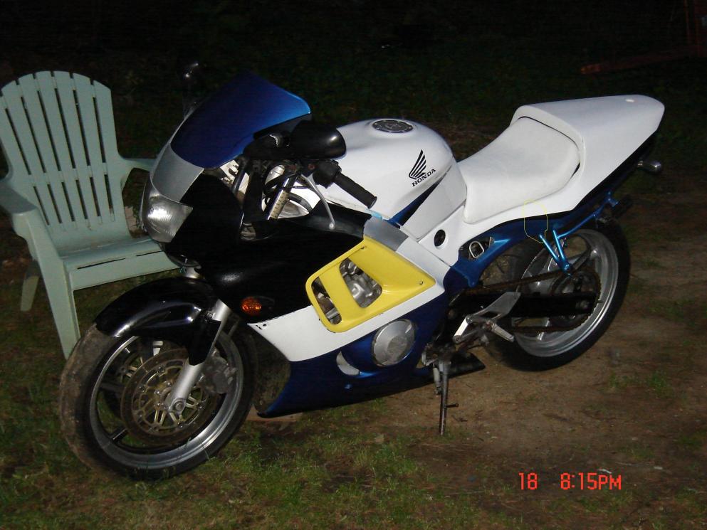

only thing i have for you is a pic. this is the whole reason i broke down and did the f4i conversion on the front. i think the f3 fairings just look to bulky. but just an opinion.

wassup bro,i like fiberglass to but hate the mess it leaves with the loose strands!if you could blend the two were the passenger pegs start,closest bolt hole to the rider.circle it in the pic.demented has a great bike (i dont know how you feel)but i dont like the look of the open subframe just sitting there,or sticking out a little.when the money comes in for me,i'm going to "try to" blend the 98-99 tail, love the way those look.
Yea that's about where I'm thinking of joining the two. All of my experience is with fiberglass and I've been repairing surfboards with it since I was a kid, so I actually kind of enjoy it. The only thing I don't like is all the sanding!! That's the best part about plastic.. it's so easy to sand down! haha
What do you mean by the 98-99 tail? On the F3? (honda stopped building the F3 in '98)
And yea, demented's bike was my inspiration for doing this.. so you could say I like his bike!! heh I don't mind the open frame so much cuz it looks a little better with the RR tail I think, but I will try to keep the F3 fairings on if I can make it look good that way.
