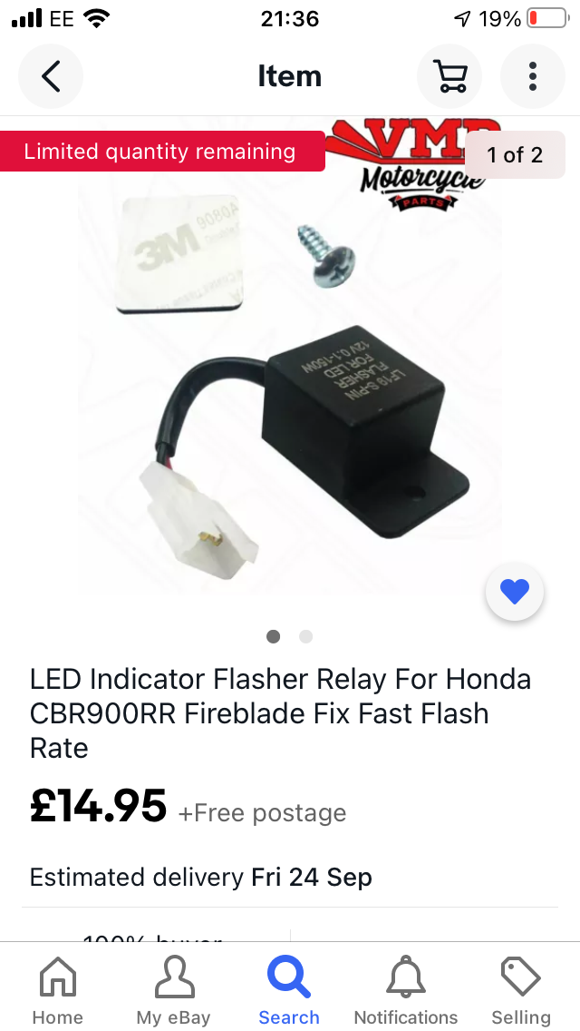

I just bought a 1997 RRV it has LED indicators that flash way too quickly, has anyone tried one of these to fix the issue?, cheers Mark

I used something similar on my CBR and it works a treat, got mine from 'sportsbikeshop' similar price if I recall, but at least you can get hold of someone to ask!!

Ah right thanks, am I right in thinking that the unit is mounted in the nose and you can access it by removing the screen?, I seem to remember reading that on another thread.

Certainly is on my 600, not sure on yours but can't see why they would be different

You might need at ty-Rap or two as they do not slide mount like oem ones.... just a thought

I just went to fit the 2pin relay on my 1997 RRV and found it’s actually a 3pin relay that is required, it’s situated under the LH infill panel, the black panel that goes between the fairing and the tank, just mentioning this in case someone else with a 1997 RRV needs to do this job, I’ve ordered a 3 pin on eBay £12.96
PS fitted it and it works fine
