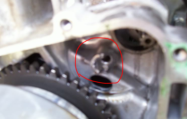

i found the problem ... [:@] alot worse then expeted.

OH SHYT!! That is not good at all man []

I'm a new to motorcycles and am thinking about buying a 94 CBR 600 and I think that's what wrong with it. What priec of the bike is that called and how do I fix it
Old Sep 8, 2022 | 11:19 AM
@Deepsixed9 Hi and welcome to the forum. If your engine looks like this section of the starter drive, then you don't fix it. You get another engine. Ebay is going to be your friend on this one.
Old Sep 8, 2022 | 11:33 AM
dannoxyz's Avatar
Posts: 1,988
Likes: 439
From: Mesa, AZ
This is what can happen when you have hydrolocked engine. Caused by leaky petcock and carbs, which drips petrol into engine when sitting. Then when starter tries to spin engine, it can't compress cylinders filled with petrol. That mounting-point for starter-clutch takes brunt of force trying to spin engine and cracks. In luckier cases, it strips teeth off ring-gear, which can be repaired. But not engine-block.
