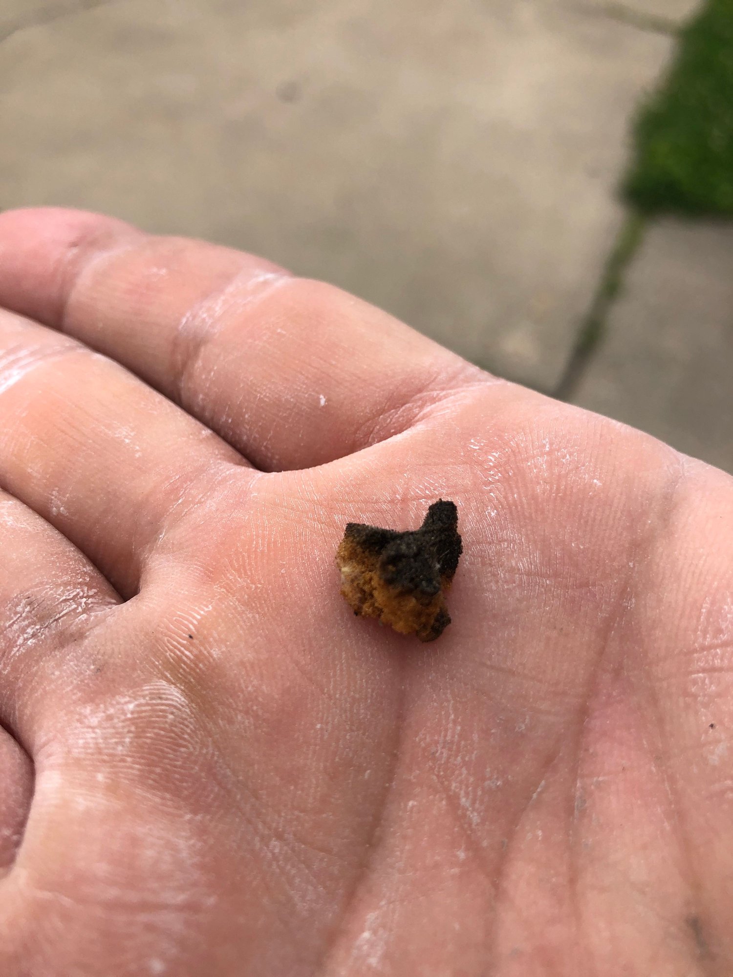

Update:
So I started to tear apart the bike to get to the carbs. See attached images. I found debris in the carb, the strange thing is there was a foam piece in there, a large one. I originally thinking it was from the fuel filter. I cut it open only to find it was intact and did not have "foam" in there. So that wasn't it.
It's also not from the air filter, that was intact and not made of foam either. I have no idea how this got in there. If it didn't get in through the fuel filter, or the air filter, I have no idea where it came from?? I cleaned out the carbs and reassembled everything. I have a new fuel filter coming in a day or so and then I'll see if it starts and runs.
Any idea on where the foam came from is appreciated.

There is nothing in the carburetors that looks like that. I'd say it was left over from the last time it was serviced. Just toss it and move on. There isn't any way for something that size to get to that location with the slides in place. It had to be there when it was reassembled. Don't be shy about splitting the bodies off the rails. The T joints between the carburetors are notorious for leaking. Replacing the O rings now is much easier than having to pull the carburetors again.
