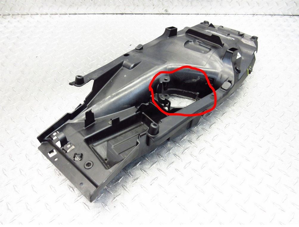

So, this is somewhat driving me insane. My race bike is a 2007 CBR600RR. I tweaked the subframe in a crash and cracked up the undertail tray. Placed an order for a replacement (80105-MFJ-D01) and I assumed all the part came with the tray... but there is some kind of insert that sits in there, and in my case it broke. For the life of me I cannot find the part even listed on the parts diagram.
Without the insert there is basically a hole in the undertail area. Would love to get some input from the experts on the part.

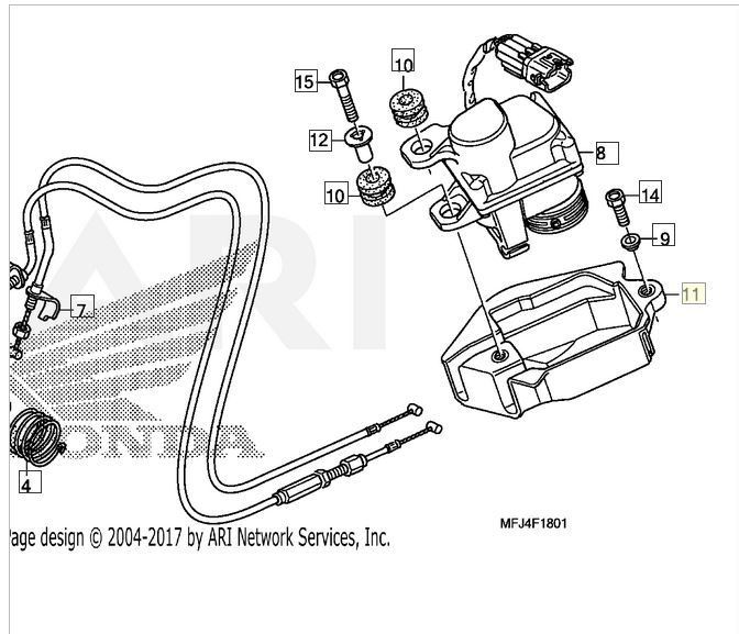

Finally figured it out. This is part of the servo motor assembly (item #11). Sheesh. Maybe this helps somebody else.

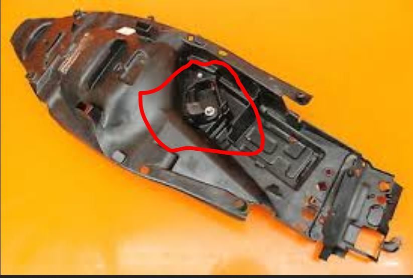

@Yamaboy @hamlin6 Same here :-( I was searching, but the F4i and certainly F3 don't have a Servo Motor, so did know what it was. I was about to ask the question, what would normally fit into that spot? You can see the place where the battery is, but I couldn't fathom what went there.
