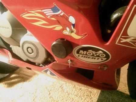

i am looking to get some no cuts for the same bike a 2006 cbr 600. Looking at the voertex ones. Does anyone have any picutres of what it looks like witrh the fairings cut. after all i have no clue where even they are suppose to be located on my bike. Pic would be awsome.

Here's a cut fairing, on an '03 600RR. Track plastics, but you'll get the idea and see where the slider goes.
My observations over the years:
1. No cuts = bad. They snap off.
2. Long ones = bad. They also snap, or dig into the ground and flip you.
3. Solid, removable pucks = great. Woodcraft, Vortex FTW.
Remember, they are FRAME SLIDERS, not "fairing protectors" (but they tend to do that also).
