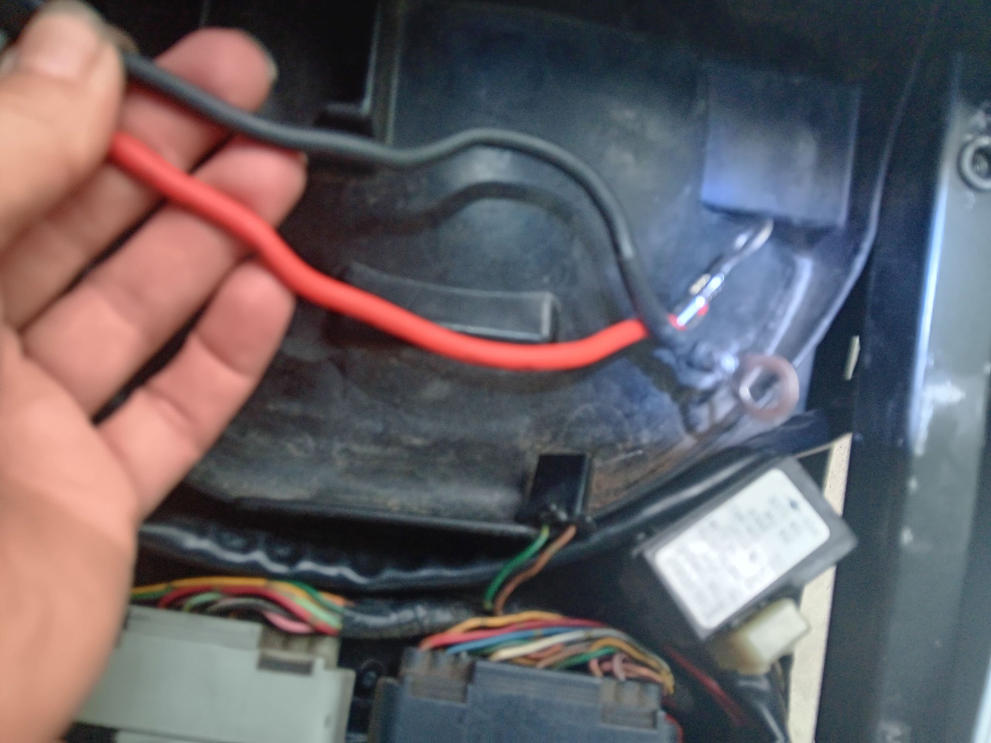

multimeter should b reading 14 or so once bike is revved a 4000 if charging system is working-my new used bike had the same issue once I once to tow it i checked the rectifier 1st cause i saw it was replaced-pulled the wiring out and the plug wasnt even pushed to lock but one of the 3 yellow wires wasn't pushed up into plug all the way-I pushed it in and it worked for 6 months then the whole plug melted the other night 45 minutes away from home-righed it up and made it home-now my new rectifier isn't the same wiring
Also when my rectifier wasnt working on my way home my gas reserve would come on cause Fi is ypur fuel injection but prolly on cause lack of juice
