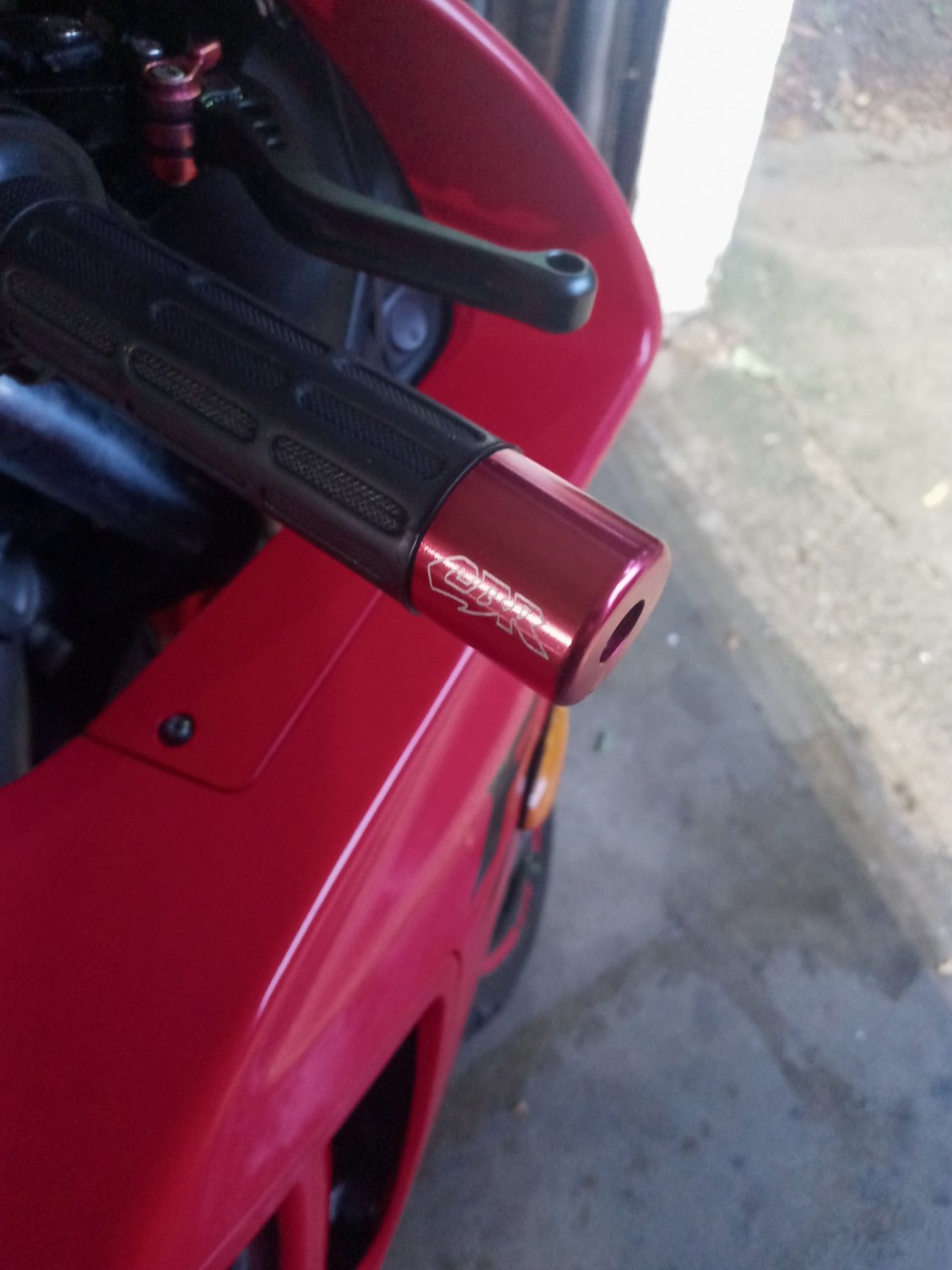

Bar end fell off yesterday while riding and she is GONE... Lol anyone know where I can find this specific set? Or a nice pair of metal ones? Screw in the middle came loose... Are they universal?

The nut part is still inside bar. Any bar-end with bolt that screws into that nut will work.
Or you can fish out the nut/rubber plug inside bar and install all new bar-ends.
Use some blue Loctite to keep from vibrating loose

thanks man I appreciate it...think I found the same ones so i'm happy 😁 and that's good to know for the future... And didn't think ab the loctite thanks💯

Different bars have the "bung" at different points, and are sometimes different diameters. You didn't even mention until now it was an F3.
