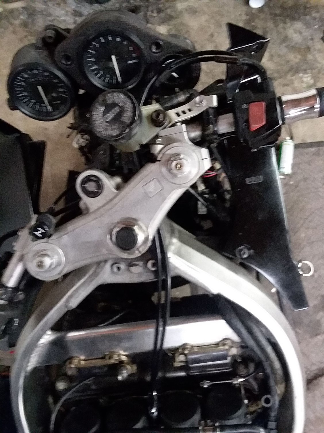

I finally installed the push cable. That's a plus. But now the throttle grip won't snap back. The cables seem to tight or something. I tried adjusting them but I can' figure it out. Any ideas?

Usually means your routing needs adjustment.

Cable routing
Cable routing
Old Feb 27, 2018 | 06:42 PM
Posts: 7,177
what about the routing of the mounting bracket on the carbs? Also did you test to see how "snappy" the butterfly valves were when you did it by hand?

I got it snapping back. Thank goodness.lol
I sprayed some lubricant on the springs and kept flipping the throttle working the lubricant in. Eventually they started working free and snapping back.
