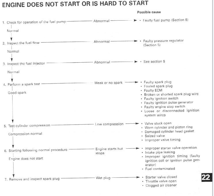

pic attached of the ignition switch wiring. Haven't started testing anything else as yet. Ih and the fuel pump no longer primes

Welcome to the forum, sorry to hear you having problems.
As you are in the UK, presumably you have a UK/EU bike, if so then you will not have the 'pink wire / diode' you will have the HISS system installed which is an electronic communication from key to switch barrel to ECM.
I hate to say but sounds like the ECM.
