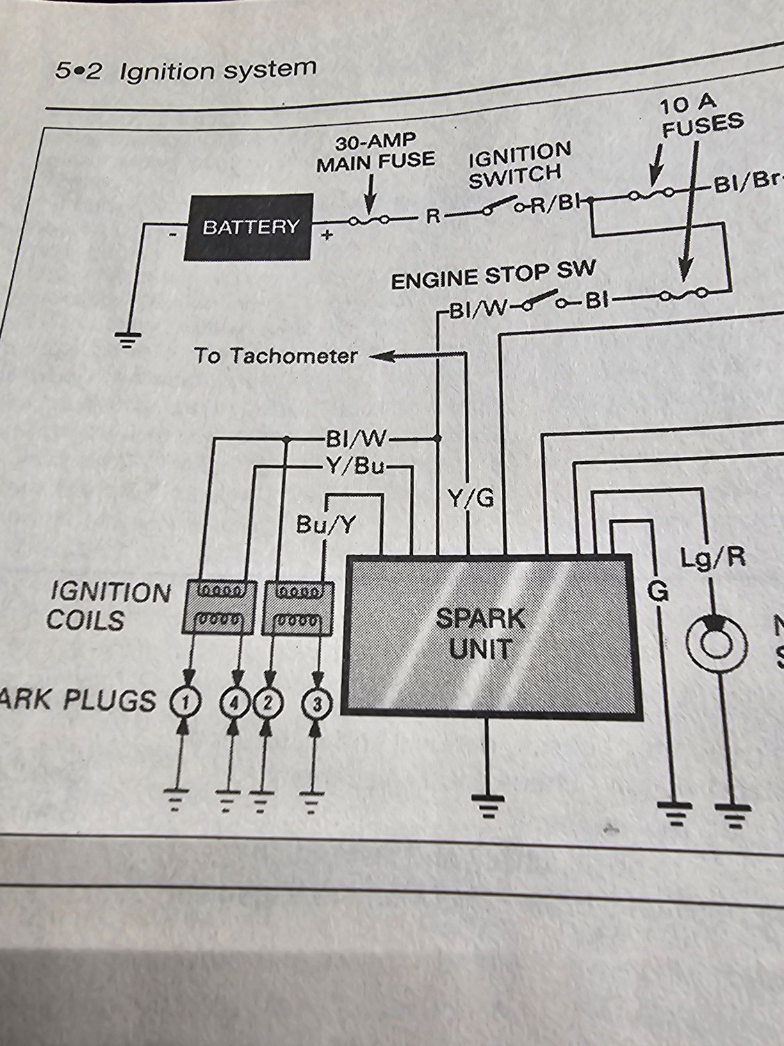

Hey guys, hoping someone can help me out. I got a lovely Haynes manual for my f2 and it shows different wire connections for the coils. Was wondering if someone had the wiring diagram from the honda service manual for the f2. Usa model . Thanks in advance.
yellow and blue wires are swapped

The site would not allow me to download the service manual but it agrees with the top diagram, blue/yellow to 2/3.
