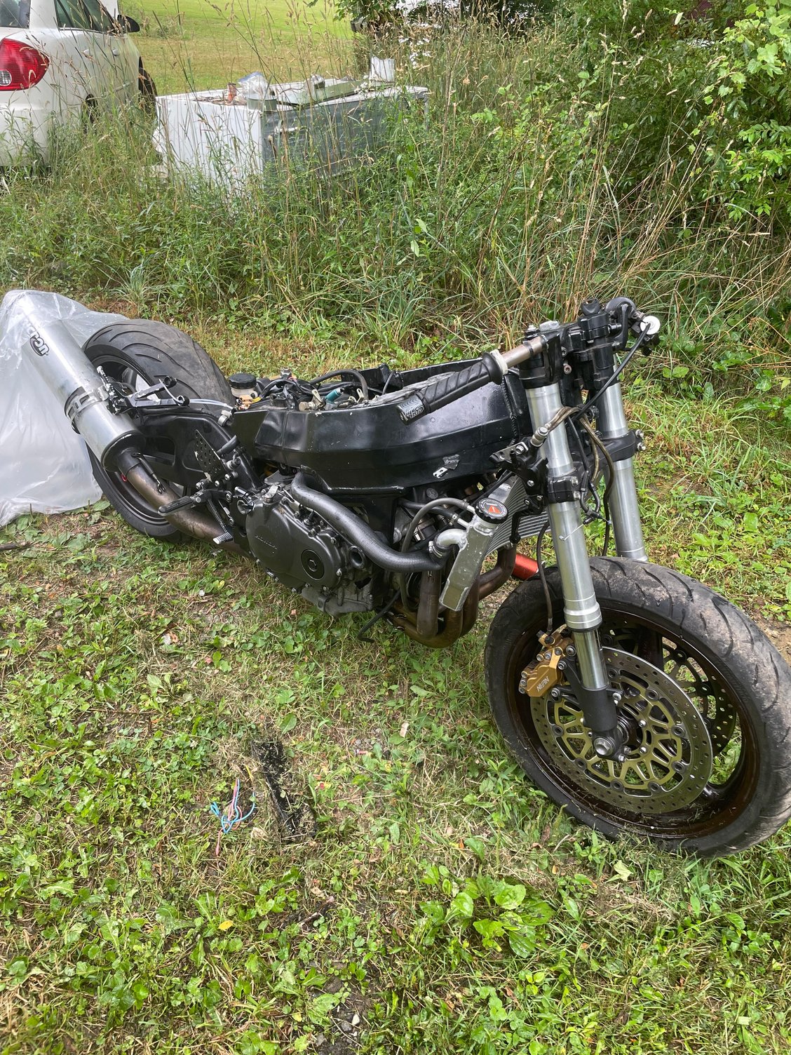

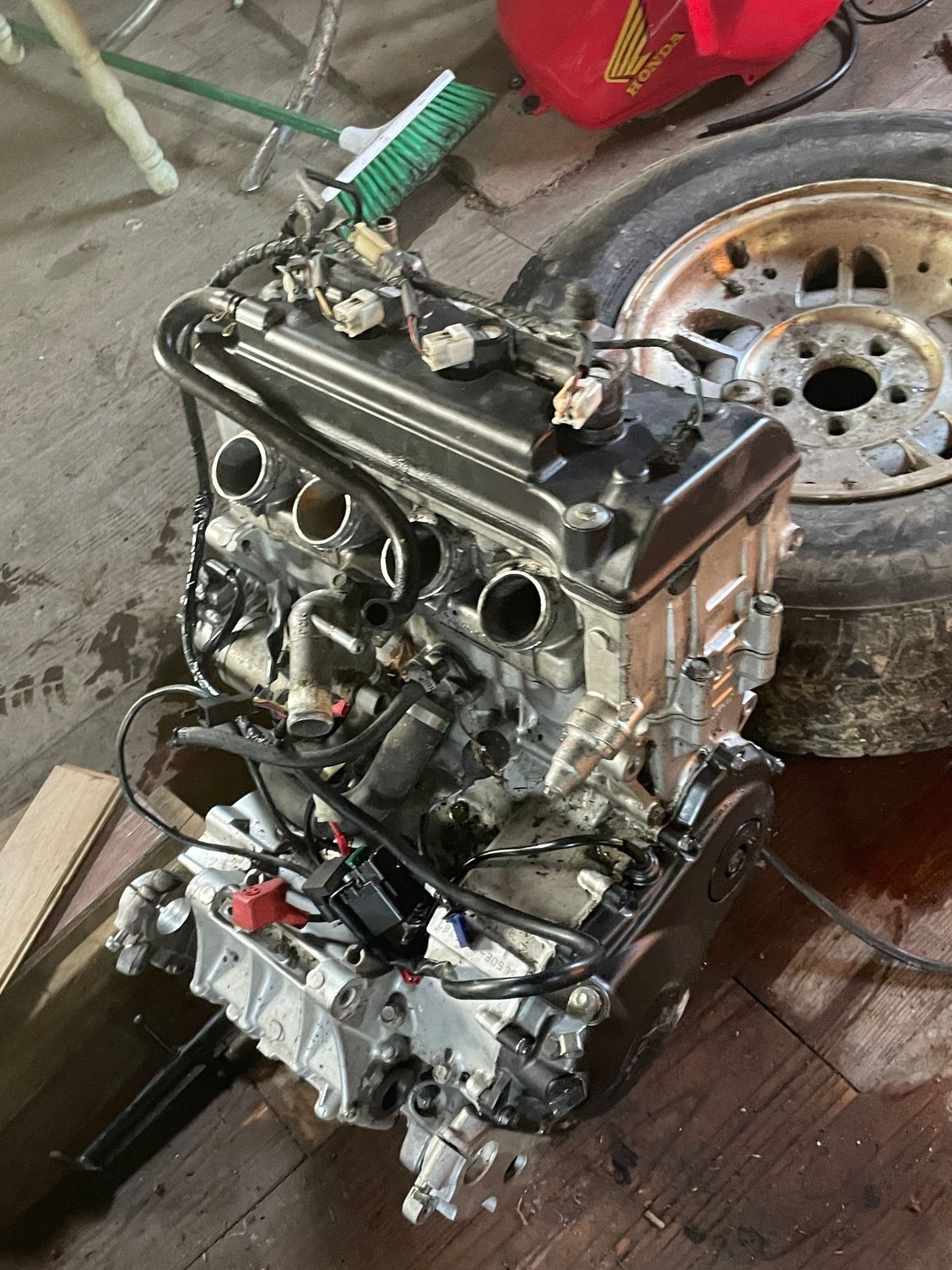

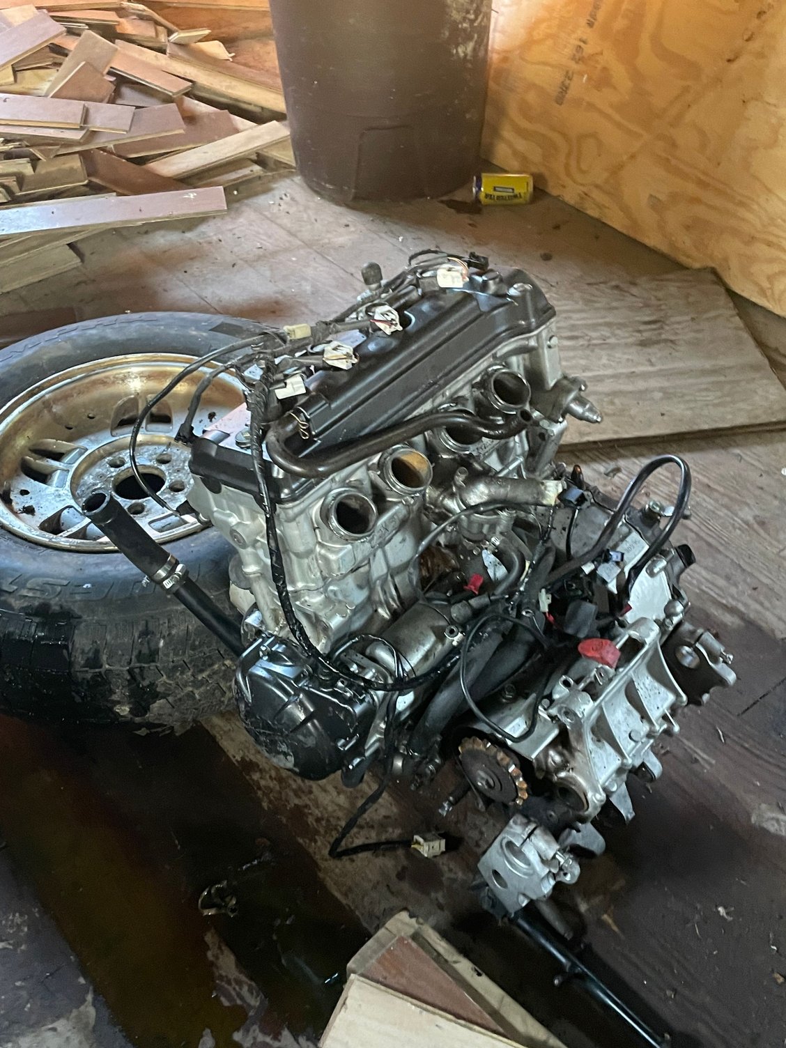

Just pulled the engine out of an 02 CBR954RR and putting it in a donor bike, oil had coolant in it. (Could it be from lying on its side for an extended amount of time?) paying a buddy of mine to replace the head gasket just in case. What will I need other than gasket and head bolts? I do everything but actual engine work. Trying to go cheap with it and use as many good parts as possible, zero shavings in the oil.
​​​​​​​pictures attached, engine, oil and donor bike
