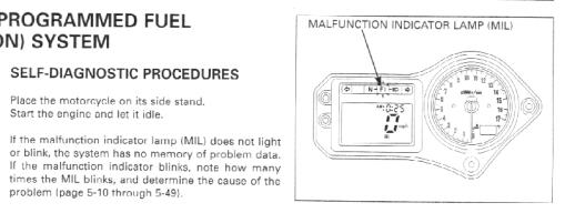

Actually only need to jumper to clear codes. Getting codes is just this:
Also measure your safety-interloc switches: clutch, neutral, sidestand. Do you get green neutral light on clocks?
Sidestand is often problem because of being banged. Can move it out of position, even though switch works electronically. Measure it with sidestand down and up. Ohms = ???
