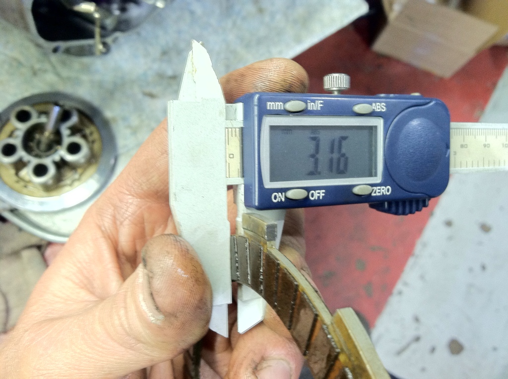

Original clutch still measures well in spec (2.4mm)

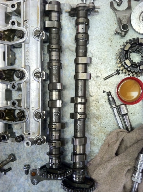

Top end like brand new.... literally looks like zero wear on the cam lobes, journals, thrust bearing, etc

Certainly can't complain.... Rotella T6 has done me well!
