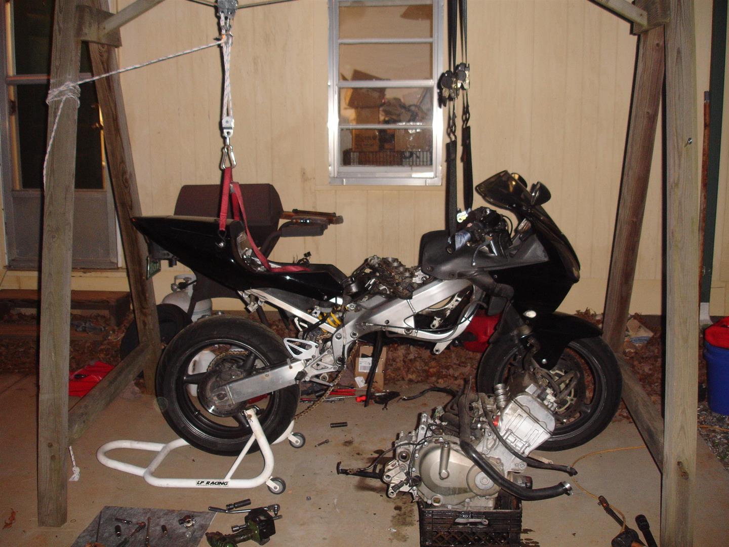

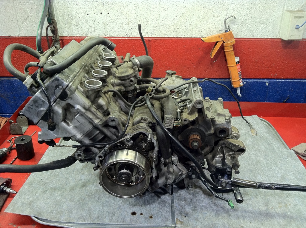

Well for the past couple months now my bike has been getting rather picky about staying in 3rd gear. It wasn't 'that' bad, but it has been getting progressively worse, so finally had to tear into it and get it all fixed up. Got all the parts I needed to fix it, and had a little time since we're not riding this weekend (going to the GNCC races again this weekend!), so decided it would be a good time to tear it apart
Went pretty quick.... I rode it to work yesterday, rode home (carried all the tools I'd need in a backpack and tankbag), got home a little after 6pm, got started on it about 6:30 or so, and it was out and ready to go by 8:30. Not too bad.... coolant was still steaming when I drained it and motor was still warm when I loaded it into the back of my car, LOL. The little A-frame idea worked like a champ! Hard to see in the pic but the whole bike is actually hanging in the air. I'm not gonna lie though, I really do wish I had a cassette style transmission that didn't require pulling the motor out to do this, lol

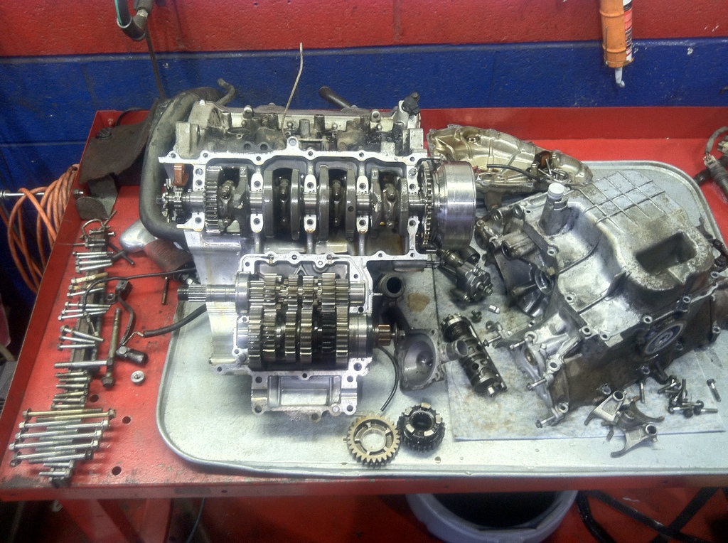

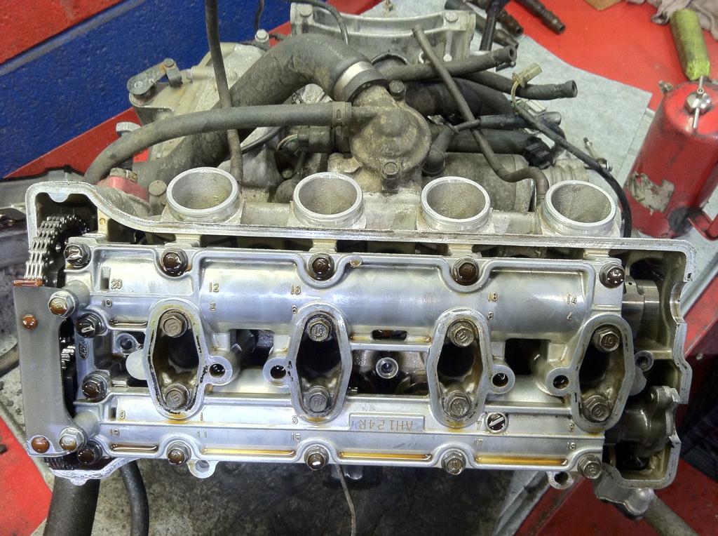

Took it into work with me this morning to tear it down. Boy was she dirty outside... the rural roads I ride on around here are so much dirtier than other places I used to live. Had to do some scrubbing on the outside for sure. The valve cover gasket was also leaking a little bit too so that didn't help any (it's original.... got a new one)

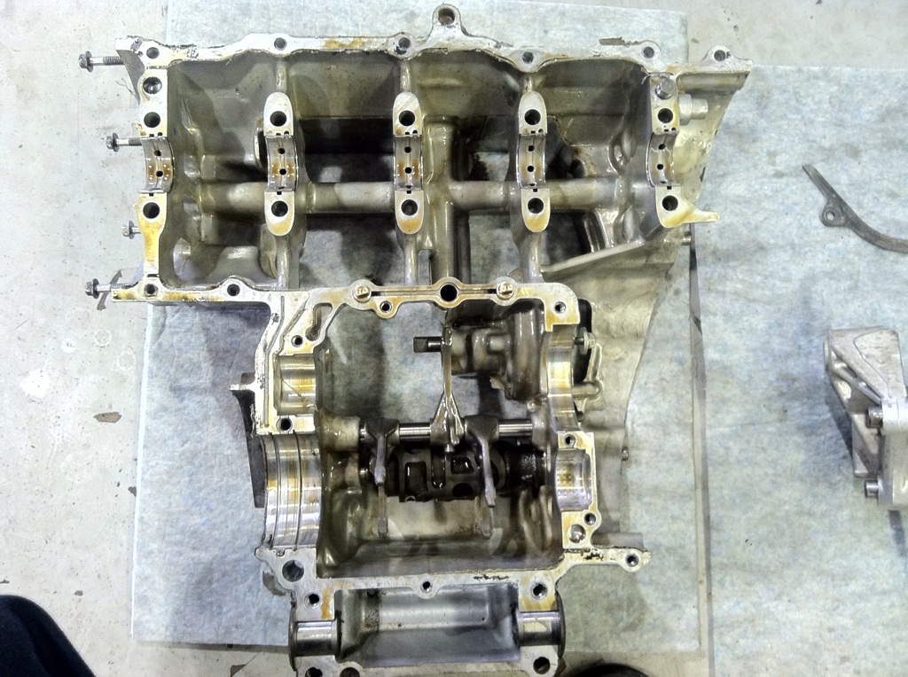

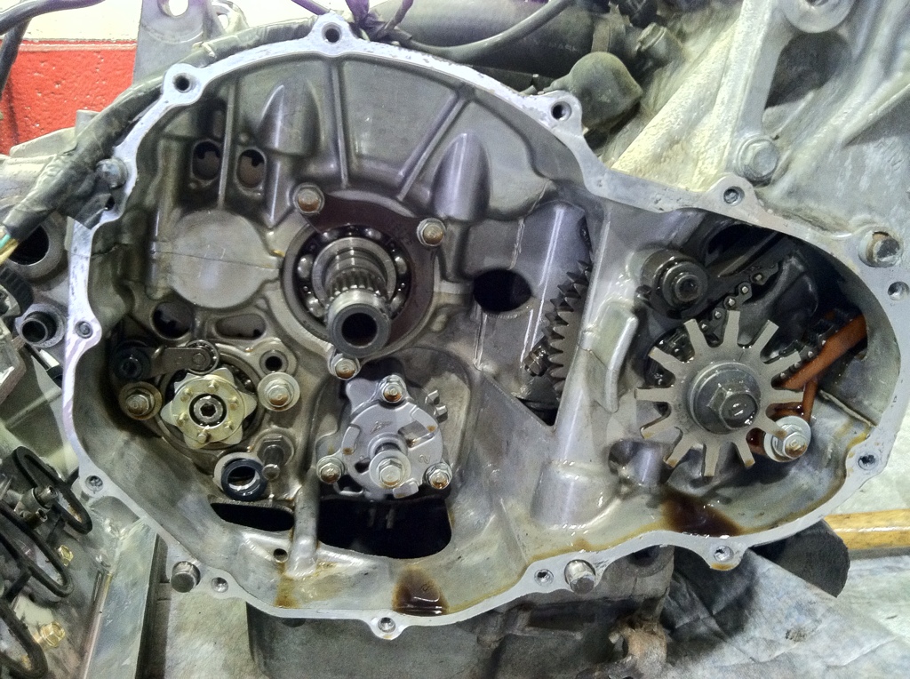

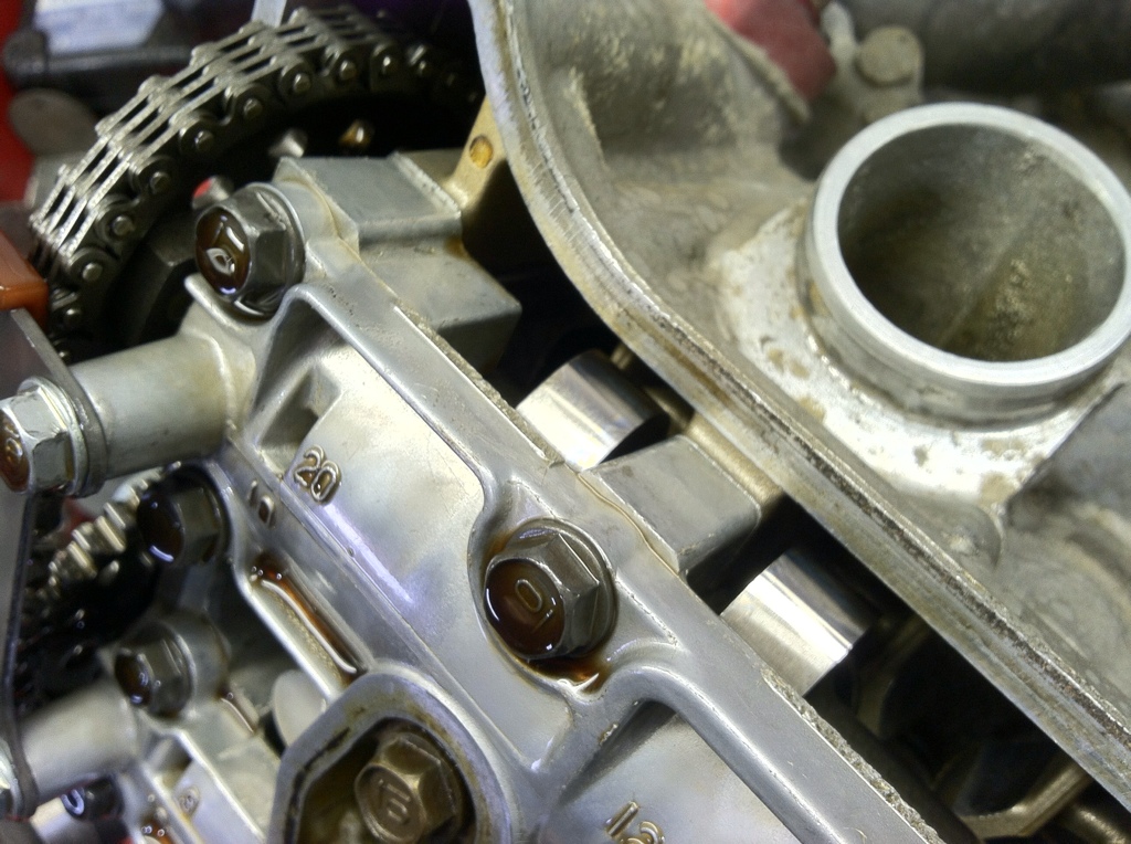

Inside though... nice and clean. Oil still nice and clean too for having almost 6k miles on it

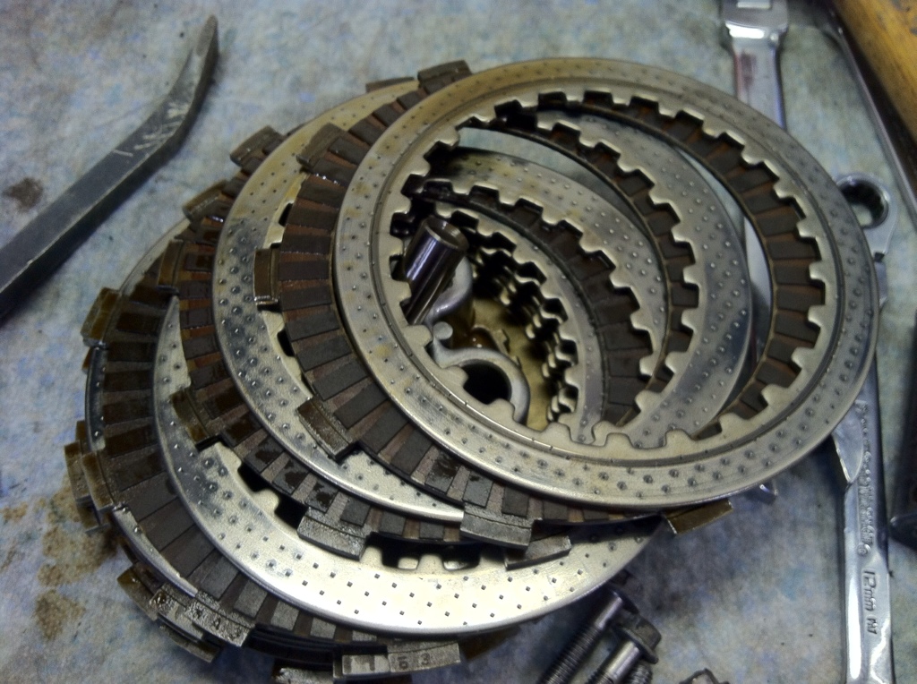

Original clutch still hanging in there and looking good (256,138 miles)

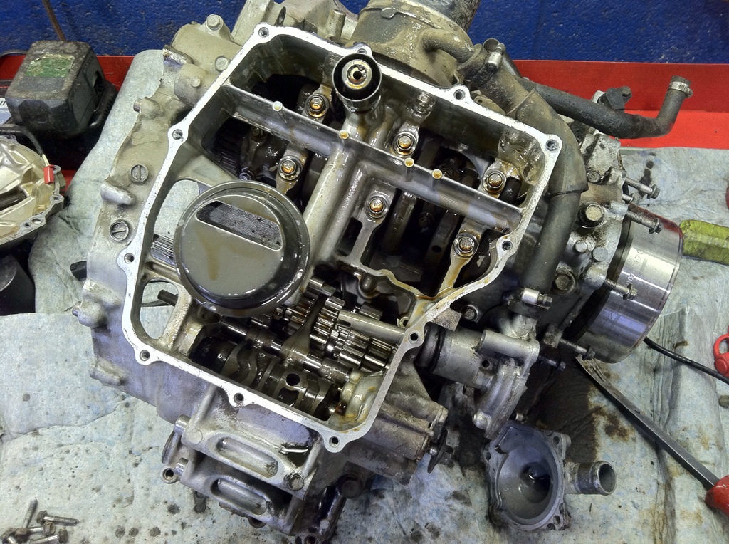

Once again..... squeeaaaakkky clean inside, always makes me happy to see. Regular oil changes FTW!

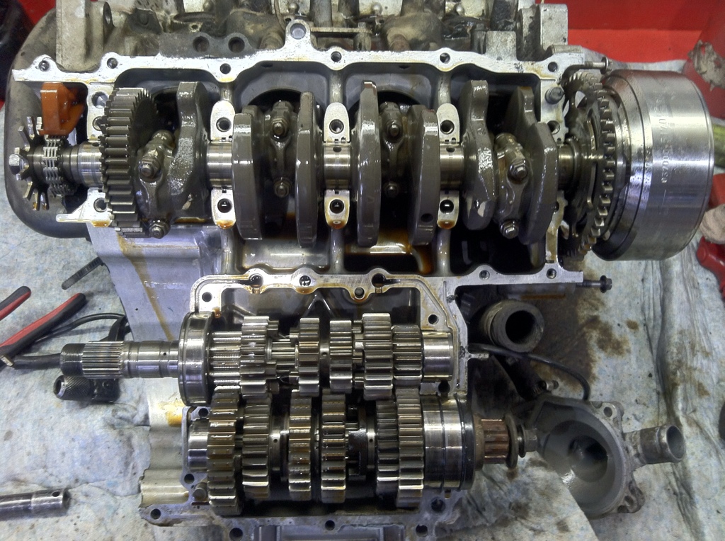

Bottom end looks brand new

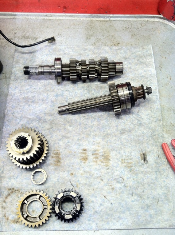

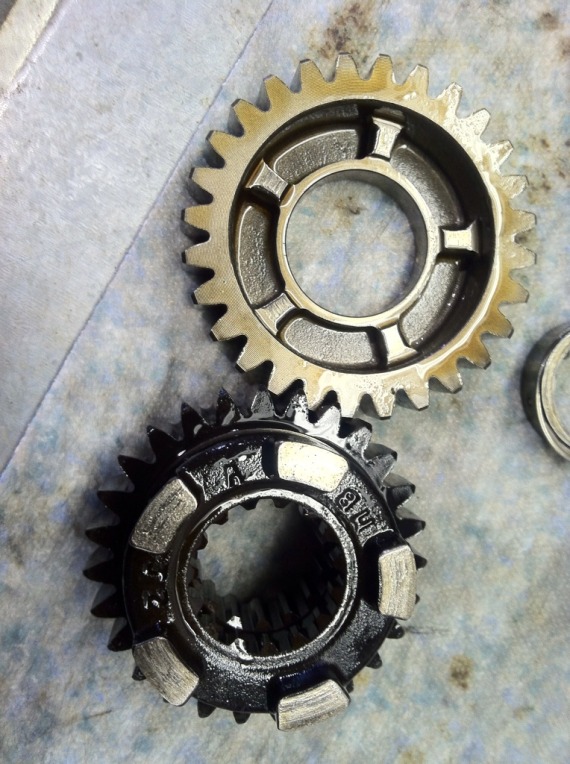

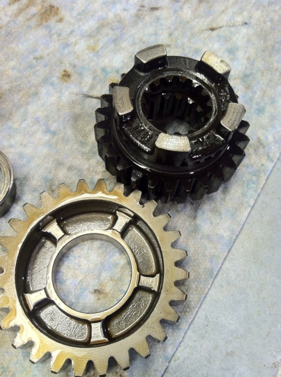

And here would be my problem..... gear dogs on 3rd rounded off, and of course 6th too since it meshes with 3rd

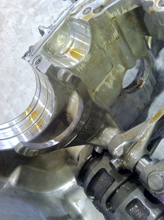

And got the shift fork a lil bit too
