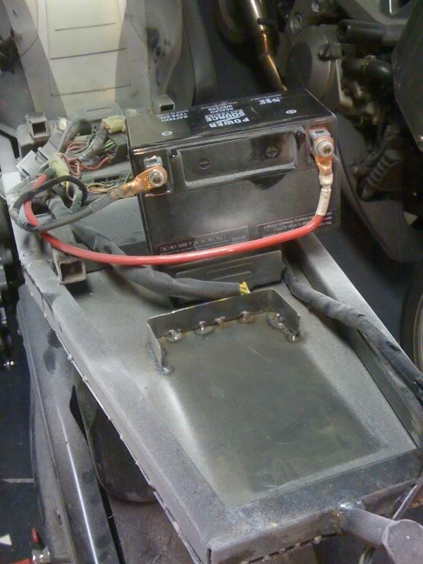

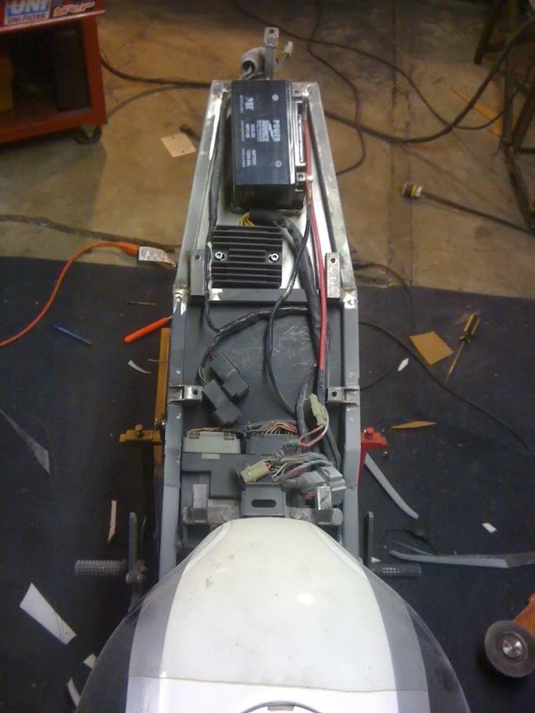

Here are two pics of the subframe. I made a small retaining wall for the battery to keep it in place and I am going to put a strap over top of it too. It is a lot of tail weight, but I will be getting a racing battery soon, so that wont be an issue. I also welded the nuts for the rectifier to the subframe as well. This gave it a solid hold down and also spaced it off the bike to keep it cool. I have room for power commander and fuel modual and all that crap too. I did extend the power cables as well, obviously.

Old Jun 9, 2011 | 10:41 AM
F34Me?'s Avatar
Joined: Mar 2011
Posts: 573
Looks good! Also looks like you painted that white tail while it was on the bike ^_^
Old Jun 9, 2011 | 10:50 AM
ssweetbro's Avatar
Joined: Mar 2008
Posts: 219
HAHAHAHAHA, well no, it came with white gel coat. That white dust is fiber glass dust from me cutting it up last night. There is a nice layer ALL over my garage. Doh. I didnt post pics of that, cause it is not done. I will post those soon.
Old Jun 9, 2011 | 10:54 AM
DammitMike's Avatar
Joined: Mar 2011
Posts: 173
From: Vienna, VA
Wow, very nice work man! Very impressive that you were able to fab up a new subframe to fit the new tail and have it come out so clean.
Old Jun 9, 2011 | 10:56 AM
ssweetbro's Avatar
Joined: Mar 2008
Posts: 219
Thanks. I think it is gonna turn out pretty clean. Should look kinda like the small tails they run in Moto 2. That is my goal at least.
