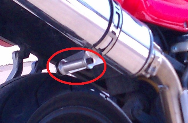

06-07 i do believe. Cut a piece of the old mid pipe off so the angle would line up from the header to where the inlet of the can was. Then rather than welding them together we made a cut across the midpipe so it could be expanded open to slip the can inside of it.

Then to mount it up to the exhaust hanger I used a extension bar that was for my old micron high mount.

Had I not had that or a bent mid pipe that i didn't mind cutting up it probably wouldn't have happened. In fact right after I got the pipe and seen it wasn't going to bolt right up I lost hope for a week and had it for sale on Craigslist. Then Champ24 came over we grabbed some brews and started toying with it.
In the end it turned out awesome.
