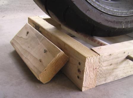

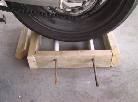

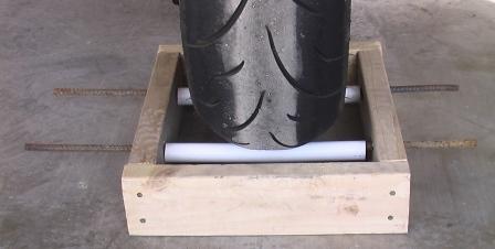

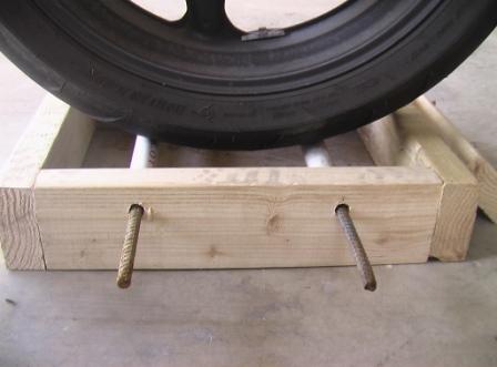

I was lamenting my economic situation today. Money is tight and I can't afford a rear stand that will allow my wheel to spin while I clean or put on my rim tape I got last year.
I was looking around my garage and noticed a few things that when put together would do the trick.
Parts list:
2x4 - cut to 14 inch lengths (4 pc)
2x4 - Cut to 8 inch length (1pc)
PVC Irrigation Pipe - any diameter - cut to 13.75 inch lengths (2)
2.5 Inch Nails (8pc)
2.5 Inch Screws (8pc)
1/2 Inch Rebar - any length over 14 inches will do (2pc)
Put it together just like the pictures. The small 2x4 ramp helps roll the bike backwards onto the stand. To rotate the rear wheel just grab the rim and pull. A bit rough but works just fine.
Cost - $10
Time - 20 min

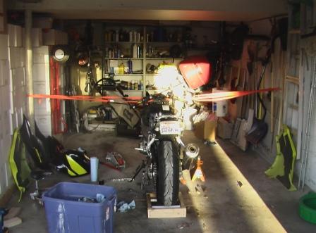

what?
how are u holding the bike nice and straight?

yea...i was kinda wondering the same thing.
how is the bike remaining centered?

Sorry, I didn't think to include information about how the bike is standing up straight.
Like I said, money is tight..... I have the bike in a 10 foot garage strapped upright to both walls with cinch type tye downs. Pretty cheap huh?
The bike is partially apart because I've traded some tile work to a guy for a paintjob. The previous owner layed it down.

LOL That's ingenious man, love the pic of it strapped to the walls!!! looks kinda like a poor boys anti theft system as well. LOL
