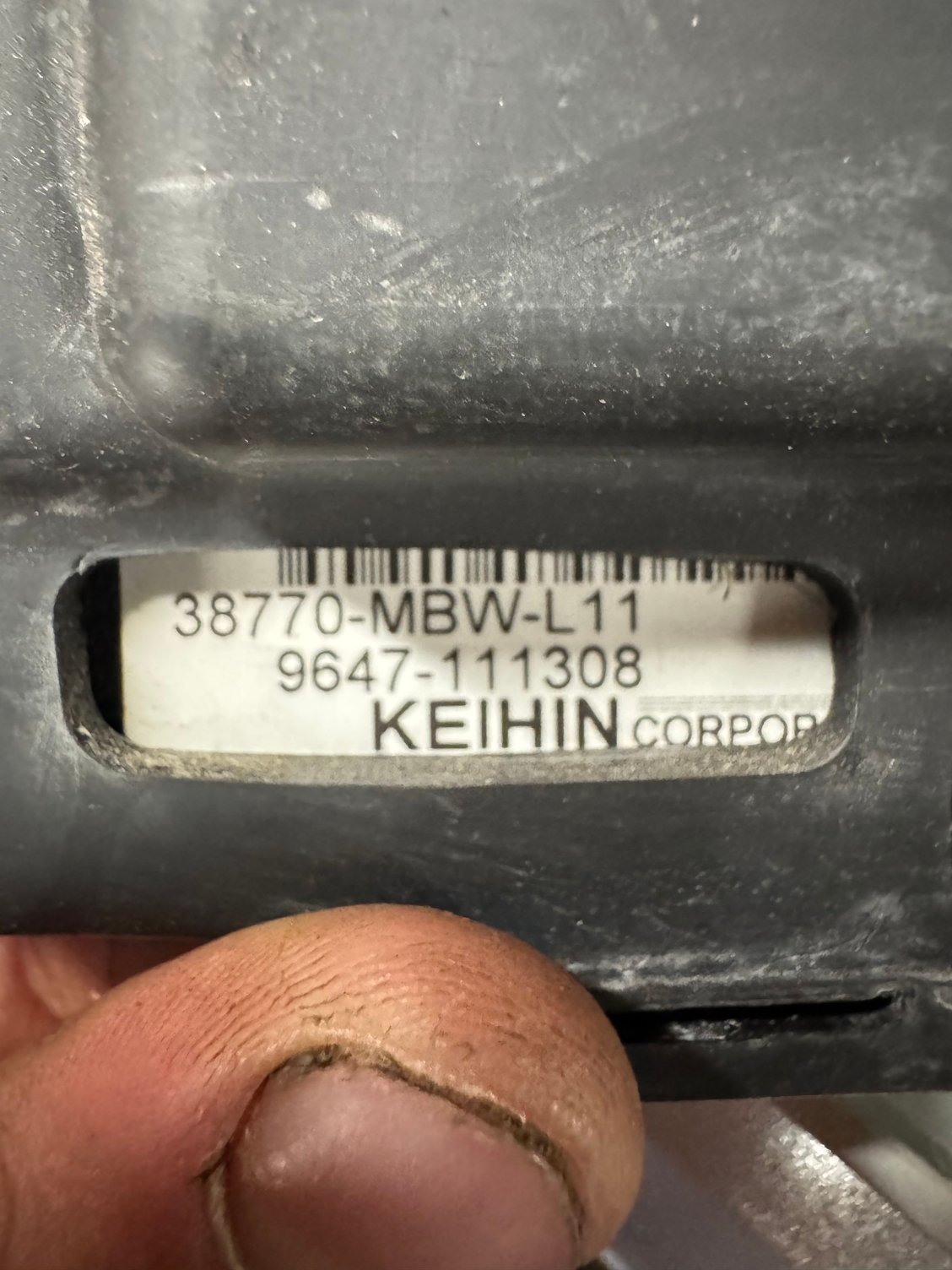

Old Aug 22, 2025 | 10:55 AM
Jwilly's Avatar
Joined: Aug 2025
Posts: 5
From: West Virginia
Here she is! I appreciate your input
Old Aug 22, 2025 | 10:40 PM
Jwilly's Avatar
Joined: Aug 2025
Posts: 5
From: West Virginia
Default Solved!
Somehow i have a cali ecu explains why i dont have the plug, bike was laid down by someone and i suspect ecu took a hit.
