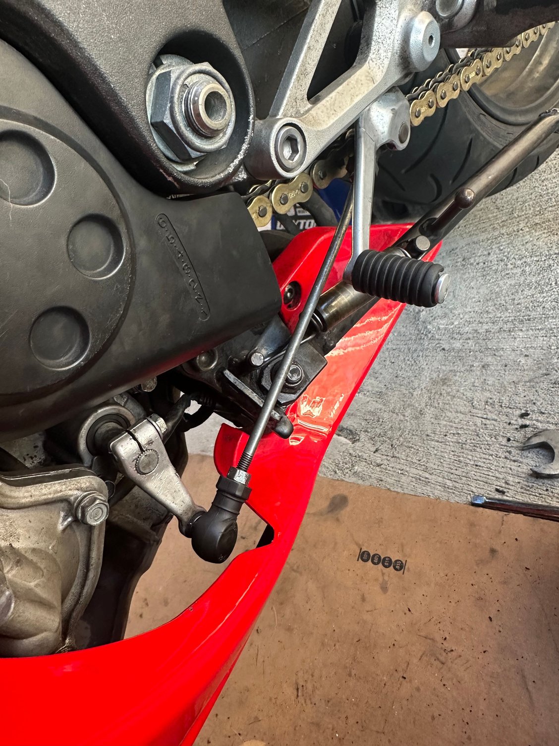

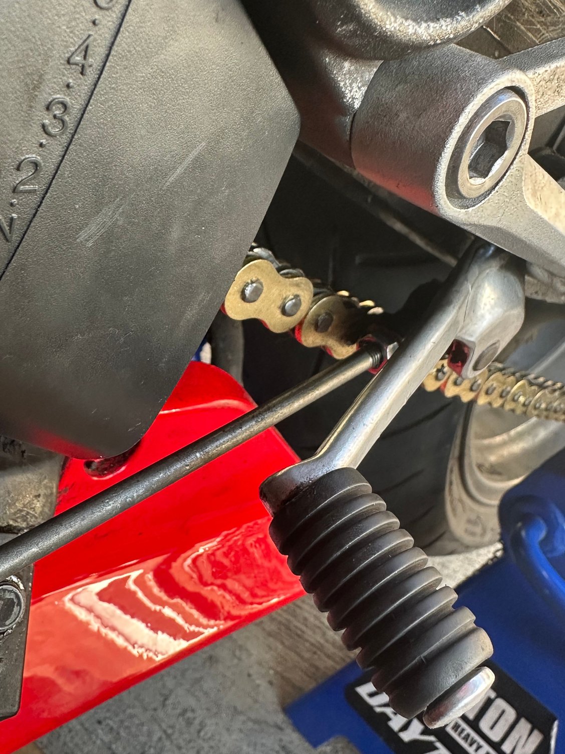

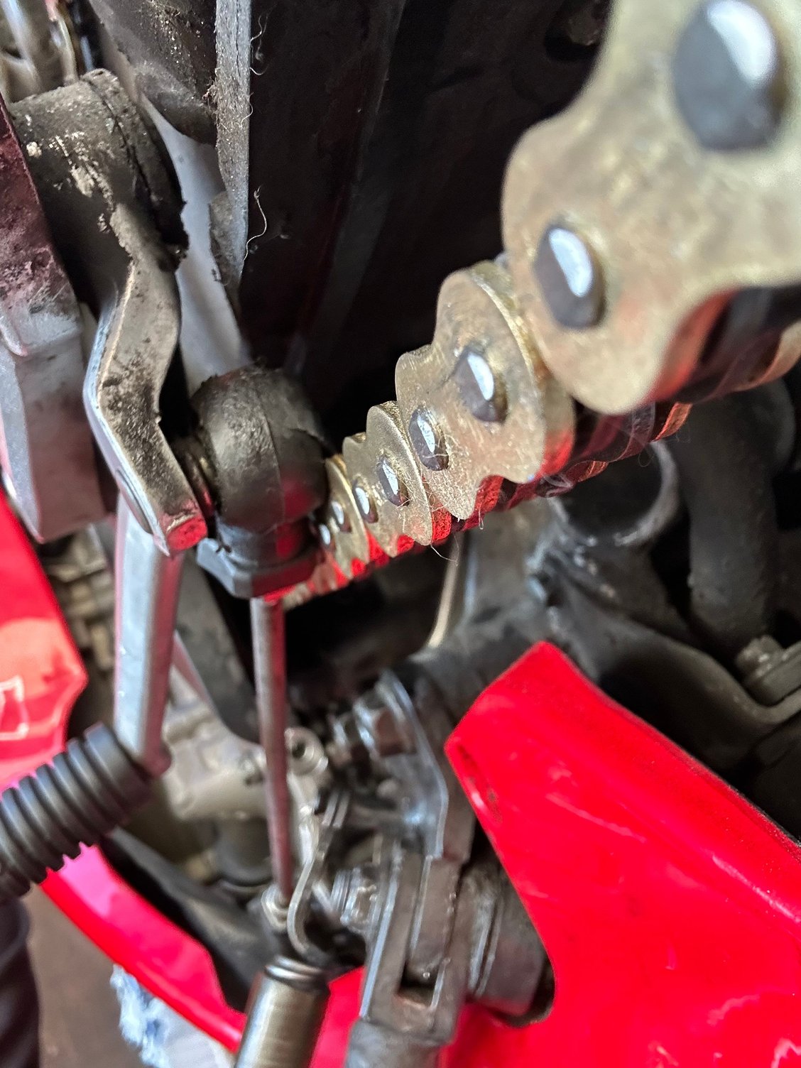

So I am having issues with the shifter rubbing against the chain causing the old one to have snapped. I feel a vibration(chain rubbing) and a grinding noise when I shift into first, Any suggestions?
