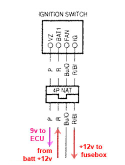

IGNITION SWITCH - 1st stop for power from battery. Measure by backprobing connector where ignition-switch plugs into harness.

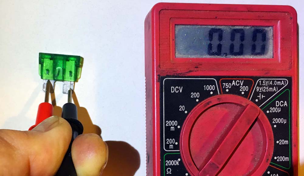

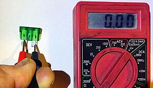

1. measure red wire going into ignition switch, should be same +12v as battery
if zero, measure resistance of 30-amp main-fuse and resistance of red wire end-to-end, want 0-ohms for both
Attached Thumbnails DIY Startup & Fuel Pump Prime Troubleshooting F4i 01-06-ignswitch01-06f4i.jpg   DIY Startup & Fuel Pump Prime Troubleshooting F4i 01-06-fusemeasures.jpg
