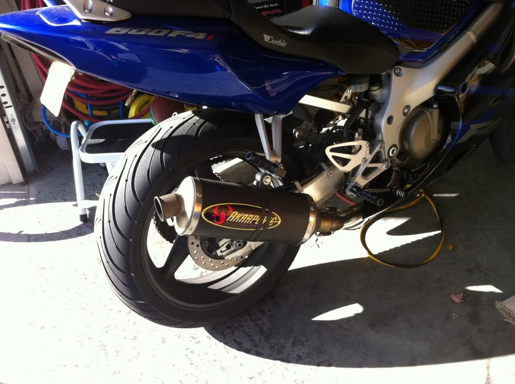

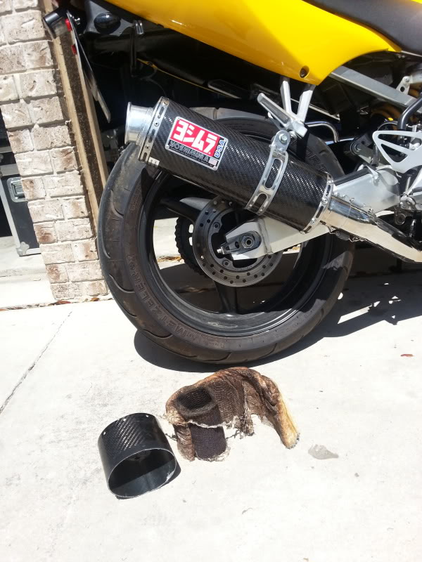

Finally cut mine down!
Now I need a new sticker.

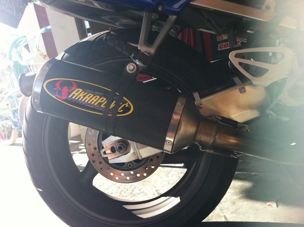

Just did mine over the weekend. Thought about taking off 6" but went with 4" off of it and love the way it sounds now. Wasn't too painful except for getting the inner pipe (which is spot welded all over the place) off of the flange piece that is re-inserted into the inner pipe.
Wish I had a saws all because doing it with a hack saw F'ing sucked.
