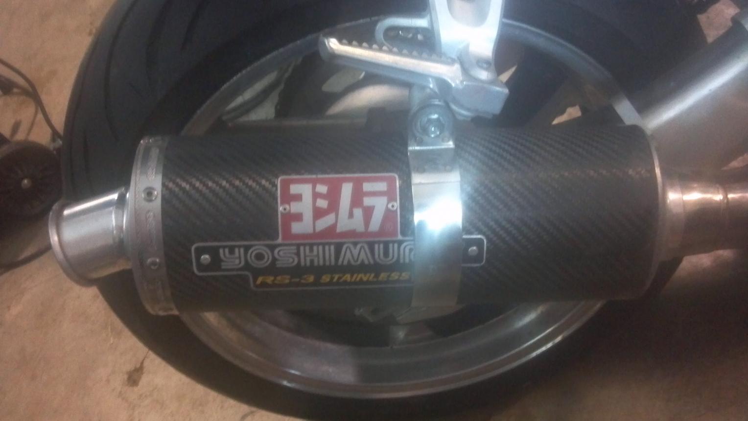

Default F4 yoshimura shorty
Heres a pic of a shorty i did for my cousin yesterday to get rid of some road rash.

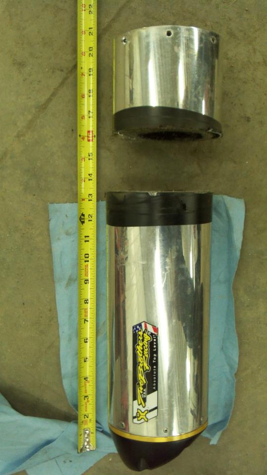

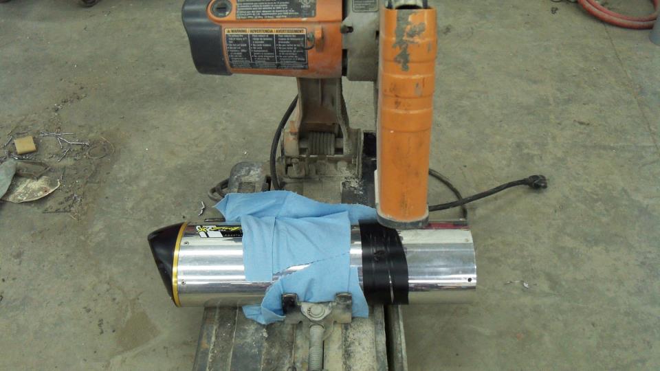

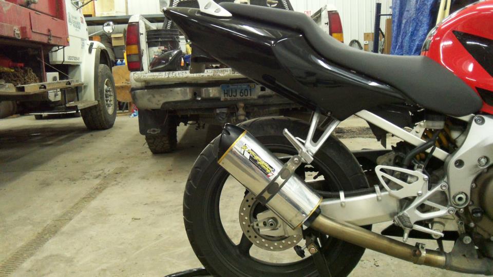

Originally Posted by MeanGreenZ71
Mine doesnt look like yours...
This is what mine looks like:
I wonder if the internals are the same though...
I just did this to my 2-bros last night. actually A LOT easier than the tutorial. with the 2bros such as this just simply take off the intake end cap and put it in a chop saw. *see pics
Cutting Your Exhaust DIY How-To-524241_10150600208182061_503677060_9612310_1459829796_n.jpg
Cutting Your Exhaust DIY How-To-558453_10150600208252061_503677060_9612311_806436115_n.jpg
Cutting Your Exhaust DIY How-To-523468_10150600208342061_503677060_9612312_1926065346_n.jpg
hope this helps you guys out a little. also have a video of how the exhaust sounds uploaded on my facebook if your interested. Facebook
