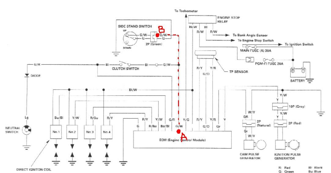

Old Apr 17, 2022 | 11:25 AM
Originally Posted by cbrbike
hi. did you check side stand switch with a multimeter ? if it's ok i would check continuity of Green/White wire between side stand switch and the ECM socket
The Side Stand Switch is providing a ground path on Pin 21 (the Green/White wire). With the Side Stand in the up position you should have continuity from that Green/White wire to frame ground, or the Neg terminal of the battery.
Update
So, I was doing a check on my ECM for another person with a suspected bad one. I went ahead and checked from the Green/White wire to the frame and with the Side Stand in the up position, it had 0.0 Ohms (good continuity). With it down, it read about 1.8 K Ohms.

Old Apr 17, 2022 | 01:07 PM
cbrbike's Avatar
Joined: Feb 2017
Posts: 163
Likes: 35
hi. could you check for this continuity (ohms reading) .
A - Green/White wire at ECU socket
B - Green/White wire at side stand switch ( bike side )
Old Apr 17, 2022 | 01:19 PM

Old Apr 18, 2022 | 05:01 AM
danluke1640's Avatar
Joined: Jan 2020
Posts: 14
Likes: 8
Hi just a quick update.
i tested the green to earth - all good
I tested the green/white to pin 21 ecu - all good
bike still cut out as soon as I put into 1st gear
started bike in 3rd gear and it stayed running so went down to 1st gear and it stayed running.
i then turned the bike off and restarted it in 1st gear and it ran perfectly
so not excactly sure what I did or it needed to be started in 3rd gear first but it’s running perfectly now
