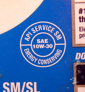

Some oils have additives that are not good for wet clutch kits.
If the bottle say's "Friction Modifiers" or "Energy Conserving" anywhere on it, do not use. Some have said that xxW-30 oils use friction modifiers and xxW-40 do not. i would look into a little bit more.

Friction modifiers may cause your clutch to slip. basically, aside from motorcycle oil, most multigrade motor oil for semi-trucks like Shell Rotella or Chev Delo...or Mobil something is good. Shell Rotella is rated as motorcycle oil too. Get the cheapest 15w-40 and you'll be good.
