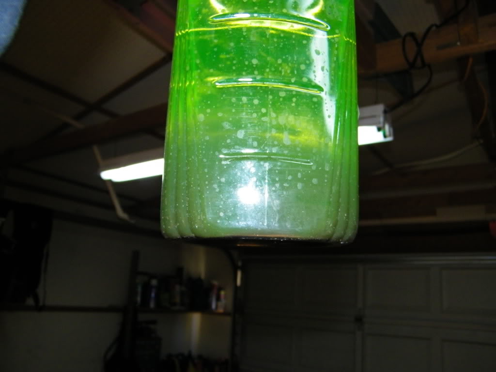

I would remove the radiator hoses and flush the radiator with a hose after running clean water through it; the reason I say this is because after I emptied the coolant ran cleaner and everthing else, there was still a lot of nasty crap that came out even after just draining it. A lot of nasty crap sits at the bottom of things.
