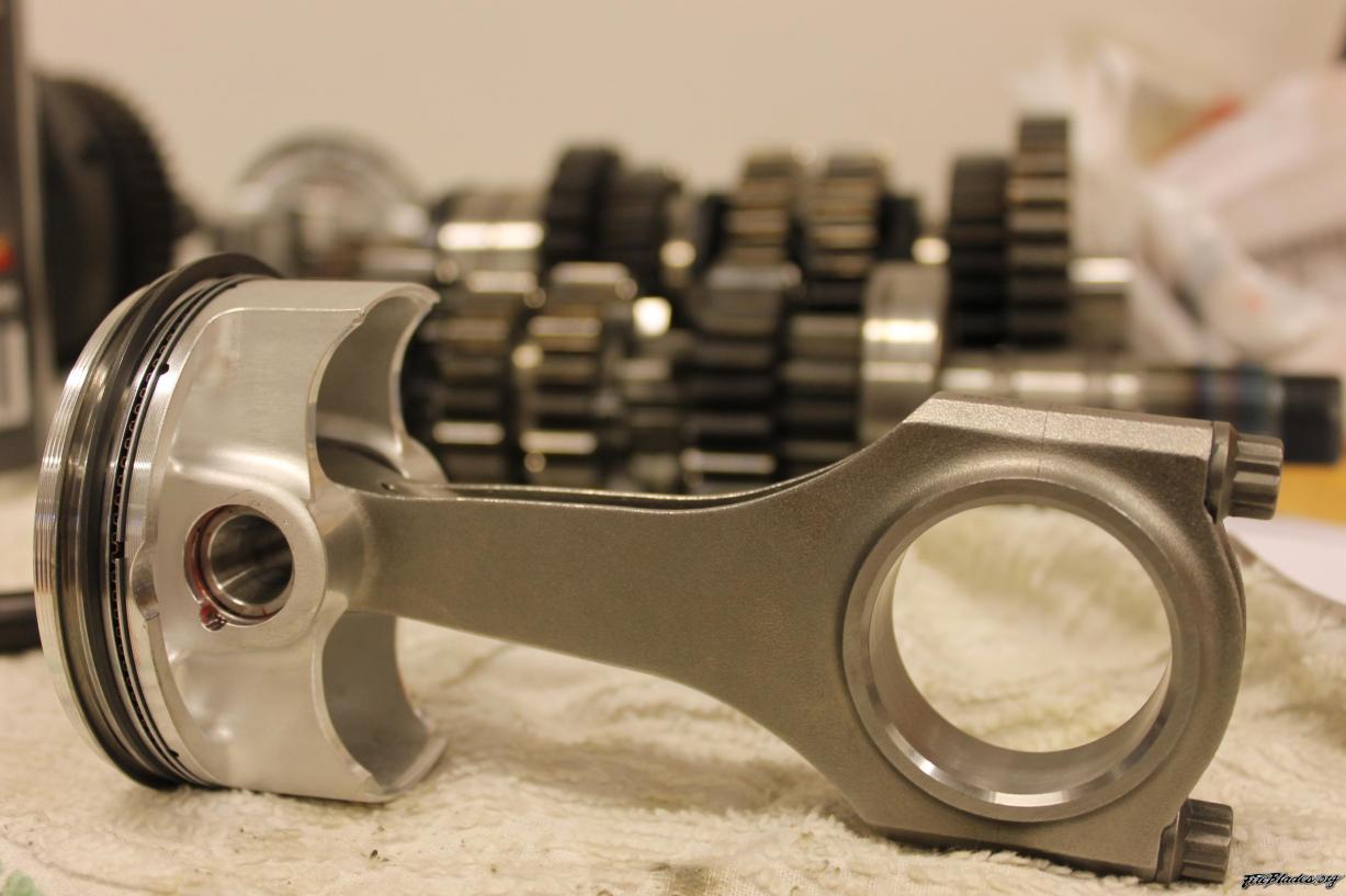

Thanks again! Was looking inside the motor from the oil pan yesterday when cleaning it and again i thought what a shame it is to hide all of those nice shiny machined billet parts inside the motor. They looked way better on the desk The skirts have been coated after this photo but they look nice like that allso.
Attachment 24144
A few more miles and they won't be shiny anymore either (well, the domes of the pistons anyways)! Indeed, it's a shame to have to hide so much of the work that goes into it! I was thinking that to myself when I was looking at your pictures - it's a shame that unless someone really knows what they're looking at, they won't understand how good of a bike it is and how much work has gone into it (things like the Nissin calipers, Ohlins, RC8 master, etc).
That's kind of my intention. I like it looks like it has came from factory like that and everything fits together whitout any bigger attention. I looked allso at the photos and the color of the bike. Very strange color. It looks like it has been painted whit different colors at different angles. And the tank looks that it has a dent on one picture and one other picture it looks little blue and on the other totally grey. Can't really figure that color out. Wasn't my choice. I gave the painter free hands on them. But it brings out the shapes and edges of the 954 very nice thought.
