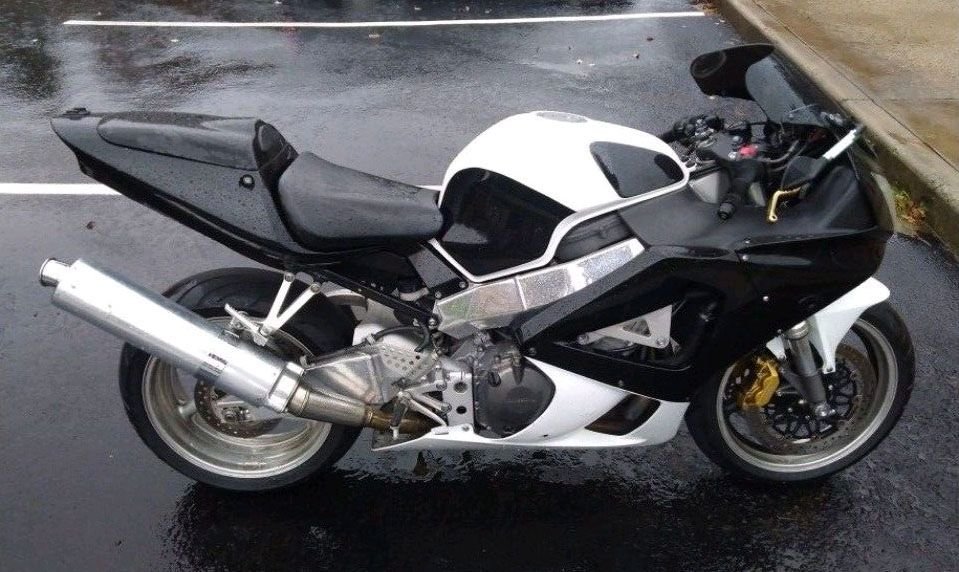

Check out this item on OfferUp. https://offerup.co/JeOsjr0sGrb
that’s the bike. I did bring up 2000 not having a fire blade, he didn’t say anything. But I’ll bring it up again if I look at it in person.
Old Jul 15, 2022 | 09:42 AM
If it is a 2000, it could be a 929. The bike in the photo's has inverted forks and the F4 didn't. The lower cowl is 2 pieces and the F4 has a single piece. But the 929 is still fuel injected, so again no jets to replace. I'd definitely be checking the VIN to see what it really is. Make sure title matches the VIN as well.
Old Jul 15, 2022 | 09:44 AM
74demon's Avatar
Posts: 12,193
Likes: 119
From: socal 949/951
looks to be a 2000 929rr, though hard to tell from the size of the pics. However, still a fuel injected model i fit is a 929. That one looks like it's been through a lot, so beware....

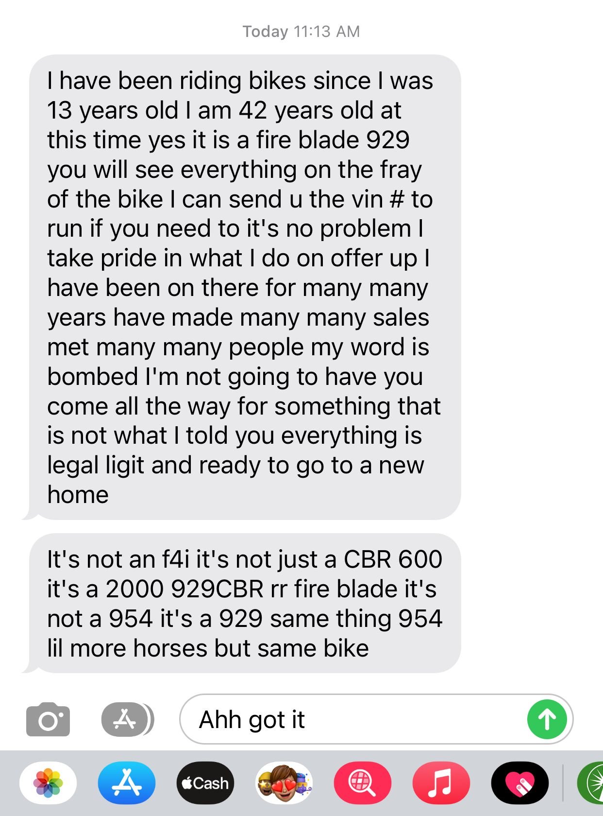

mnastydawg420's Avatar
Joined: Jul 2022
Just going to post what he said. Looks like it is a 929rr. But thanks for the advice. I’ll be sure to look at it closely

Yeah, definitely 929, not sure why he listed as 954 to begin with, seems fishy if he's been riding for 30-yrs.
Get VIN and run it. If clean, then ask if you can have PPI done. If he doesn't agree, definitely something wrong.
