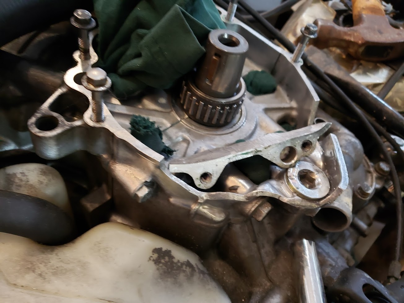

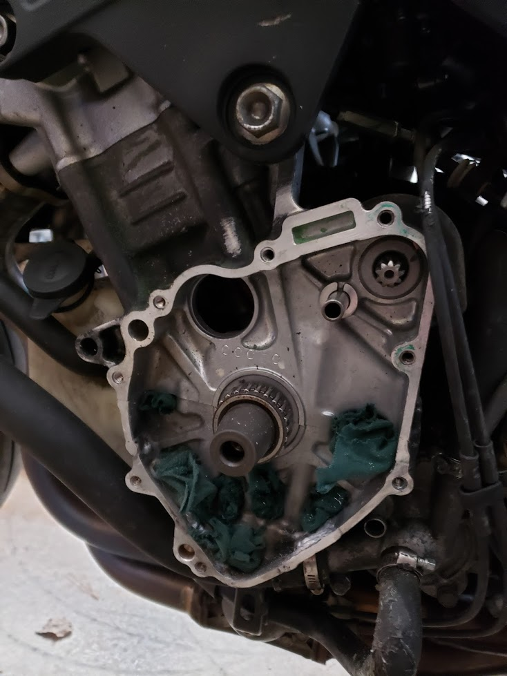

Bike has been dropped on the stator cover and has a chunk missing from the crankcase. Friend of mine is a professional welder and says he will take a look. If this is troublesome to do correctly, what are the odds that a lower crankcase can work w/ my motor? I saw somewhere that the main bearings must match from current motor to donor crankcase. Would it be easier at that point to swap a new motor in?

Will update with pictures throughout the welding process. We will need to weld about a 1" x 0.5" square where one of the threads are (where the stator cover screws into the crankcase). We will install a wide enough piece to allow us to tap into the newly welded section. Hopefully this is enough to keep the leaking at bay, and if not, we will likely follow up with JB Weld if appropriate.

Sounds like you're off to a good start. I will say that if the lower crankcase can't be saved, you'll probably want to replace the whole motor, since they are machined as a pair and crankshaft clearances would get weird. Plus it'd be a whole bunch of work since you'd basically be in for a whole rebuild. Not that that's a bad thing. If you went that route I'd probably recommend you buy the upper and lower, reusing pistons and other major components, while replacing rings, seals, and bearings. Then you start on a fresh block, but as I say, it's a lot more work

Wanted to post an update with a couple of pics of the carnage before and after welding.
Before Welding
After Welding
Used a Gasket Maker and JB Weld after the Aluminum Weld to keep it sealed. No leakage what so ever at this point and the bike is running again.
I was not the one who welded it, was done by a longtime professional welder who didn't express concern with the weld, but advised to used the Gasket Maker and JB Weld as a precautionary measure. Sand the excess aluminum weld with a Dremel tool w/ various attachments, and got the face nearly perfectly flat. Ridden in ~15 miles since and not a single oil drop or issue related to the crankcase since.
And fyi, one section (shown in the first picture) knocked a chunk off which was welded back in place. There was also another chunk missing that was completely built up with aluminum.
