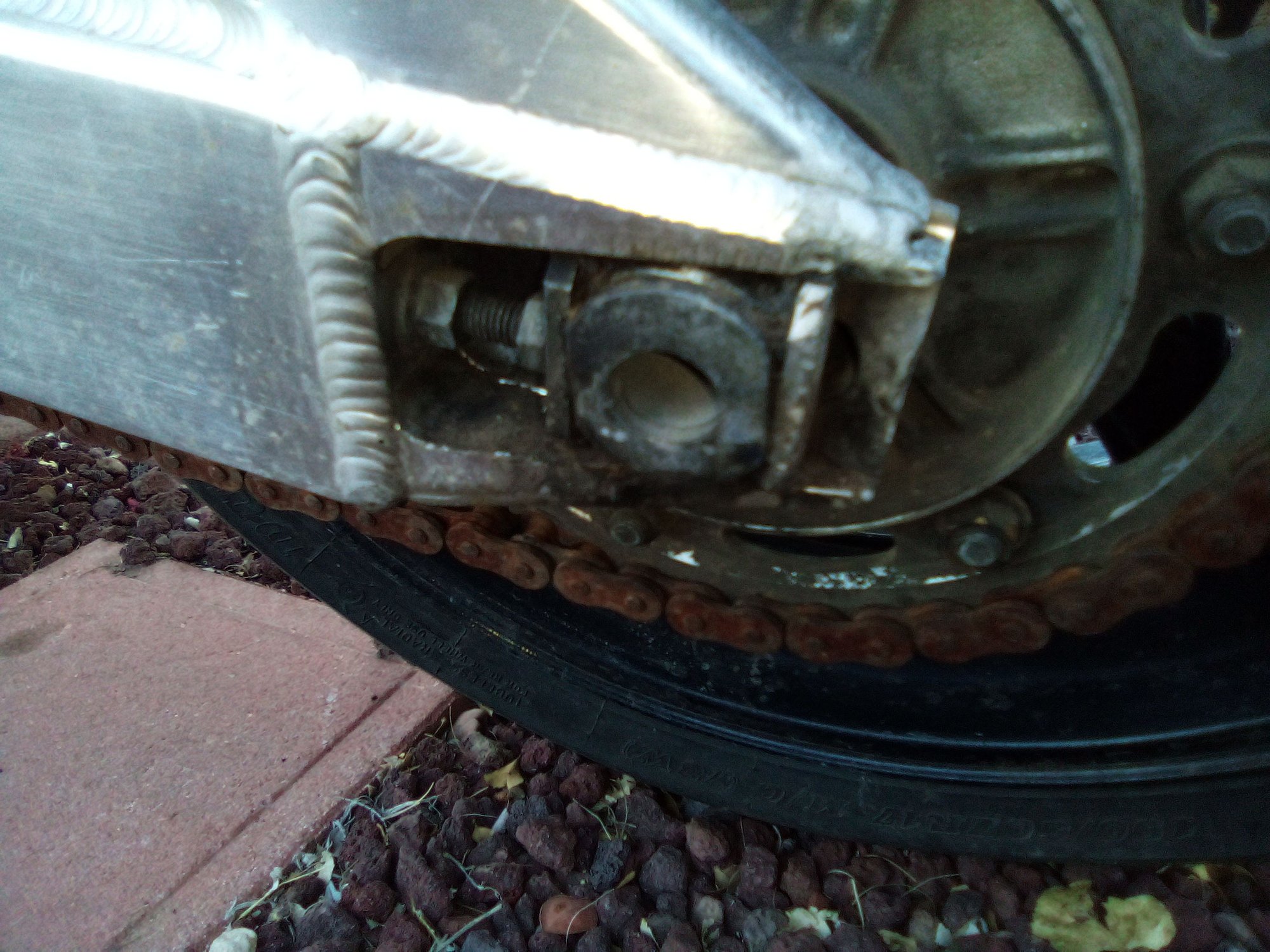

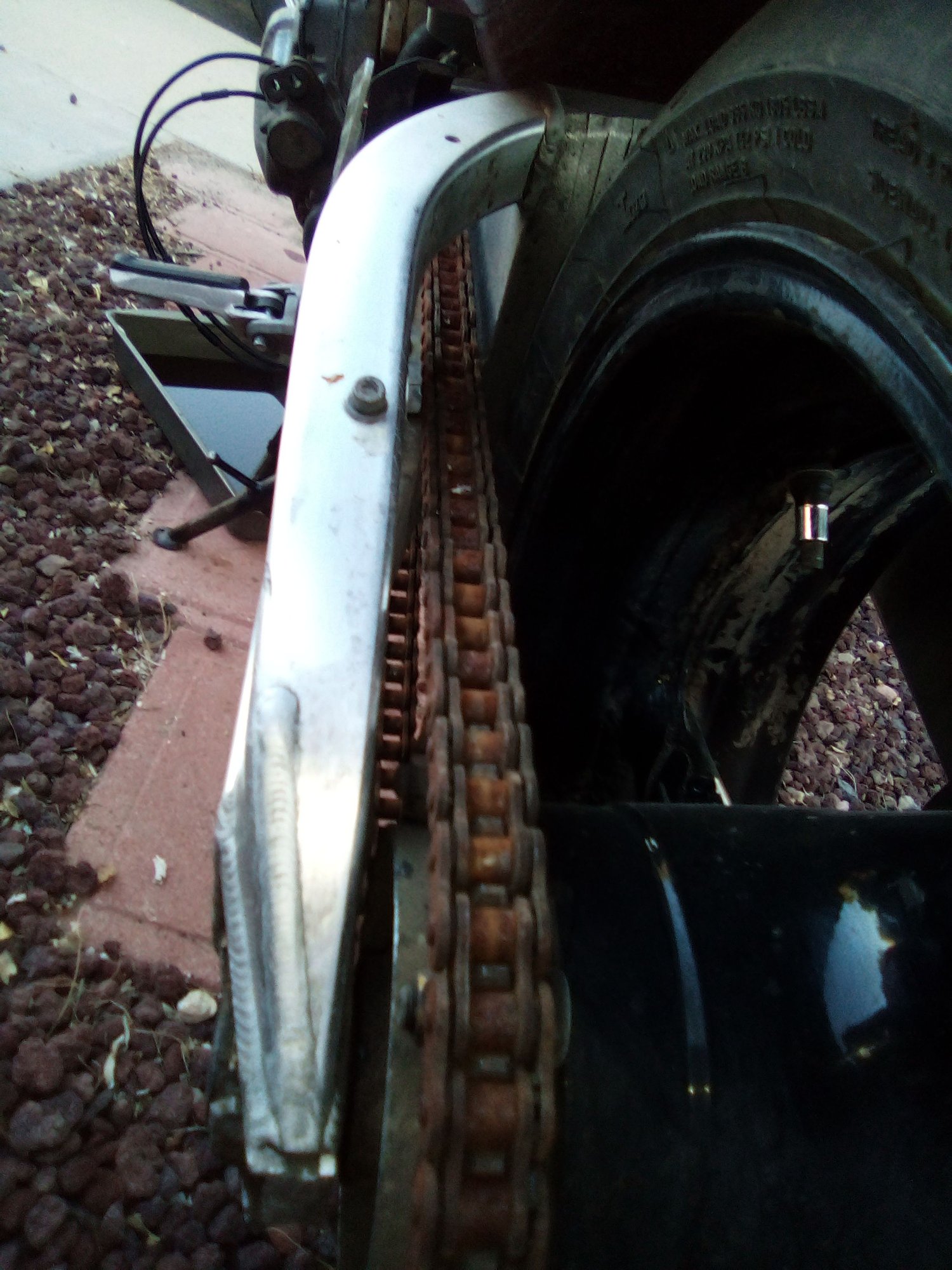

replaced rusty chain, tires are still rubber and will need to be replaced but ok for now

the first turn I tried to make,swear to god it was like a baby learning to walk. I couldn't make a right hand turn and stay in the lane to change my life! turning either way was difficult as F@^& I had to go less then 5mph to turn and I still went wide. perfectly balanced no feet down I didn't feel like I had control of the handle bars at all it was 100% lean angle. Unlike my 1st two bikes I actually felt the handle bar pushing back on this cbr.

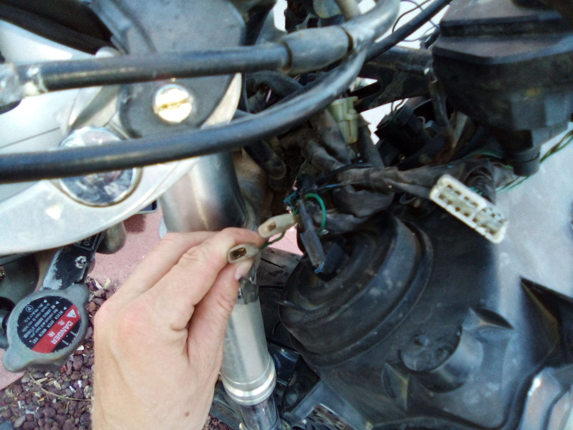

I have not started the list of wire checks and resets for a no blink MIL still operating because the pictures from the manual leave more to be desired :/

Chain replaced
easy alignments

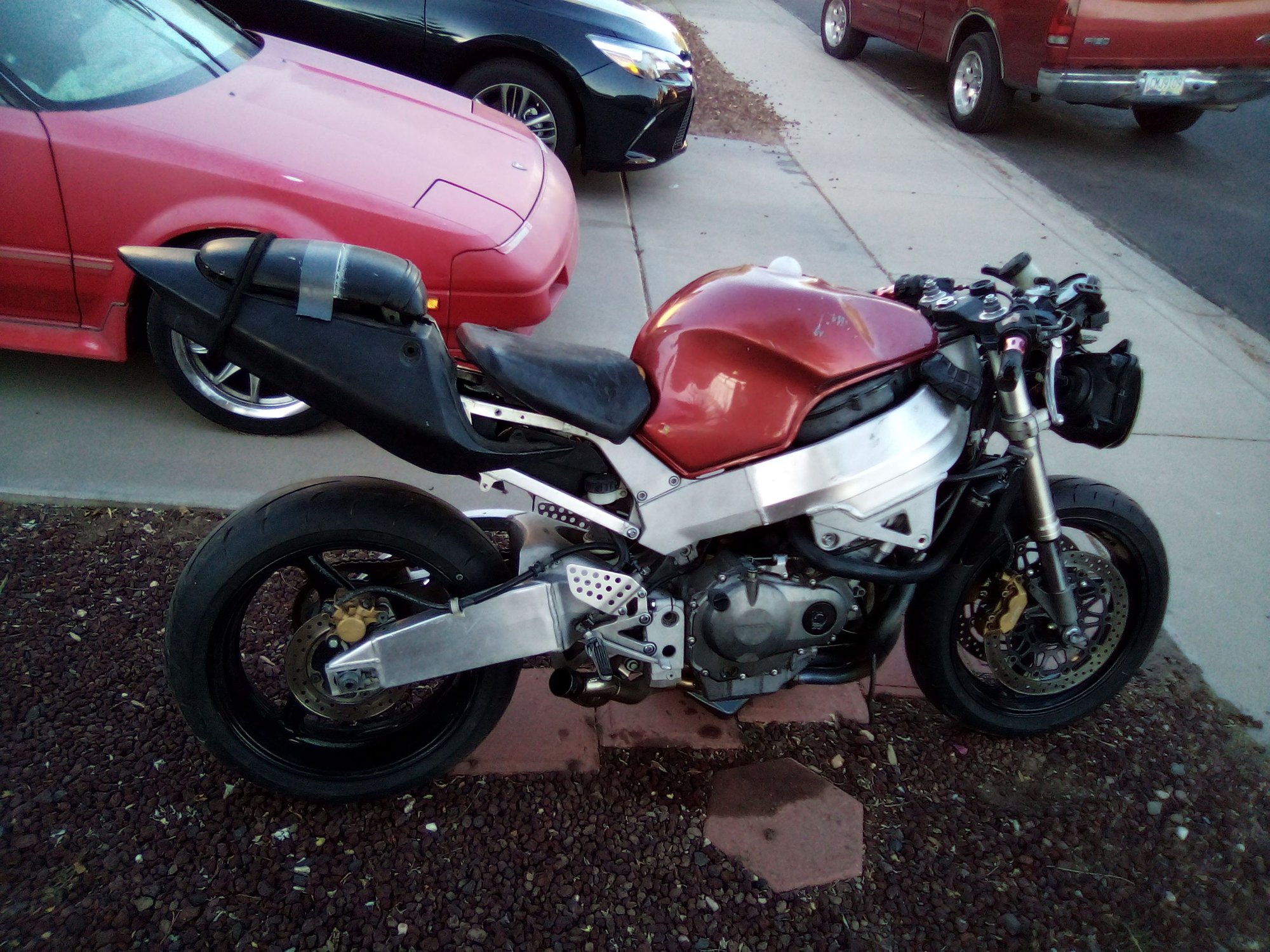

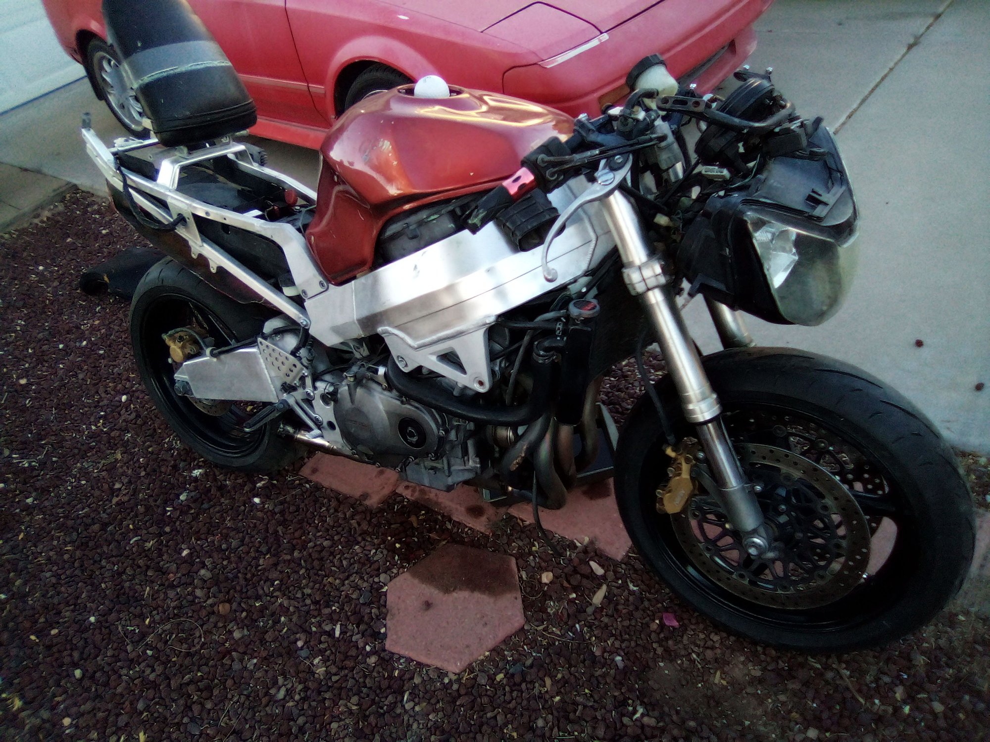

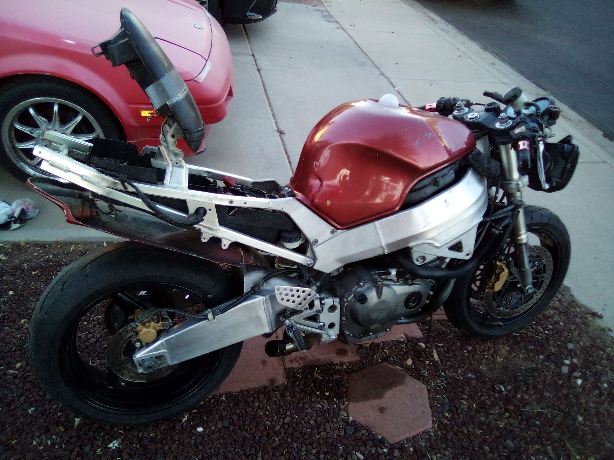

How i bought it, no turn light, no fairings, no mirrors
oil leaking from left crank case cap
clutch and brake bars bent into bull horns
loos connectors, loose dash
loose ends to the left side behind light
left side on crank case

- with the coils I would also check all the connectors of the bike. since the bike is so dirty I would not trust the connectors to be clean and reliable. On the valve cover next to the coil plugs is also the valve pulse position sensor which is quite necessary for a good running bike.
