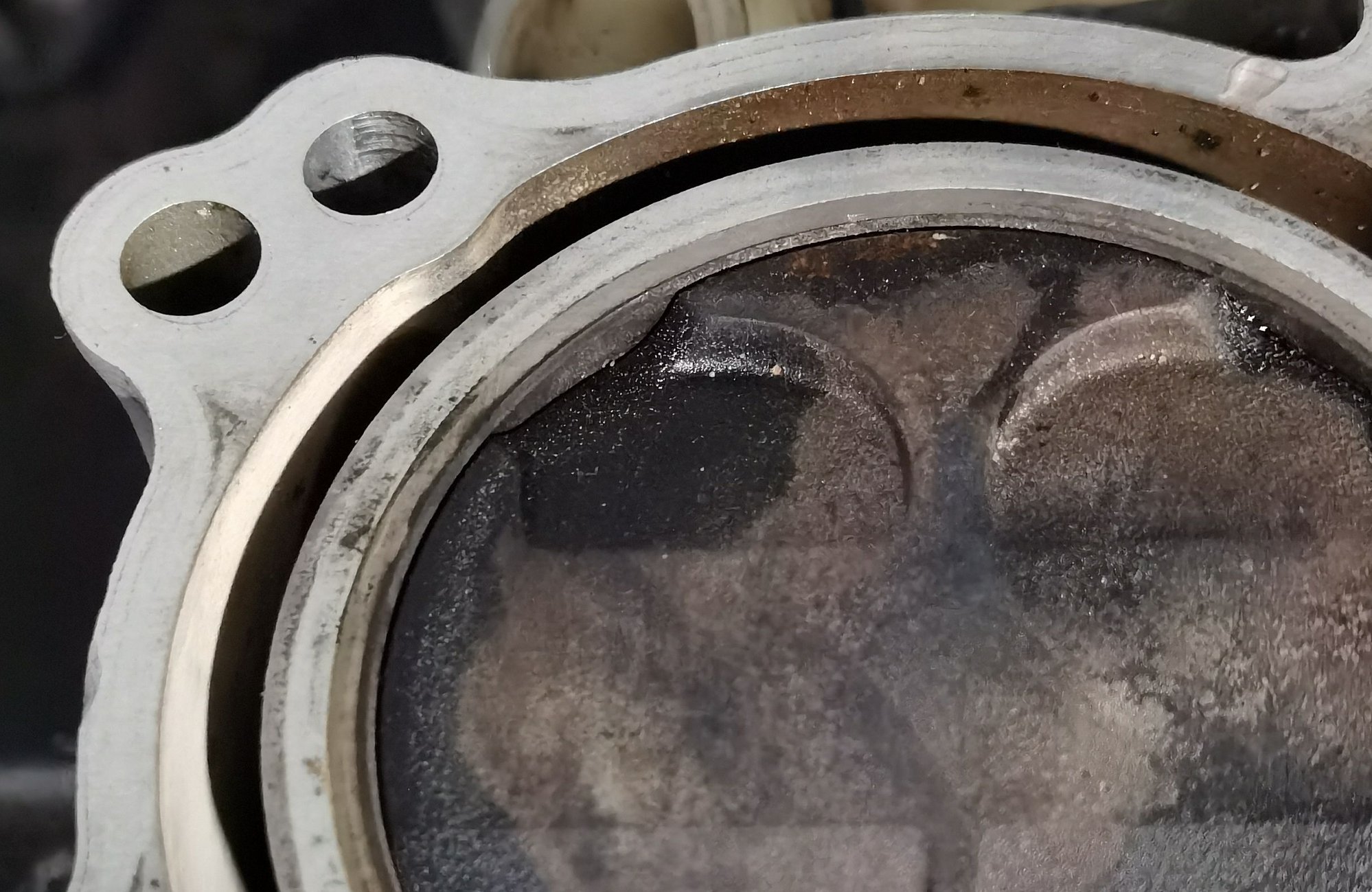

I was bored so i came to the garage to inspect head gasket, looking place where gasket blows up, and thinking maybe sleeve dropped in a little?
I can catch with fingernail just barely difference , sleeve is maybe 0.001 mm dropped, i don't think that was the problem, or is it 🤔

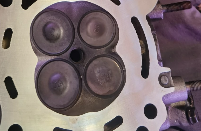

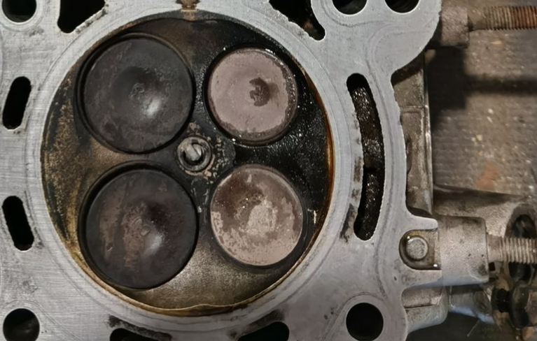

Wow, you didn't just flatten the head, you shaved it. How much did you take off? That looks to be quite a bit.
Before
After

Only looks to much, but isn't, 0.005mm max, i will check with man who did flatten it
Old Jul 5, 2022 | 06:55 AM
That is not 0.005 mm removal. The thickness of standard copy paper is about 0.10 mm or 0.004 in. The only specification I see is for Cylinder Head warpage. That is 0.10 mm across the head. I don't know how much can be removed.

Yes, you are right, 0.010mm for head warpage, there is dot for maximum head material removal, like on tyres

The specification is not 0.010 mm for warp, it is 0.10 mm. 1/10 of a mm. Not 1/100 of mm. Good to know there is an indicator of max removal though.

Yes, my mistake, i measured, with straight edge, head and it was warped about 0.02mm,so that nothing, head was just cleaned for new head gasket, at least that was the deal at shop
Old Jul 5, 2022 | 08:29 AM
Visually it looks like about 0.70 mm or 0.030 in was removed. This would only increase the compression ration from 11.3 to maybe 11.4, so not much of a change. Knowing exactly how much was removed would answer the question about compression ratio.
