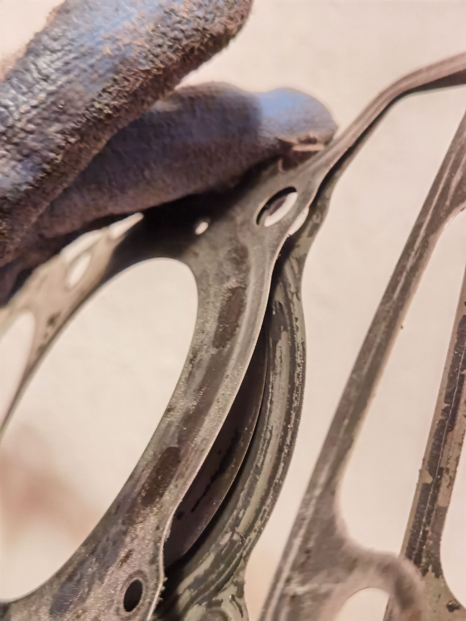

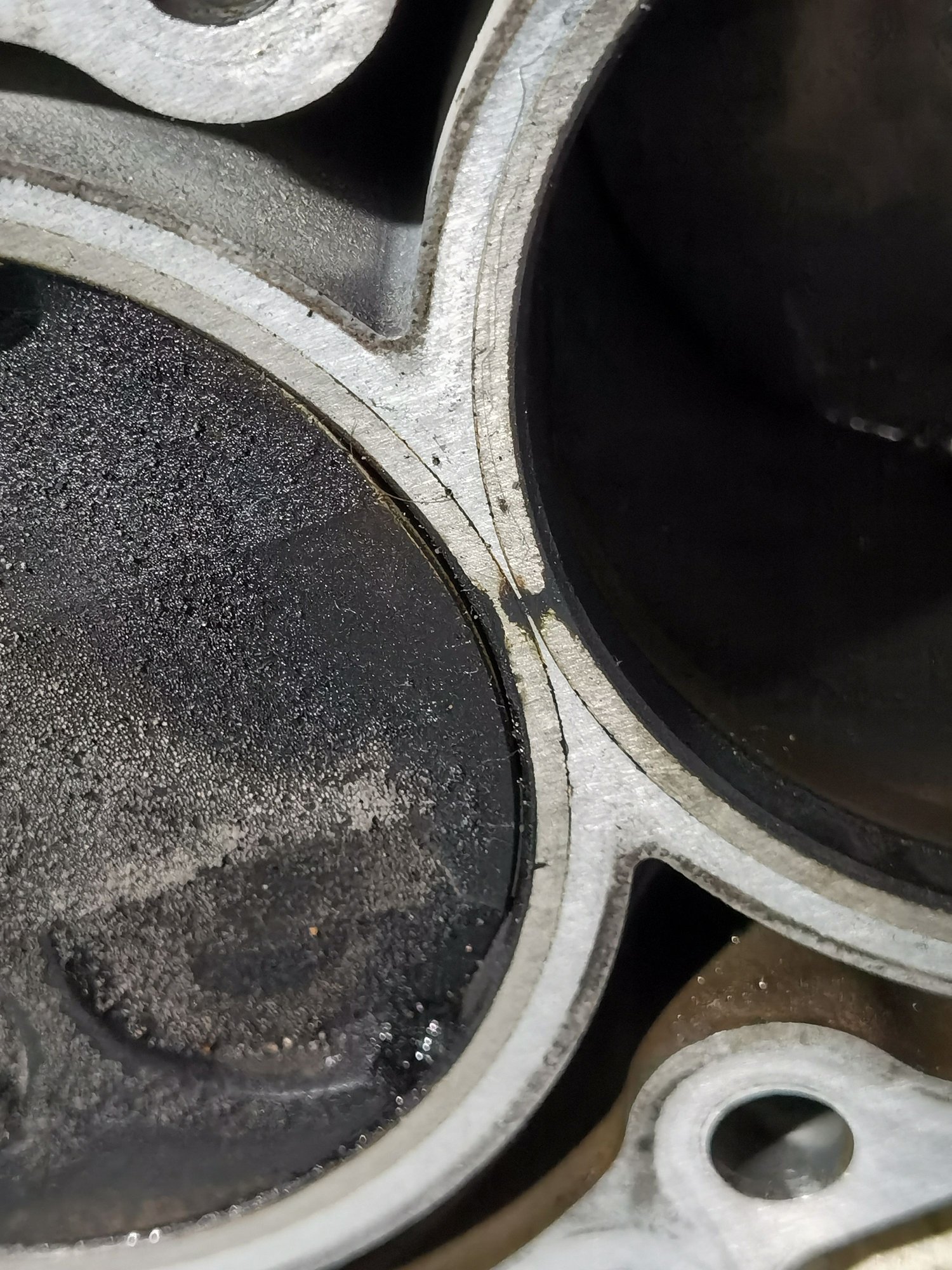

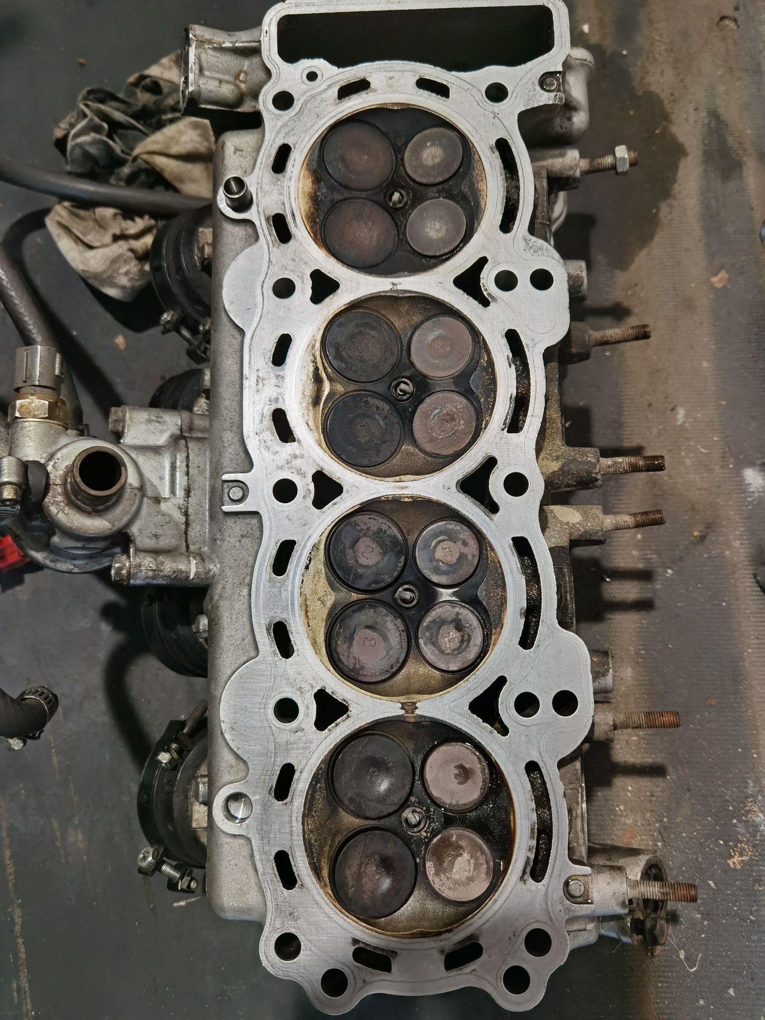

Yeap, head gasket was problem, now there's bigger question, i didn't put exhaust valve how is supposed to be, i was open not closed like supposed to be right way, and when it need to open at exact rpms, my valve get closed, so to much backed pressure maybe kill head gasket, exaust valves are.. Well see for yourself
Also, this ATHENA head gasket is made from 2 layers of metal, oem has 3, most likely ATHENA is f******g crap

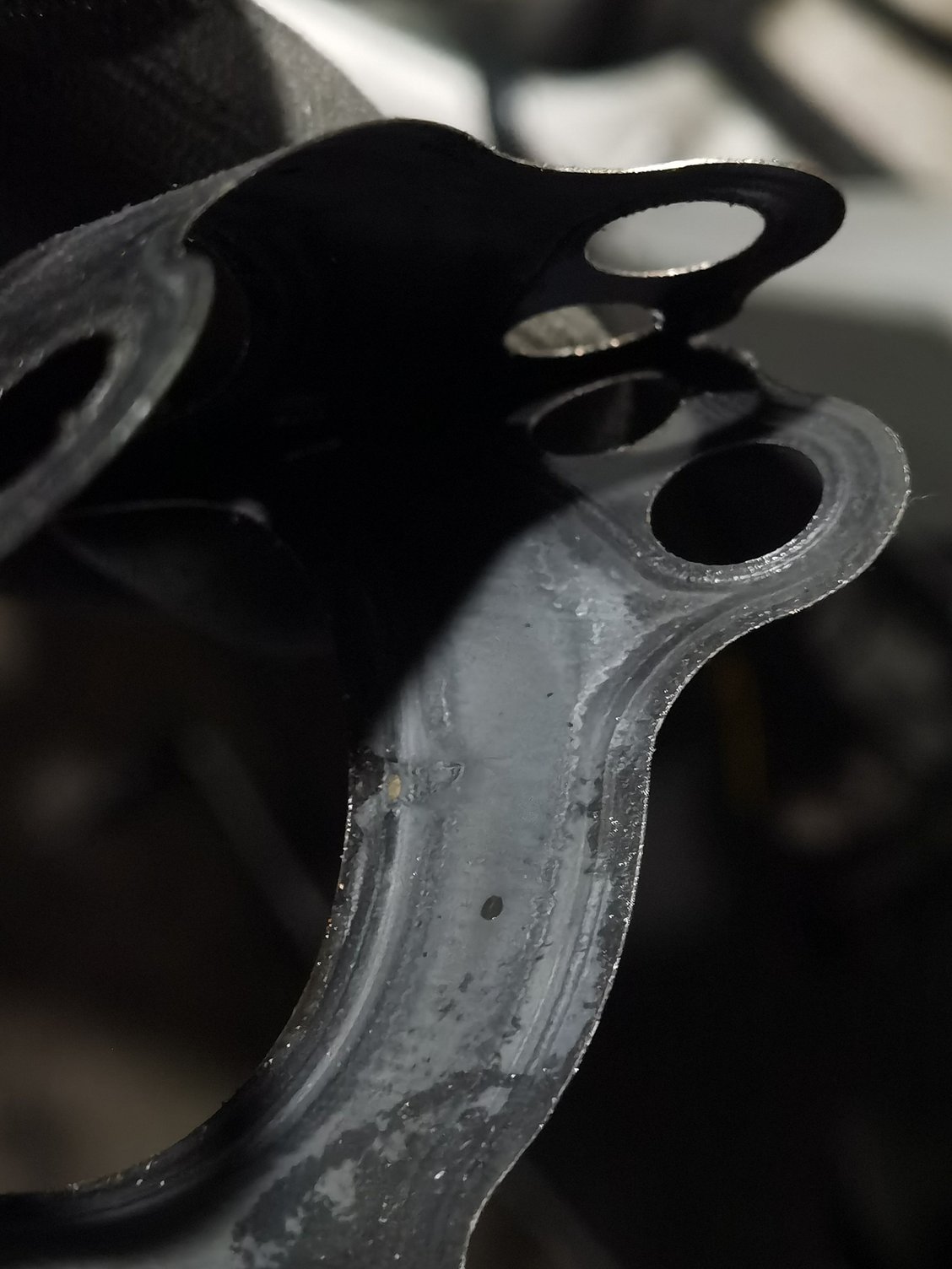

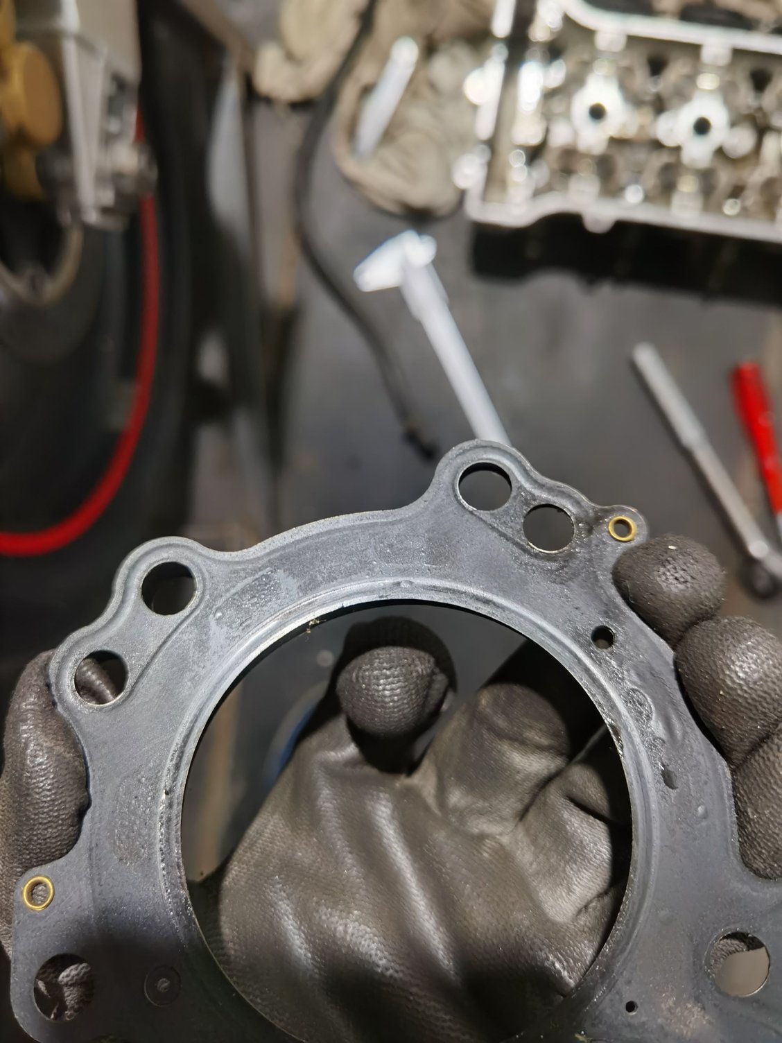

Like i said, Athena make crap head gaskets!
Blow by between layers
Almost all good from outside, almost
Factory head gasket, 3 layers,two outside and another layer between cylinders.
I ordered oem, praying that the "oem" have 3 layers also, to give this old lady another chance, man.. she pulls like mad 🙆‍♂️

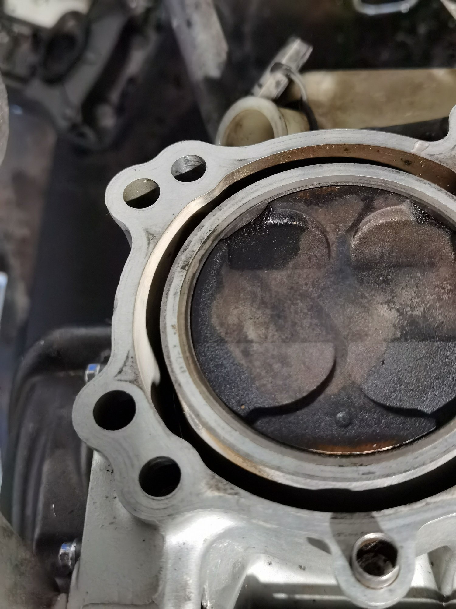

I checked head, straight like arrow
