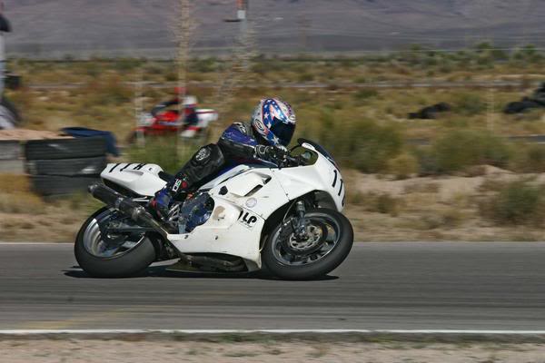

Stayed that way until 99 when I started going to the track regularly, hereit already has an 92 Gsxr 750 front end and PM wheels.

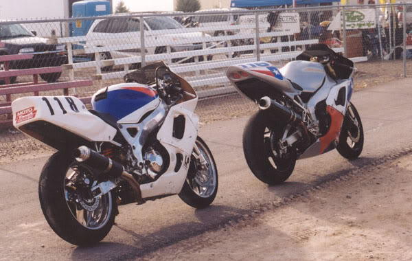

A few more years and a new set of bodywork and paint are done.

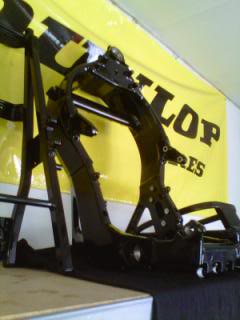

Then in 2009, it was time for the latest rebuild, it all started with a complete tear down. Powdercoated everything and all new bearings were bought.

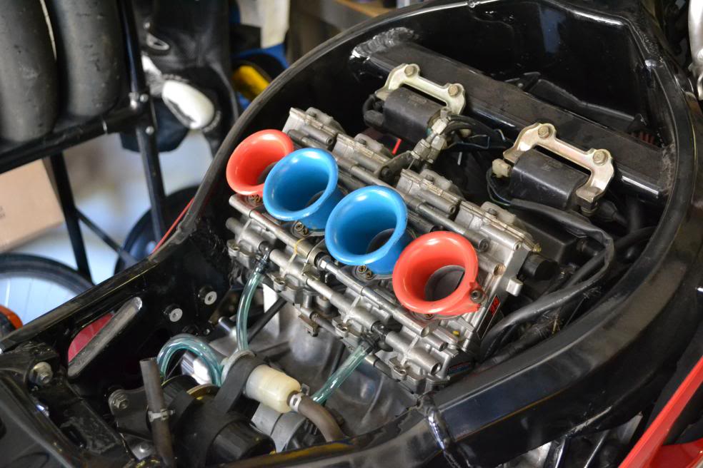

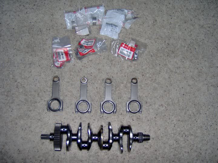

Then the new motor had to be built,
Falicon Super crank
Carillo rods
JE +2mm high comp pistons
Erion cams
R&D transmission
port, polish, 5 angle valve job
39mm Keihin FCR carbs
Vance and Hines power Pak

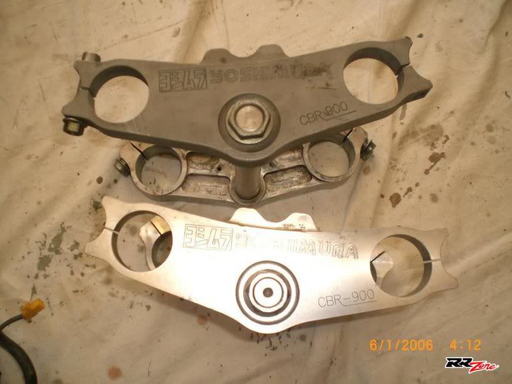

Suspension was next, I sourced some Yoshimura triple clamps,

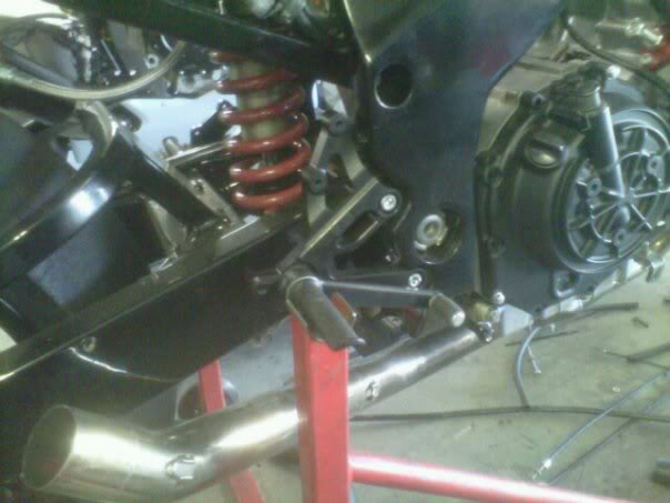

Next was suspension, Ohlins forks and a Penske triple clicker shock and Yoshimura rearsets,

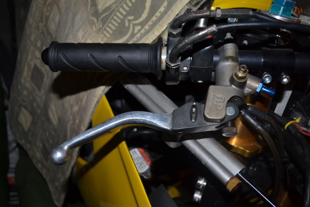

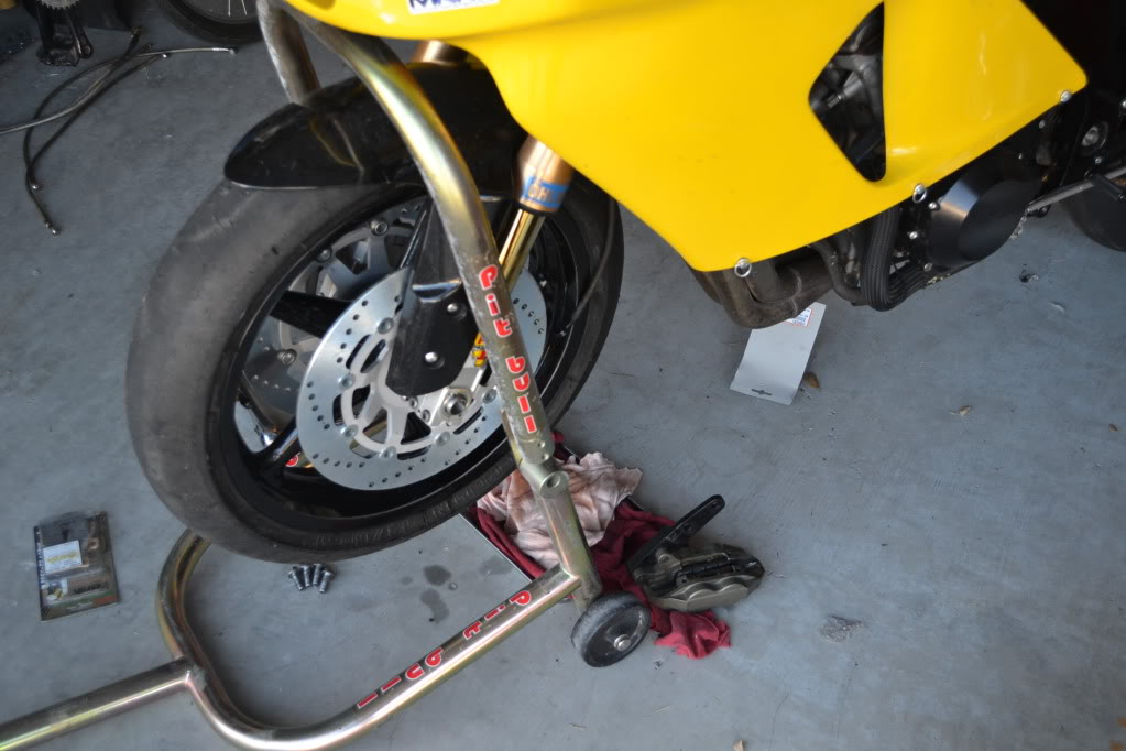

Next was brakes, I bought an AP Racing master cylinder, Brembo Monoblock calipers with Titanium pistons and EBC 310mm rotors and Vesrah RJL pads,
