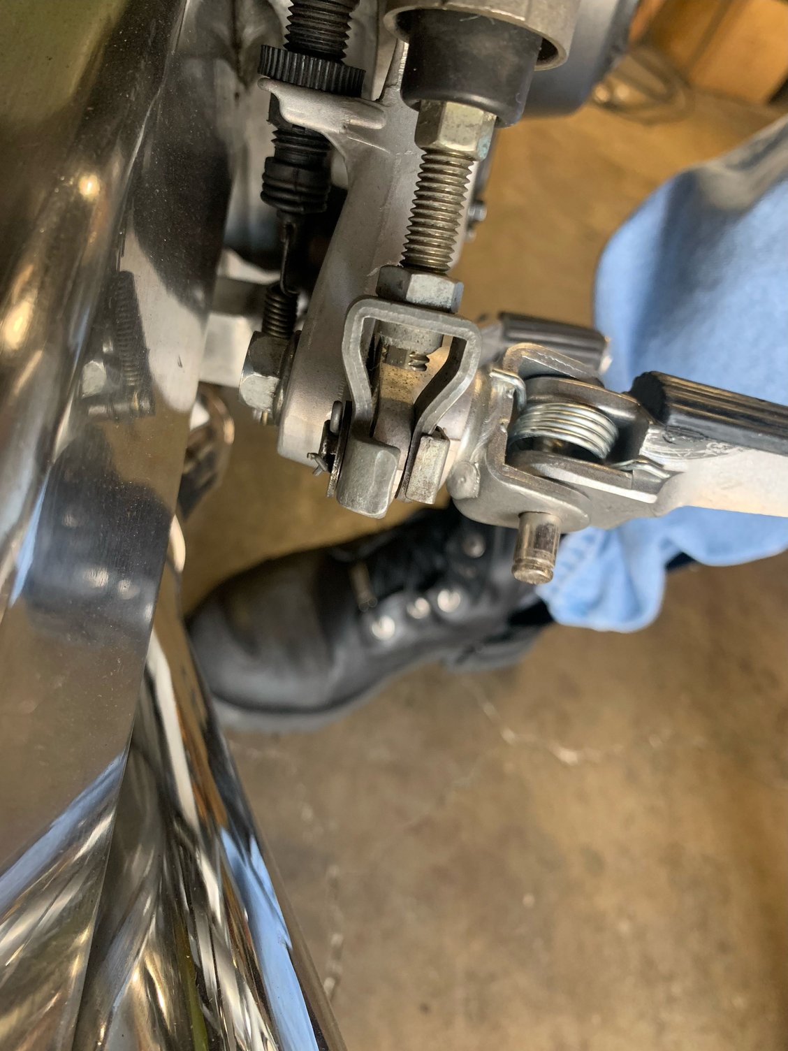

Wow! Outstanding work - I admire people like you who have the talent and patience to work so thoroughly. I'm going to try Nevr-Dull on some of my parts.
You wouldn't happen to have a close-up picture of the rear brake lever assembly would you? I'm trying to figure out exactly how the return spring is supposed to attach (mine was all apart when I got it). What I've conjured up so far doesn't look (or feel) right and parts fiche doesn't seem to help. I can usually figure this stuff out but for some reason I'm having problems in this area.
Thanks!

yes,
i can take a photo for you this afternoon if i remember.

i hope this helps.

I think it will - thanks very much. I'll get out in the garage tomorrow to double-check. Excellent quality pictures BTW!

Re: the brake pedal pics. My problem is that somebody used a brake pedal from a different bike - no wonder the parts fiche doesn't make sense! Thanks again for the pics.
