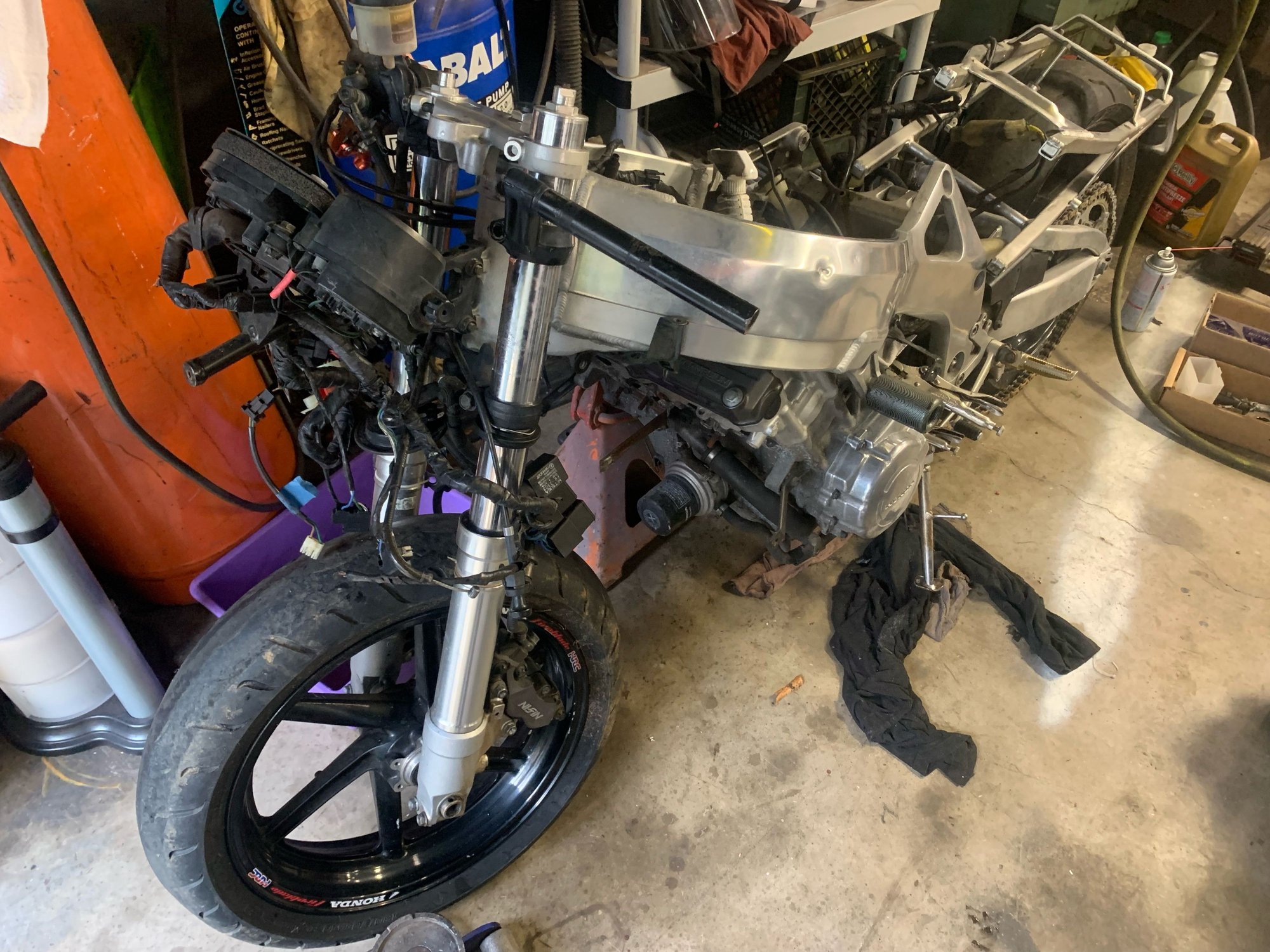

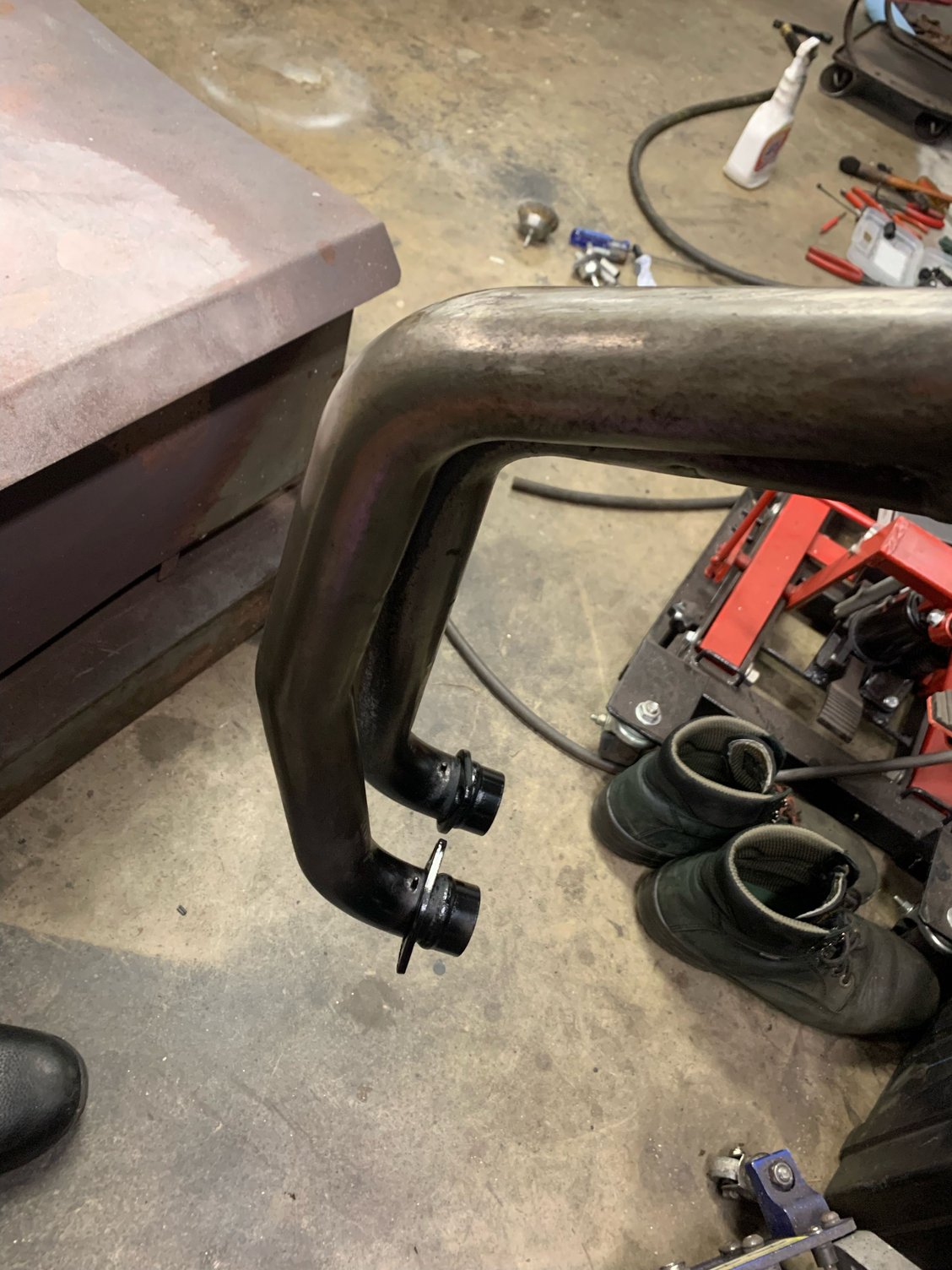

carbs cleaned, raised the needle, up 1 on pilot jet.
cleaned and painted headers.

Out of curiosity what HT paint did you use on the headers?
Old Dec 6, 2021 | 07:36 AM
  #39
kramdua's Avatar
Joined: Oct 2021
Posts: 42
From: fredericksburg, va.
i used grill paint semi gloss. i used the same paint on my trucks exhaust manifolds and still look great. i used rust reformer paint on the rusted areas first. home depot.
