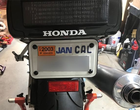

The plate sticker is pretty tell tale.
First time in 16 years it's seen the sun. It runs *amazingly*... just like I remember 16 years ago. So difficult to not just continue to roll the throttle on... rush of power.. gear whine... Glorious! I'll have to do some sole searching as to why I decided to stop riding it.
(iPhone camera doesn't do it justice. It's deep purple / light lime green / black. I tried color correcting in photoshop.)
I was very careful to put all removed hardware in zip lock bags, however, I still managed to misplace one fairing large flange bolt. Only issue I noticed so far was the rear brake seems a bit ineffective (I replace the brake line with steel braided.) Perhaps it needs bleeding again.

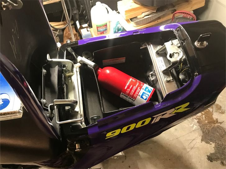

Here's one other addition I thought prudent considering the nature of the work I did to get it running:
One of the few sport bikes I know of that has enough room for a mini extinguisher. I had visions of a blown fuel line causing a fire and no ability to do anything about it except watch it burn. It actually fits really well, and it and the tool kit are still under the placarded weight for the cargo area.
