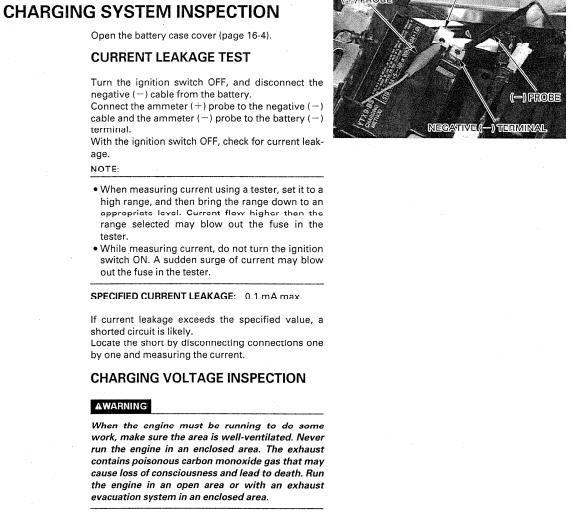

Appears you may have parasitic drain that's sucking out battery power when bike is off. You have any accessories like fog-lights, heated-gloves, USB-charger for phone/GPS?
Do this test and see what drain is when bike's off. For different model, but same procedure.

As instructed with your manual, I did the current leakage test and my ammeter read 0.7 mA which is 7 times larger than the 0.1 mA.
Alright, let's understand my cbr have a parasitic drain from somewhere in the electrical systems that I shall catch up and fix as soon.
