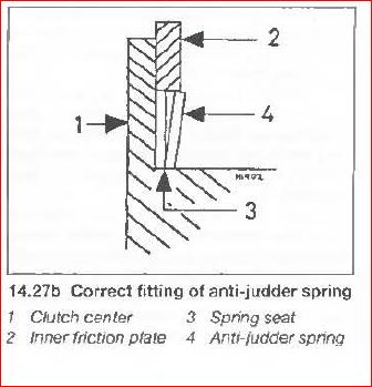

Just to make sure,are your judder seat and spring fitted like this, and does your lifter sit in this position without the clutch cable attached
Attached Thumbnails Clutch problem cbr900rr '94-judder-.jpg   Clutch problem cbr900rr '94-lifter.jpg

Re-installed the judder spring and seat and installed the lifter facing the engine but still no progress... Search a little more on this forum and found this topic:

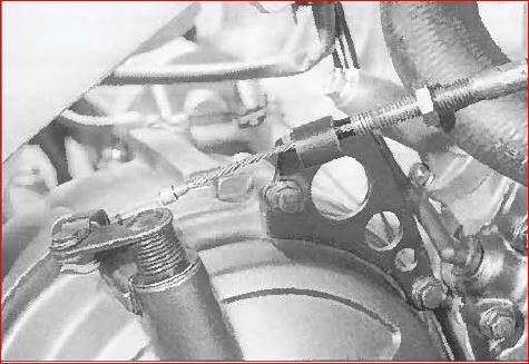

Looked at it again today and made sure the cable was good. Now when I pull the handle really hard, the lever engages a little bit but the clutch still isn't fully engaged... Could it be due to no oil (since I let it all out to take the cover off). Might it help to fill it back up and let it warm up a bit? Or can I be that it will get solved if I ride the bike for a little bit. I would rather not do this since my brakes aren't checked yet...
Below I attached a photo of the lever at the point that I feel resistance. Is that the position it should be in?

From: Lancs ,UK
This is the position without a with the cable in
