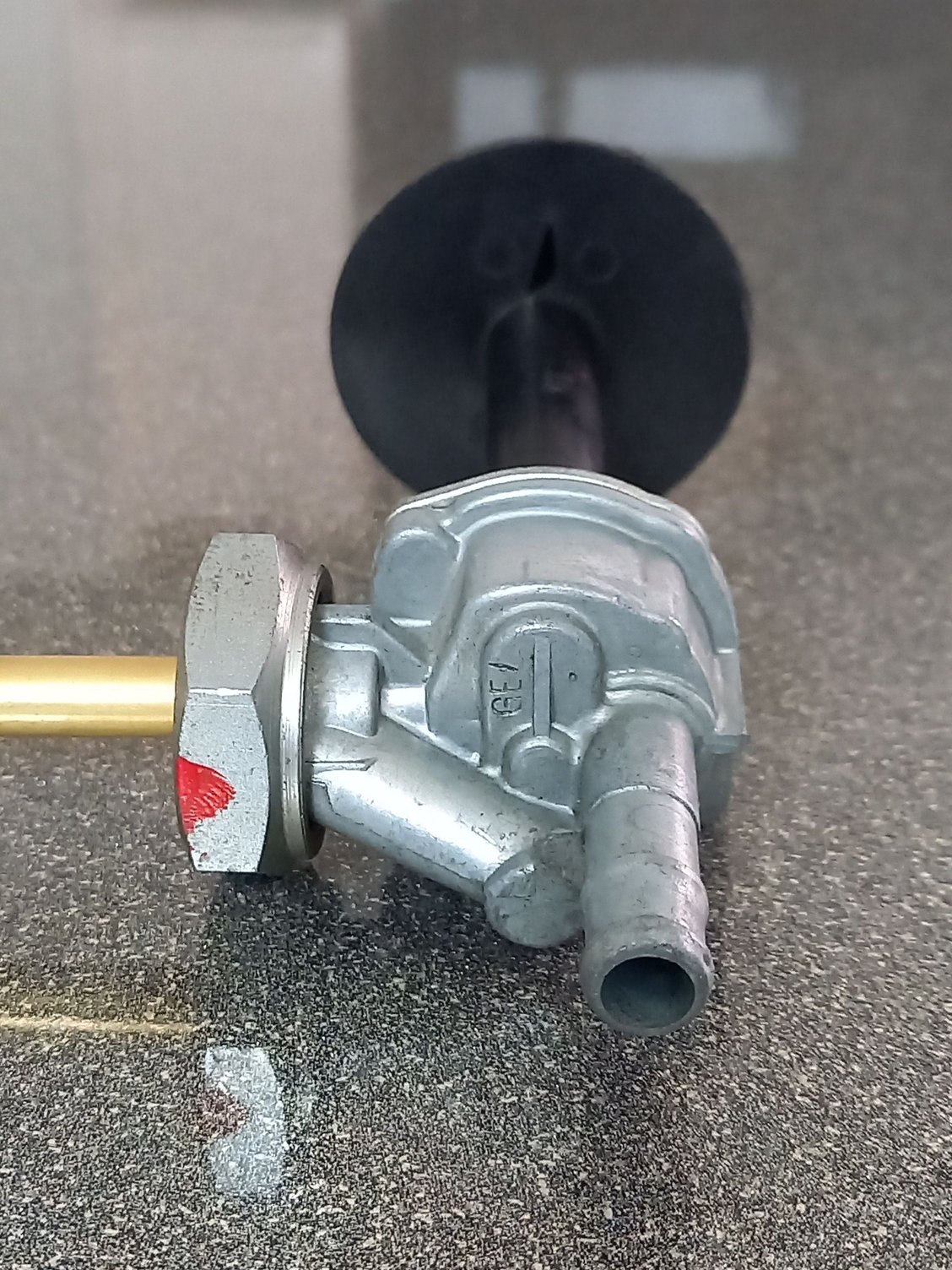

Am in the process of restoring a '92 Blade and it's nearly complete. Found a stinger in the tail though when I fitted the tank and the petcock leaked on the seam of the riveted plate.😣
so, 3 choices.......drill the rivets and see if I can repair it, buy a new one (VERY expensive!) or try to convert the bike to a later model vacuum petcock.
I'll have a go at the repair as it's useless as it is anyway but failing that, has anyone converted to a vacuum type? I was wondering if I could utilise the carb balance vacuum from No1 carb to connect to and operate the petcock vacuum from that?
Anyone who's done it/tried it out there who could offer any advice?
Couple of pics attached of my current junk petcock........

Drilled the rivets and tapped the holes, eased out the old oddly shaped O ring and reconditioned and re plumped it in warm olive oil.
Refitted it and helped it out by seating it in a thin smear of Hylomar Blue.
Screwed it together and it seals perfectly.
Job done!
