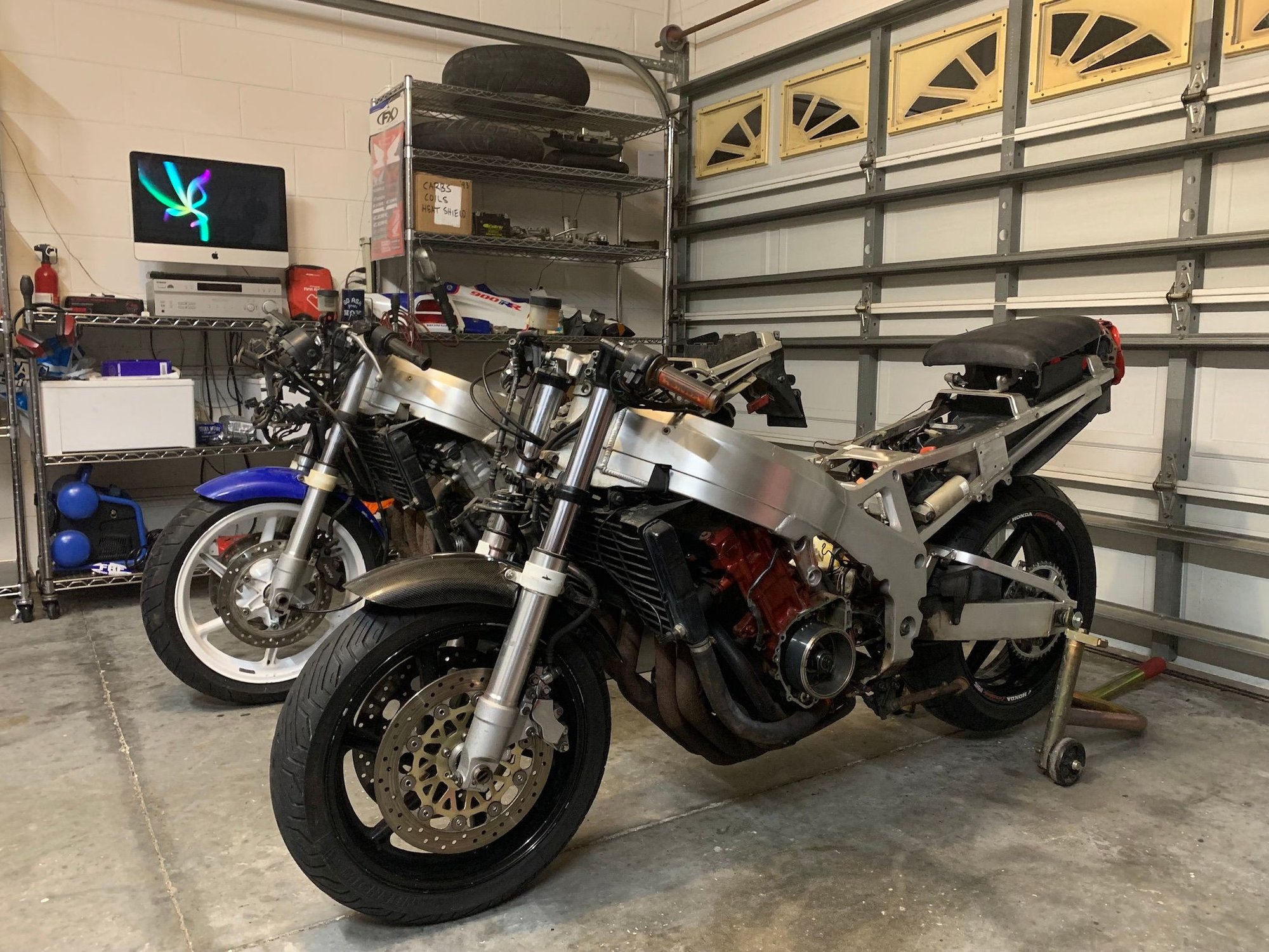

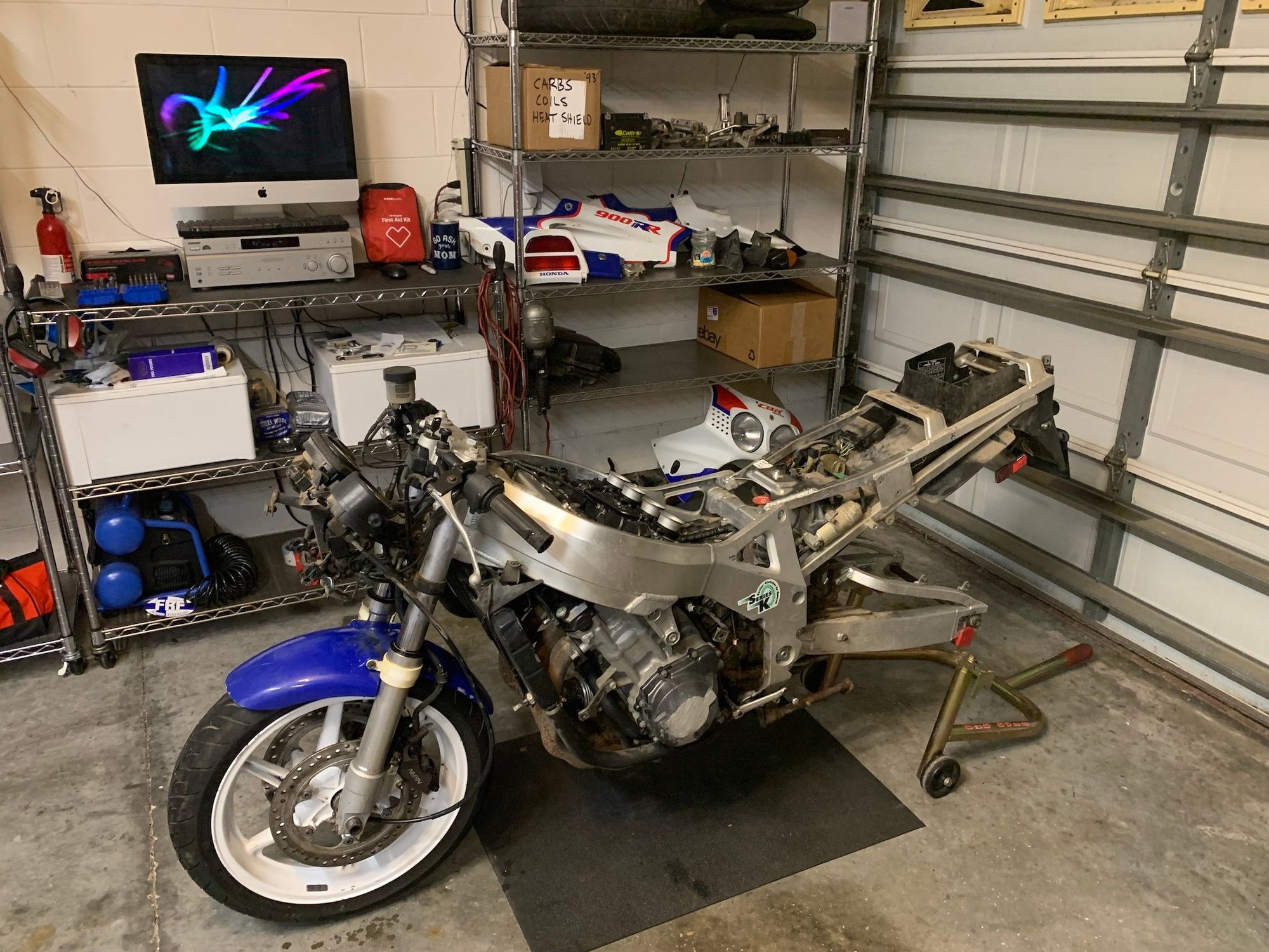

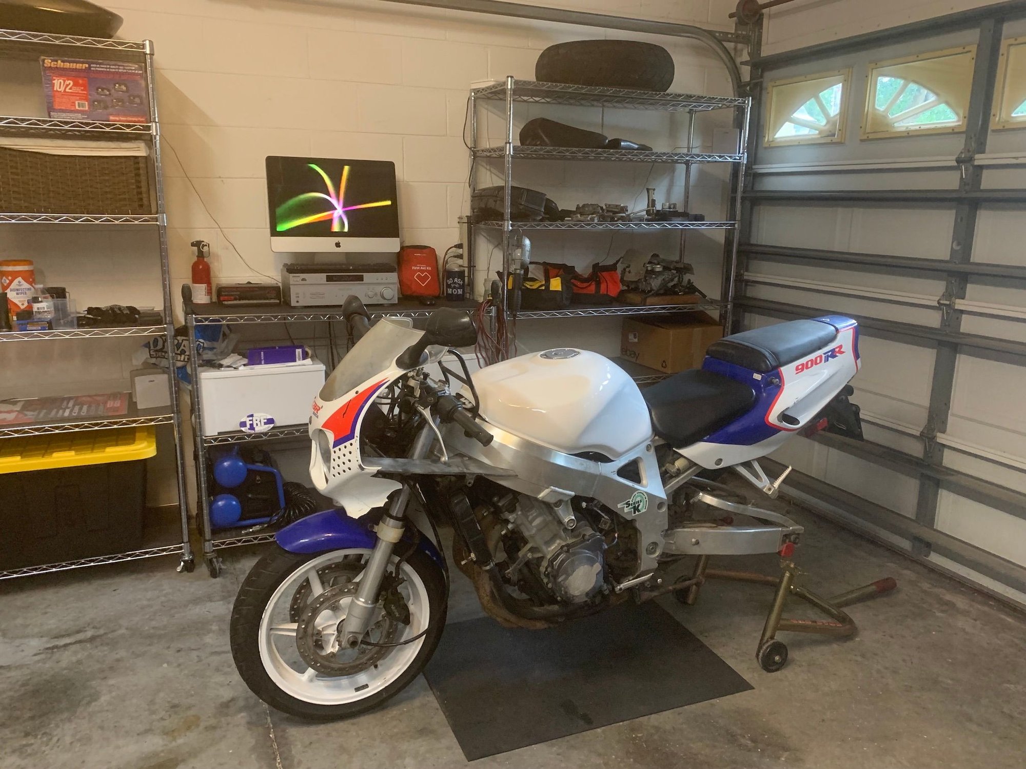

I most likely will go with the F2 front on this bike, and an F3 front on the '94 that I've decided to not sell and continue rebuilding. I'll keep the original 16" wheels in any case. Had some time to get some things organized and continue tearing the bike down.
Tearing into the bike
Parts off and semi-organized...
2 OG Fireblade projects...

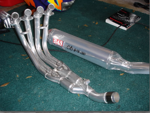

I think that ceramic coating the headers would be a nice touch from an aesthetic and functional standpoint.

Prepping for install. This was back in 2010 though.
I recall seeing your post on the coating in the past, and those look great, most likely will go with a stock look on this bike. I'm guessing that it will be at least $300 for ceramic coating by now?

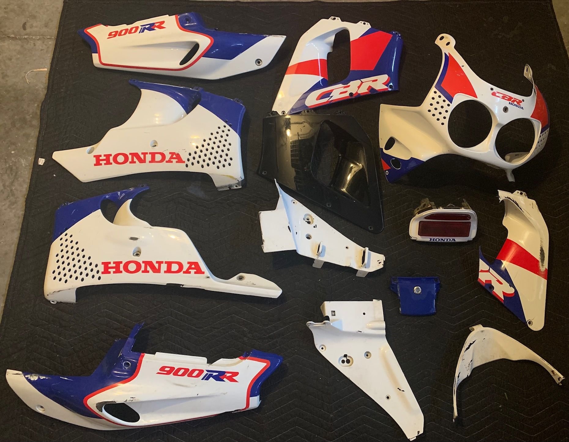

Haven't done much to this bike for a bit other than order parts and slowly take some other parts off of it, have been primarily working on my '94. Decided to wash the OEM fairings so I can trace out the stickers, working on getting a couple of sets made up. Part of me wants to just spray the replacement side cowl to match, patch up the front fairing, and ride it with the bodywork as is. Then there's another part of me that says to do it right, and go with a full repaint. Not sure who's going to win that argument.

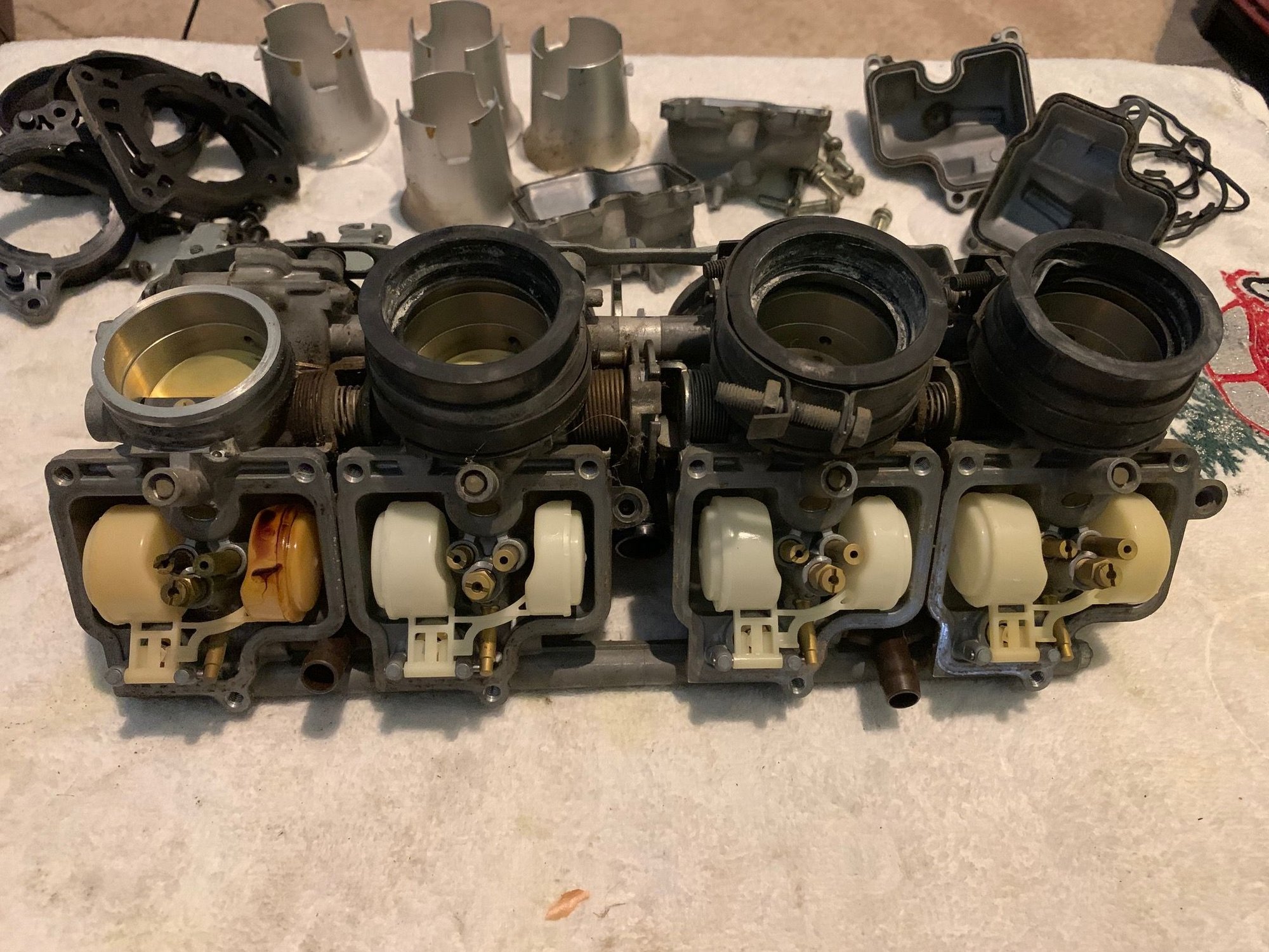

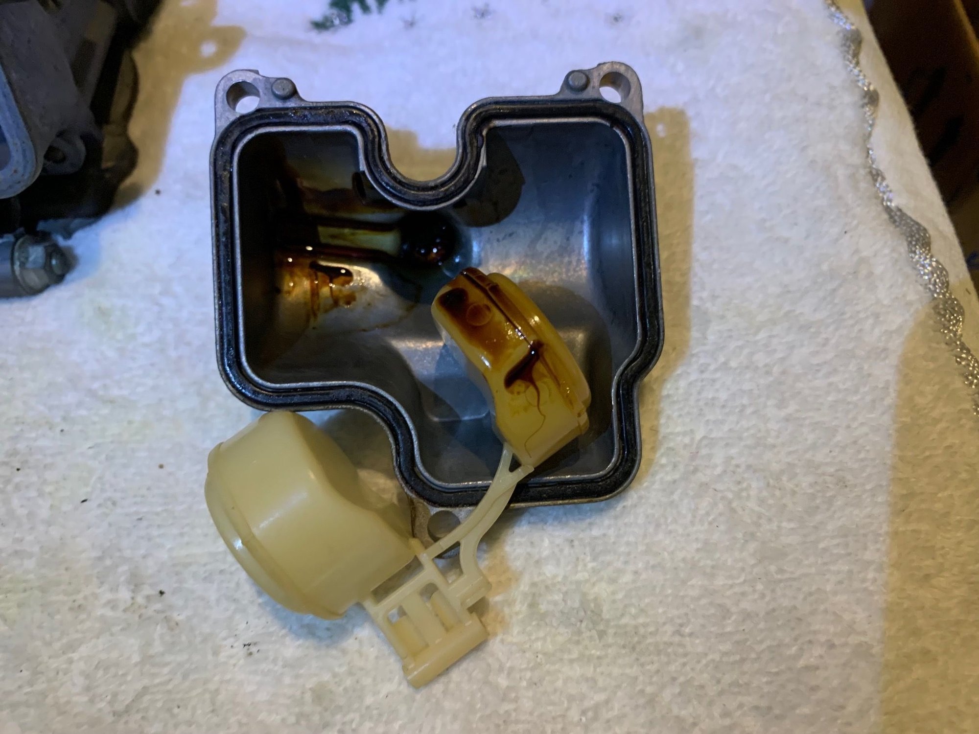

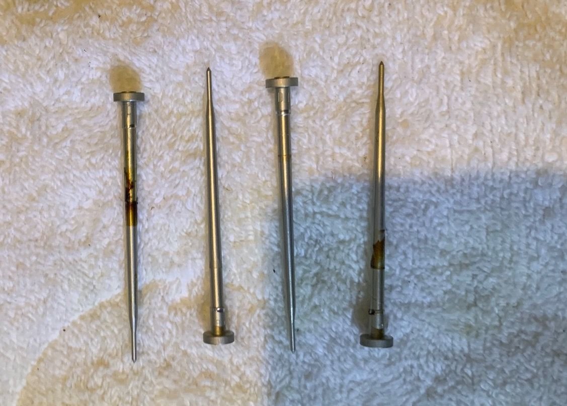

I'll go with the original paint on this bike, might and up with some rough bodywork until I sort out a decal/sticker source. Found some time to dive into the carbs, was a nice surprise to see them mostly clean.
Carb 4 had the remains of 20+ year old fuel in it
Remains of old fuel on #1 and #4 needles
