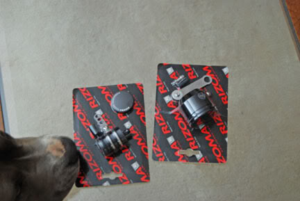

jason, i'm not removing them because i thought they didn't have a purpose. i got some new ones that blend with the bike's overall look, so i'm just going to swap them out.

^^ YEAH!!!!!!!!! I just ordered myself the same thing!!!!!!!! HAHAHAHA!
I'm pretty sure it's a safe bet to drain the fluid........do the modification and then refill the system and bleed the brakes.

I had a set of those on one of my past Duc's, they're a really nice product.
Easy way to do it is:
Pull the resivior off thetube - or the tube off the mastercylinder, depending on how you're going to install it. Have a couple of rags stuffed under there (one for the tube, one for the res).
Install the new res and connect all the lines (if the tube or Master cylinder inlet is going to be open for even a short amount of time cover it with something as you REALLY don't want to get any junk in there).
Fill the new res with you're favorite flavor of DOT 4 brake fluid. With the cap still off give the tube a couple of firm squeezes to fill it with fluid and get most of the air out.
Now just to be safe, bleed the brakes as normal from there.
