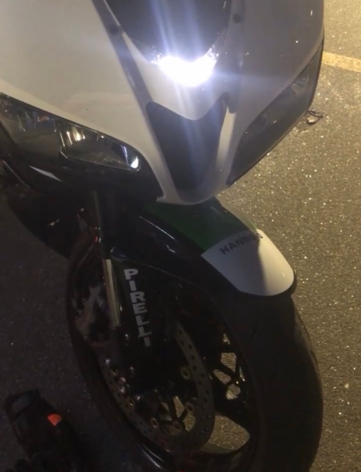

Got the bike ready for the year, some maintenance and new fairings. Everything was great for a few days but headlights stopped working today. Neither side lights up at all, every other light on the bike works fine, including the daytime running light.
is anyone knowledgeable in the sun harness and would know which connection to look for that would cause only the lights to go out?
or would fuse/relay cause this?
